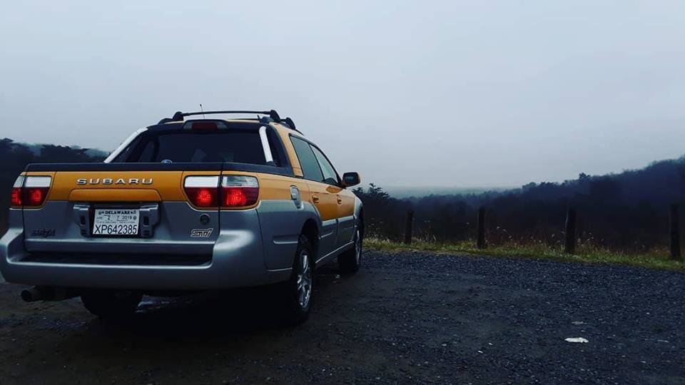

  4. Hey there everyone, Currently running over a few options. I purchased a Baja a few weeks back and I've been loving it. When I purchased it, it had been fitted with some fairly meaty offroad tires (See picture below) that are near brand new. While I certainly will gain use out of them, my hope was to have them more as a backup on the rims while having another set for my daily driving. Currently I was looking at 17" Futura tires, but the ones currently are 16". I was wondering what all would need to be done to make 17' wheels work, and if it as worth doing. The Baja also looked like it may have a lift kit? I was told it has new suspension, but I was not given details unfortunately. Anyone with a trained eye for it, see the pic below. Thanks for any help, really am loving my first Subaru!

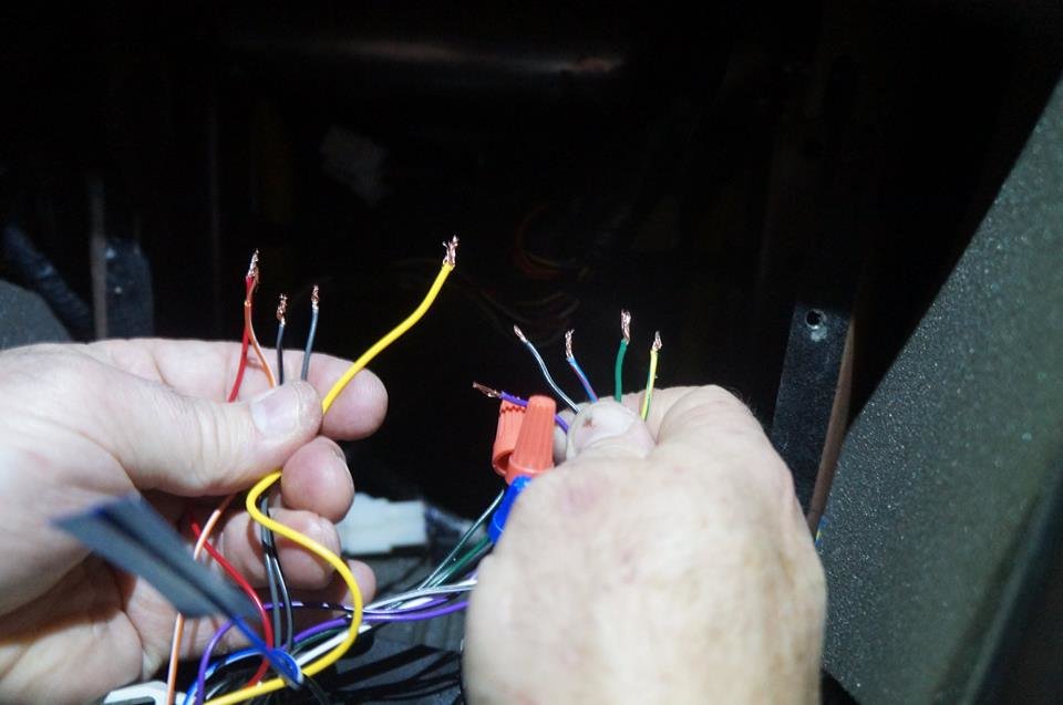

  9. Hey there everyone, New to the forum. Recently I purchased a new Pioneer Stereo to put into my '03 baja, and we've been having trouble getting it installed. After quite some time of doing wiring work as best we can to the thing, we've hit a wall and can't get power to it. we've done many different aftermarket stereo installations with no issues (even one in my Dad's '86 Brat) but we can't seem to get this one to work. We are receiving signal to the speakers: we've verified this with use of a 9v battery and some wire.We are doing this without a harness adapter and simply splicing the correct connections together (It's never been necessary to use one in the installations we've done before so we started without). I know some have said that Subarus can be more challenging as far as getting it to work in the same ways as we've gotten it to work before. We are left with the wires in the attached pictures, and have had no luck with them thus far. Any help here? I've heard of having a weak ground, could that be an issue here?
