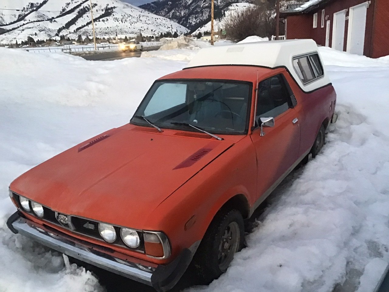

Car number 2 (living corpse) I chose this name cause it has troubles with just about everything......but still runs/drives! it’s been sitting for a good couple years and the mice have done a number to the wiring harness in the dash, but all the lights on the out side work (except the front right low) heaven knows what going on with the transmission! I drove it around a little bit and third and fourth work every once in a while.... brakes...... worthless. If you push the pedal it locks the front right caliper.... other then that none at all motor only fires on three pistons at low and upper-to high rpms, middle seems to have her firing on all four however I need to put it in the nice one, and have an idea....... Could I get away with ordering a complete engine gasket set and us the good parts from my seized motor? plz help out, also should I consider buying a carburetor rebuild kit? Or try cleaning it out? Don’t have the money for a Holland or Weber...... the carb works kinda, but could also be my fuel pump? also this is my first rodeo so any advice, feedback etc is much appreciated! -Cliel
