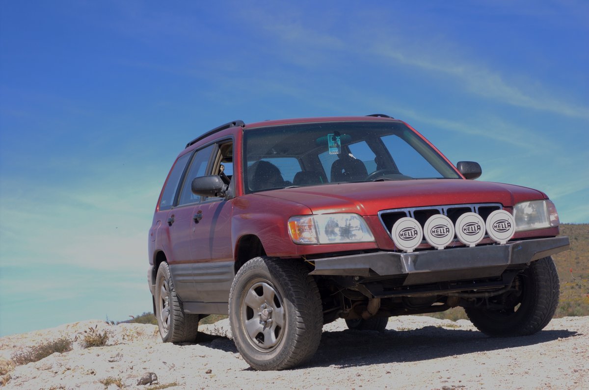

I also, pretty early on into owning it, ripped off the front bumper and began mocking up a quick sheet metal bumper. It still has a lot of work that needs to be done, and I need to finalize my hard mounts, but I will be picking up a new MIG here soon and plan on ripping apart the front sub-frame and suspension too. It will be getting a sub-frame spacer and I will be running some ~8" travel Fox's on a custom double wishbone setup I have in the works. It's in CAD right now, but I am hoping to get the sheet metal cut so I can start mocking it up soon. I just graduated and have started a full time engineering job so time is a little bit constrained.

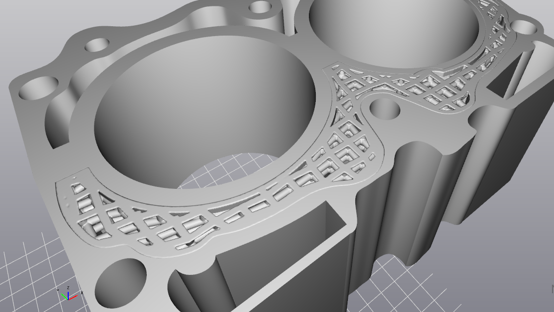

For the 22, I am looking at cutting open the deck and press fitting some custom inserts to "close" the block. They will be lattice filled, so it will be more of a uniform-semiclosed deck. This should give me the support I want for high boost while also achieving being more thermally efficient than a close deck. Block still needs to be cleaned, but I am hoping to order the pistons here soon, measure up the deck, then begin working on the inserts and running thermal simulations on them to see the final strength and thickness. After that, turbo and standalone then plop it in a Mini Cooper with a blown engine. I have always wanted a turbo all wheel drive, +250 hp toaster
