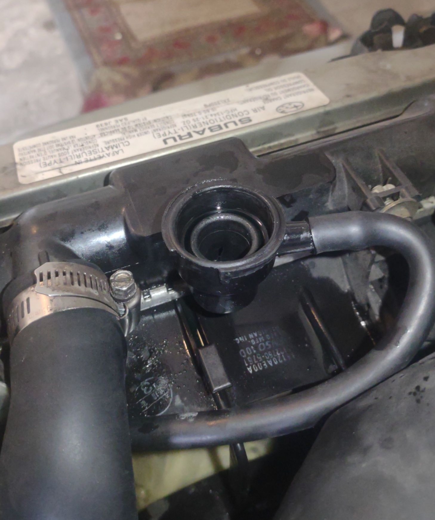

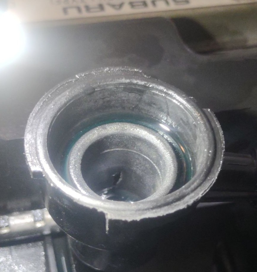

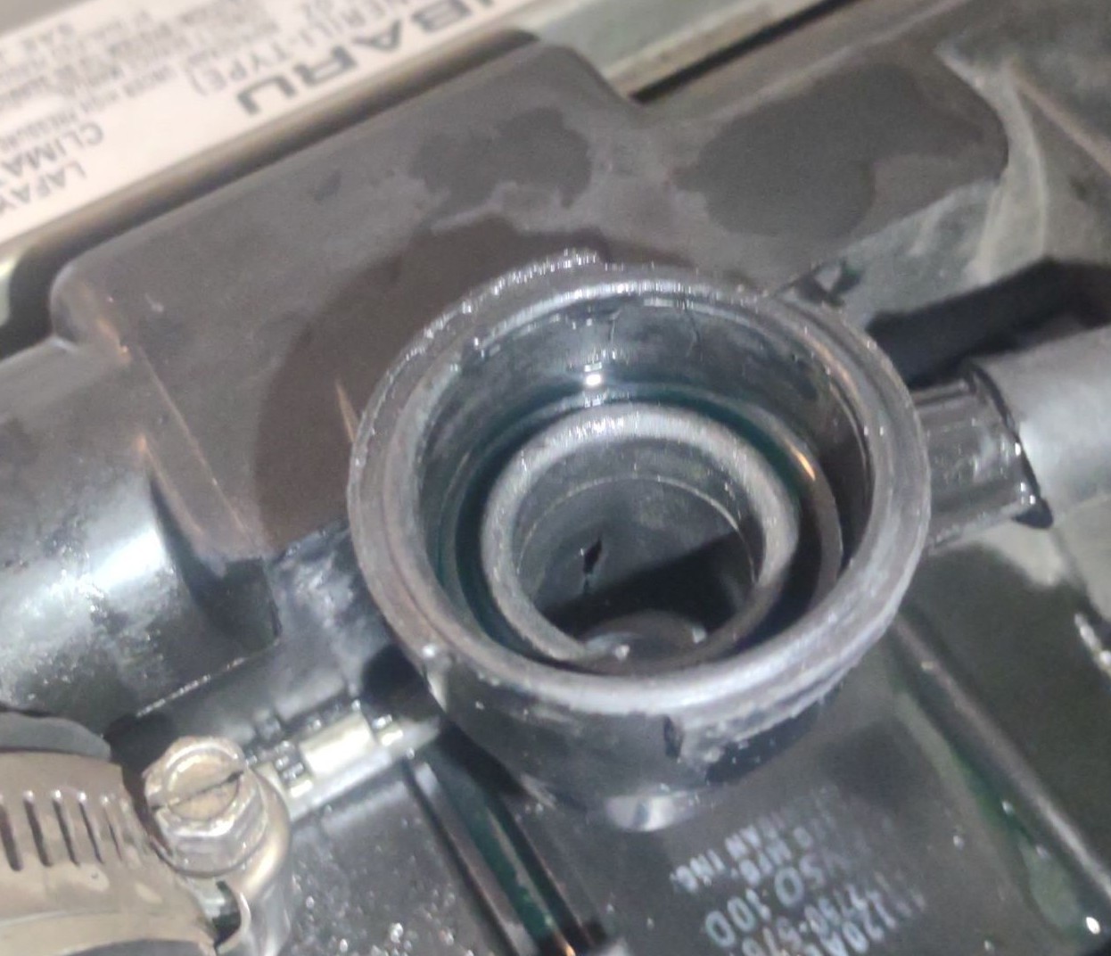

Hello all! I am the proud 2nd owner of a 2003 Outback LLBean (ez30d) which just hit 221k miles. I have had little to no issues driving the last 30k miles. This car is quite the machine! I am very impressed with it in every aspect; what a great daily driver. Also the previous owners loved the car and had lots of good maintenance logs. Unfortunately I have had mild overheating issues and have been trying to pin it down. It has been high of 80°F lately in my area. Car temperature has risen past the 9 o'clock position 2-3 times but never hit the red. I obviously get very paranoid when I see that temperature dial move... I'm going to be driving the old girl from Nevada to Pennsylvania soon and wanna be ready. Im praying it's not a head gasket but honestly don't think it is! I just replaced the thermostat and some rad hoses and started to fill with new Subaru coolant but happened to notice a small hole in the radiator fill neck area. It seems to be feeding into the radiator itself? I haven't really noticed any loss in coolant...and also did a coolant flush 5k miles ago. Any thoughts on how this hole would affect the system?? I imagine a new radiator is in my future... Thanks all!
