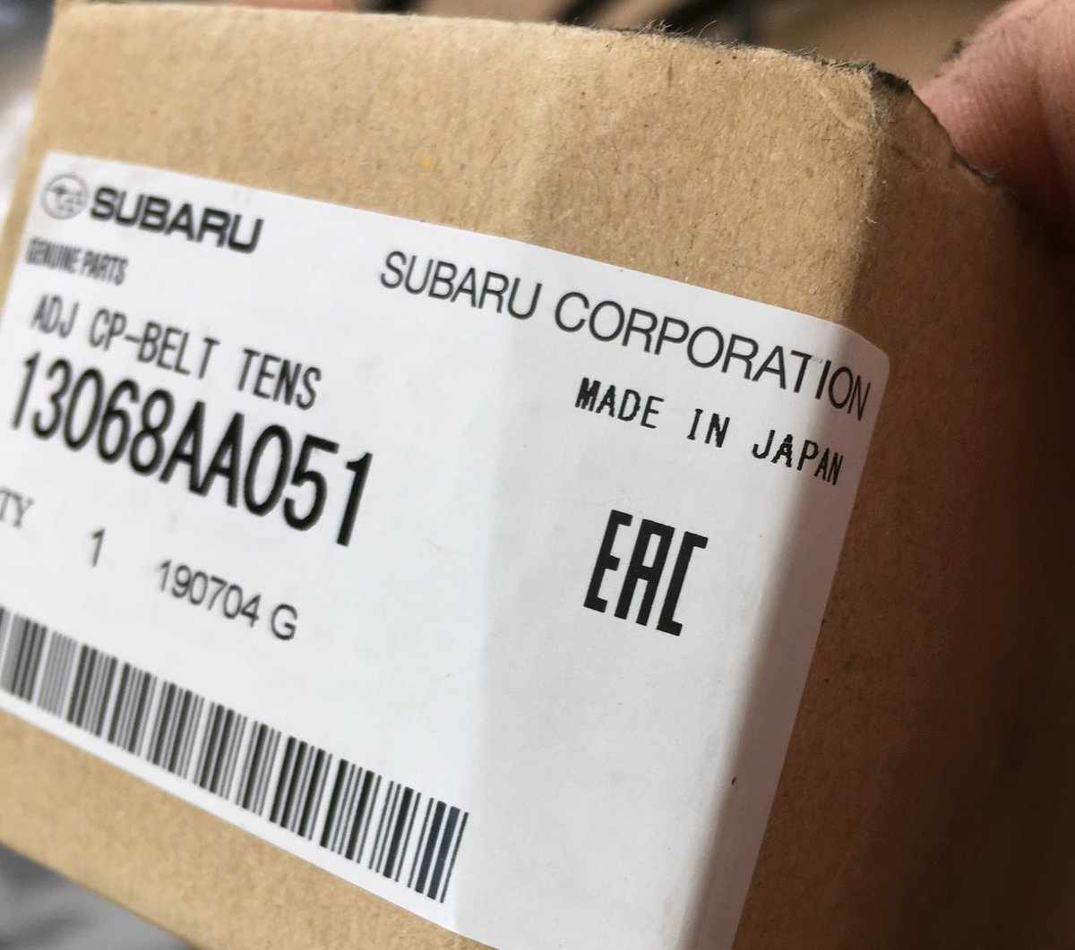

I realize why the marks are confusing me after trying to get it perfect again today. It has to do with tension on the belt. If it's loose on the bottom, for example, when everything rotates on startup the unequal tension between the top and bottom sort of equalizes things and the cams/crank positions end up where they will. I don't feel like its possible to get it 100% perfectly set unless its by luck. Got the new tensioner from Subaru directly today. It is definitely different than what came out of there. $160 with tax but I feel better about it now, compared to ordering another off-brand from the net. It's marked with the Aisin brand by the way which I've seen for sale, even at Amazon, but I don't trust anybody but the dealer for this kind of thing.

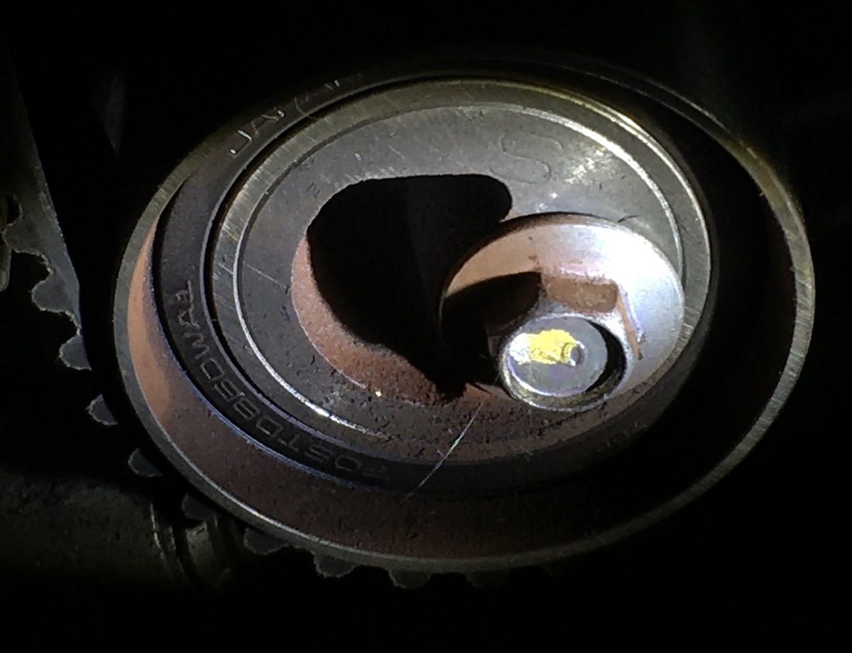

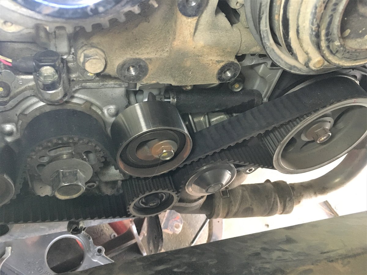

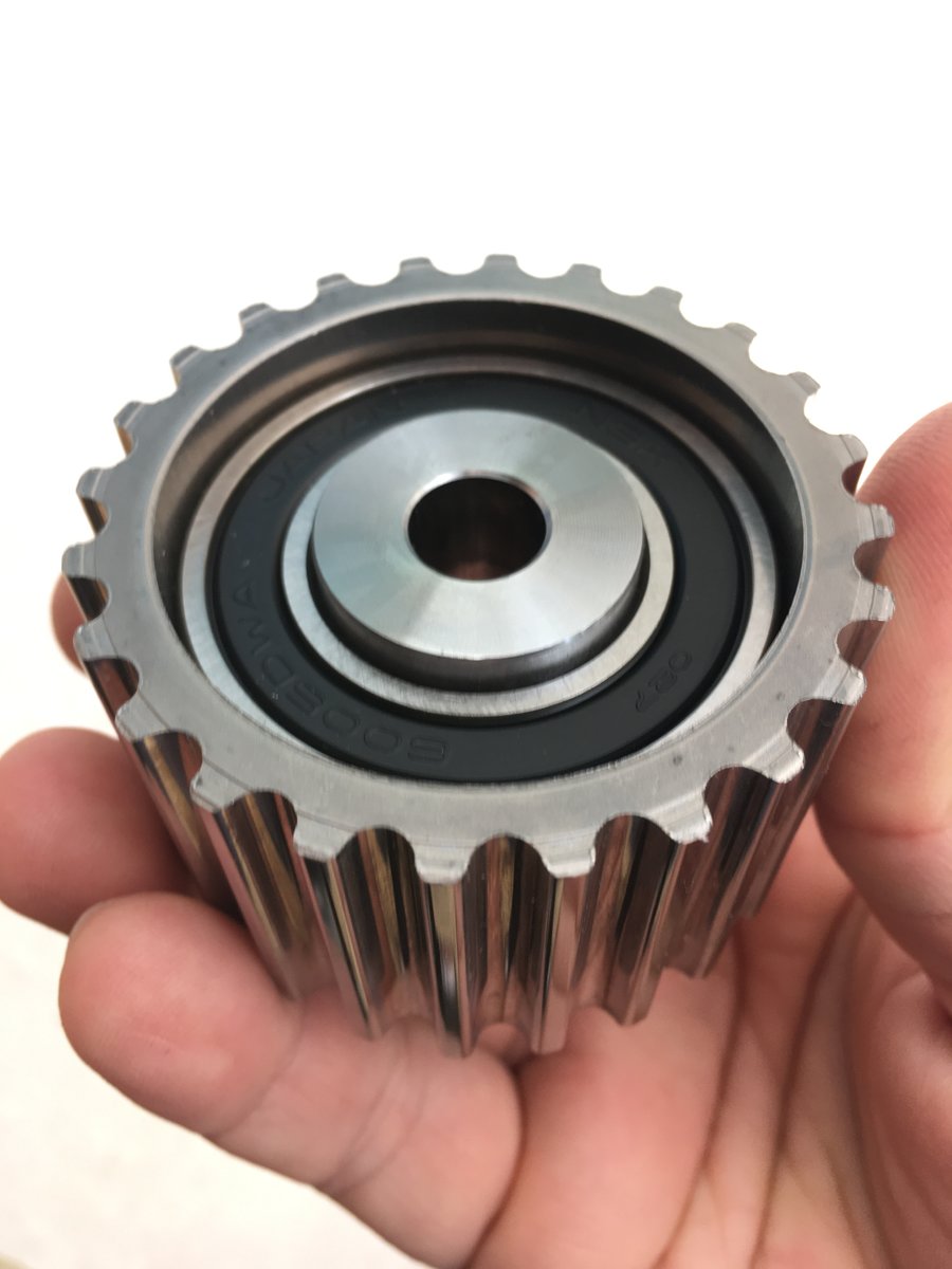

The tensioner def. does not have anything stamped on it. China for sure! I just ordered a new one today at the Subaru dealer. They said it will be a couple days and its $150!! It was a pain since he wanted a VIN. Without a VIN, he had three part numbers all for pre '94 2.2's. He got a service manager to make a solid guess so Im hoping for the best. I may get that lower toothed pulley too but I'm out of money plus all of this stuff has 10K miles on it since the full reman so I think the rest is ok. It's all NSK Japan. The belt seems perfect so I'm leaving it in. I noticed an issue with keeping things lined up today while cleaning things up. I'm confused about how to keep the timing perfect when putting the belt in. I understand that you count the teeth but exactly what tooth to start and end on is unclear when looking it in real life. I did look at the diagram but when actually doing it, I get .5 or 1 tooth either way depending on how the belt lands and then, for example, the left cam moves super easy so that will screw me up. Also, after rotating with the belt on, the right cam wheel ended up one tooth off from where it was before. It's like the tension on the belt changes how the cams line up slightly from where I had them to begin with.

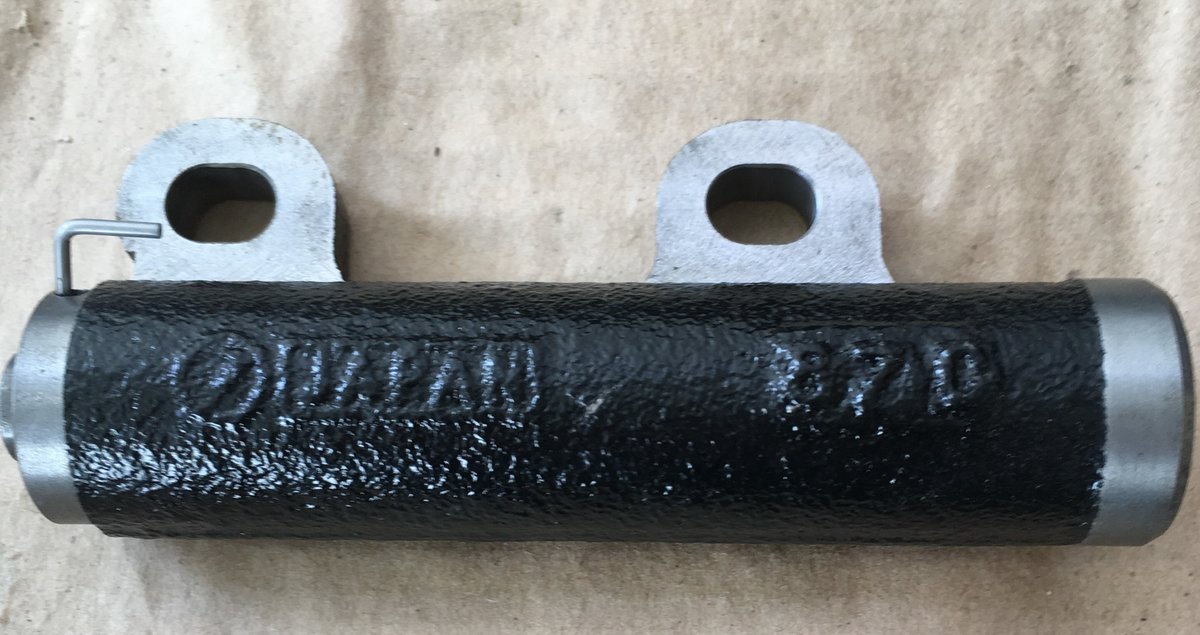

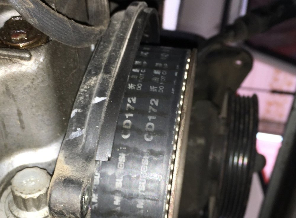

The pulley seems fine and its an NSK. Isn't that the preferred brand? What about a best brand of tensioner to order? ITM? ACDelco? Tell me what do do guys! Oh and no bearings found. I looked at the hyd tensioner closely but its really hard see the brand. I see something that looks like "Janson". ? What was the original brand? Also the belt says something like Mitsu_osi? Should I get a gates blue belt?

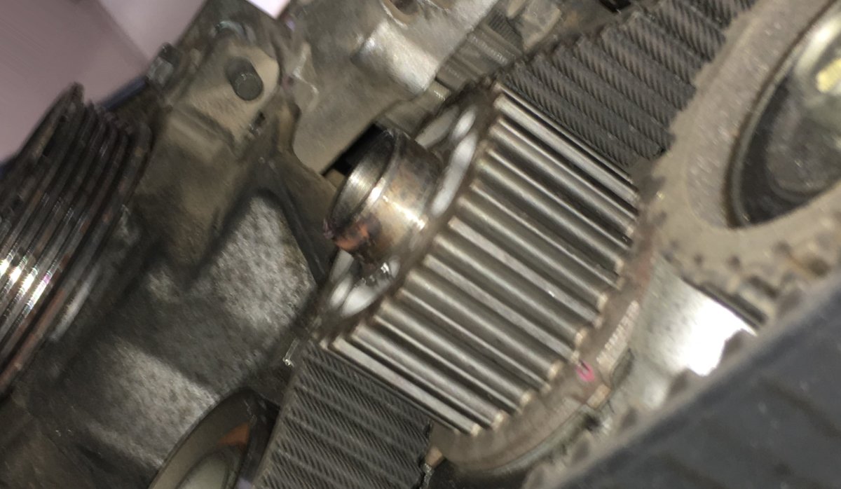

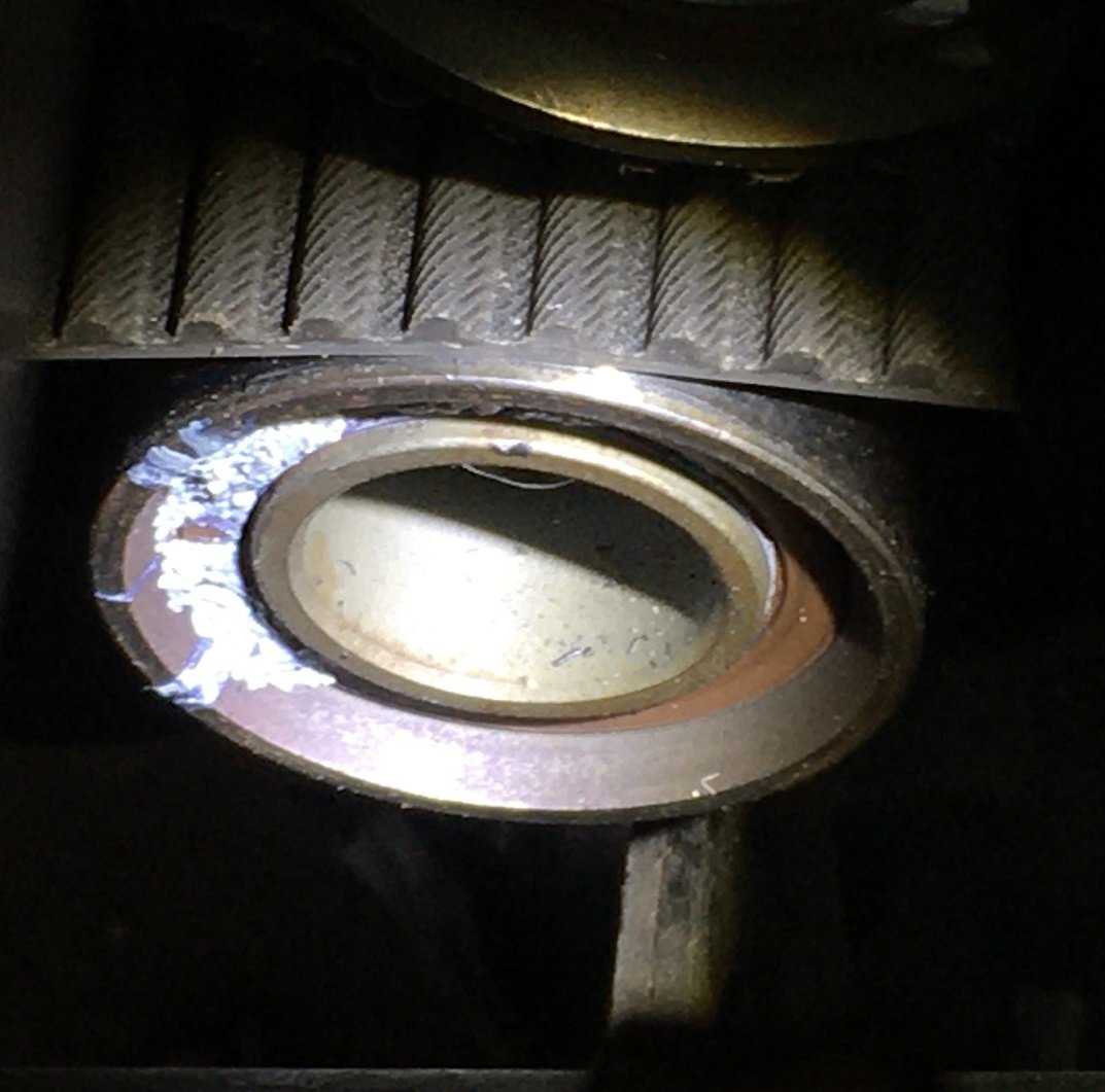

Got the cover off today.. what a PITA! On these, the motor mount blocks the cover from coming off! Check out this video! Does this look right?? (I bet not) Tension video This pic is looking up at the crank. (Sorry access is tough for a camera) My cams are set for belt installation so my crank appears 180d off! Also, my belt says something weird on it. It looks perfect but made in Thailand?? The tension pulley is a Japanese unit at least.

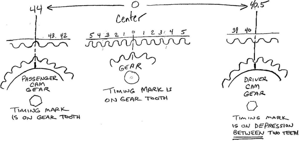

Thanks for the help. I researched this some but still have one question about that setup above. Couldn't the driveshaft be out of phase with the cams if you are simply going by the mark alone? It looks like you'd have a 50% chance of getting the timing correct unless you are confirming the valve positions visually. By all means correct me (please recall that I am new to this motor).
