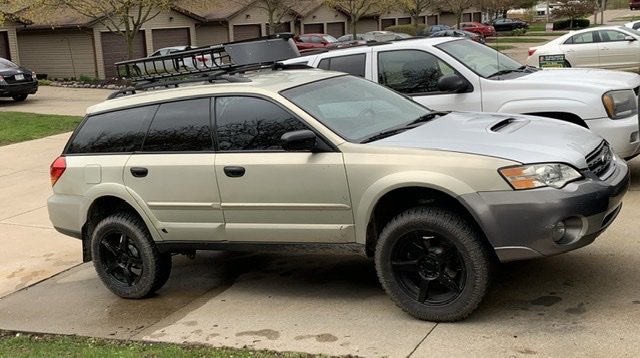

Hi all, I’m Justin.

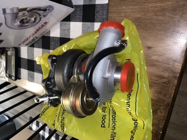

I have an 07 outback that I made my own 4.5” lift . Working on a turbo build for the same car. I developed a rod knock and build up a ej255 shortblock with forged internals and running it NA at the moment with 253 AVLS heads which came in at 54cc so I’m sitting at 8.5:1 compression ratio and should be able to handle some boost. Just got my new turbo as the first part that I’ve started collecting for this build. Excited to get more parts gathered and get this thing boosted!
