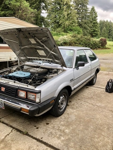

Okay, it’s an EA81 engine, L series hatch, base. I went through the dash and carpet and found some exposed wires as well as in the engine compartment. Fixed a wire from the ig coil and last night the car started and then died, also replaced a few suspicious fusible links. Did this a few times and fuse 13 was not blown. This morning, it starts for a few seconds then dies. Then it blew the fuse again. I do hear the fuel pump kick on. Relays have resistance etc. My question: could a ECM cause this? I’m at over a month on this thing.
1.8L L4 SOHC 8V (1800cc). This GL is the base, AT/ECVT. 2nd Generation GL. The ECU (or it has another name) I read controls the ignition on start up and also controls the carb.
