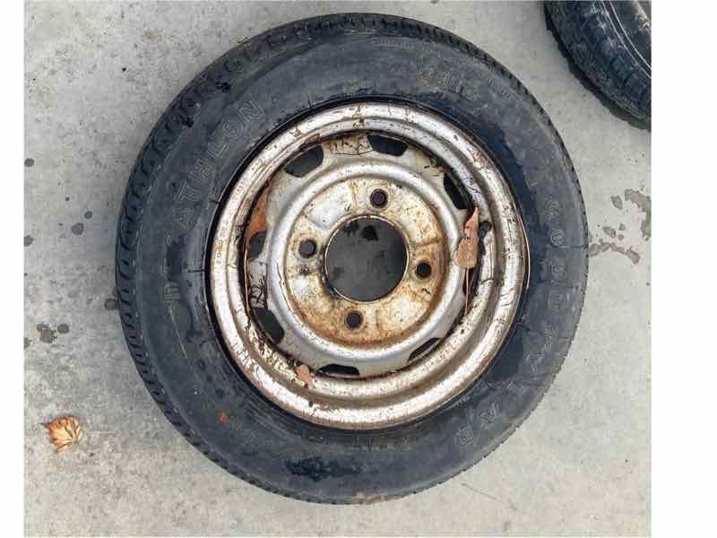

    Wheel decisions.
    I guess I should work on my math . Have 3 sets of rims. Looks like these are the ones that are original to the car.

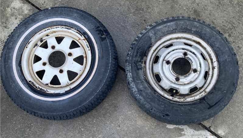

  4. 80BratGage
    Wheel decisions.
    Well I did just purchase a 78 parts car I’ll have him send me a photo of the rims. Looks like I’ve got about 6 of the plastic rings between the two rims.

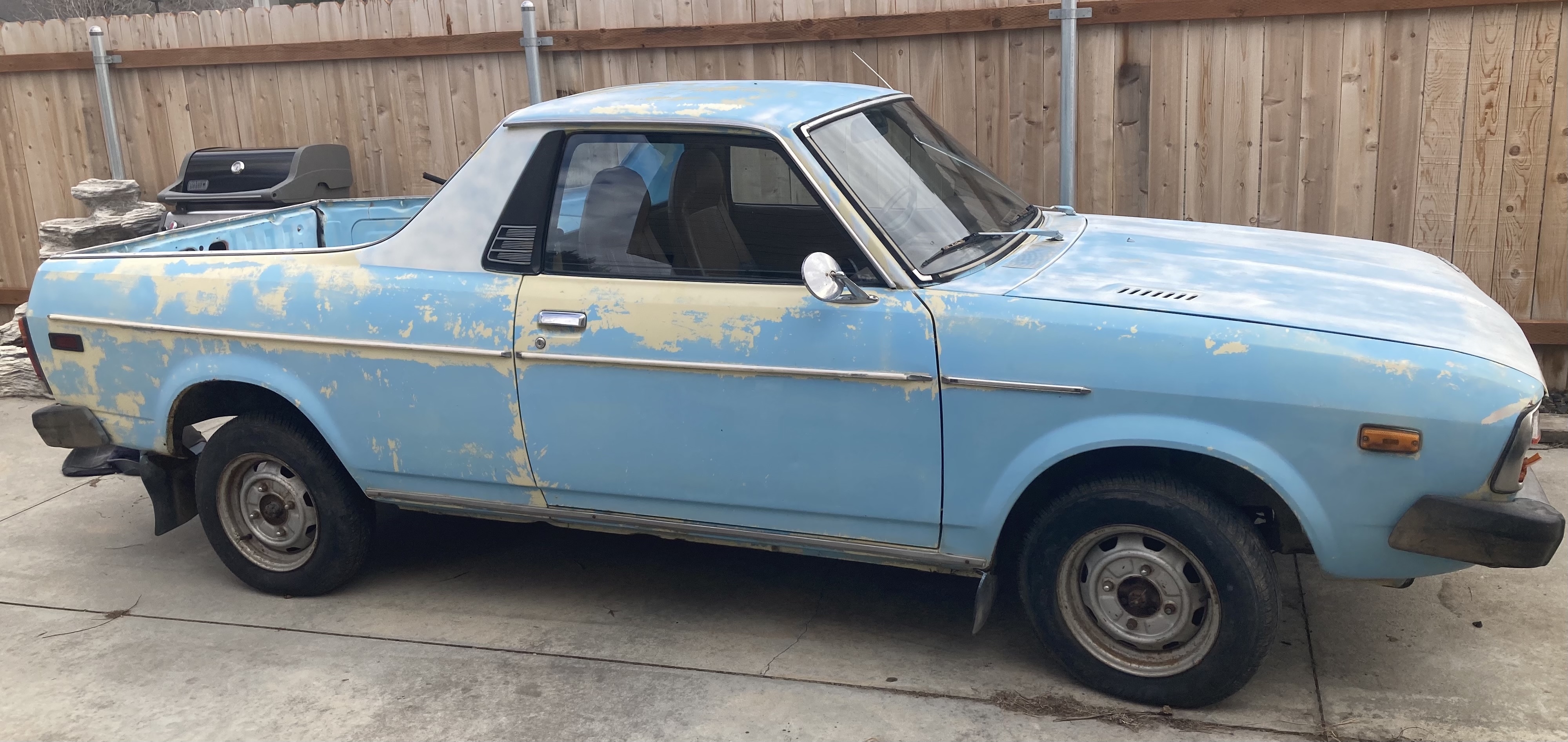

  5. When I bought the 1980 Brat DL it came with a set of extra tires in the back. Now that I’ve got the car starting I need to decide what ones I’m going to use as my main . Will either get them powder coated or just paint them not sure yet. Are either of them more desirable than the others? Any info as always is appreciated. I’m going to drive you guys crazy with all the questions! Thanks again. It will be fun to share photos of her when I’m done . Need to try and find a current color code that matches the Subaru cashmere beige. The car was originally the mild yellow but I’m not the biggest fan. I believe the original owner took the filter cover to Home Depot and color matched painted the car with house paint . Haha it’s peeling off pretty easily.
