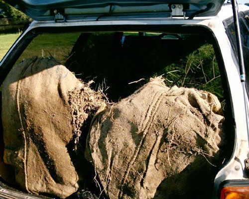

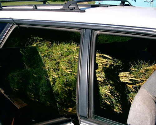

  5. some great pics here for sure! Have hauled a lot of stuff on my old wagon, 6ftx6ft chainlink dog kennel panels, doors, lumber, siding & trim but my favorite i think is this.... 3 - 6ft tall pine trees complete with root balls loaded inside the car.
