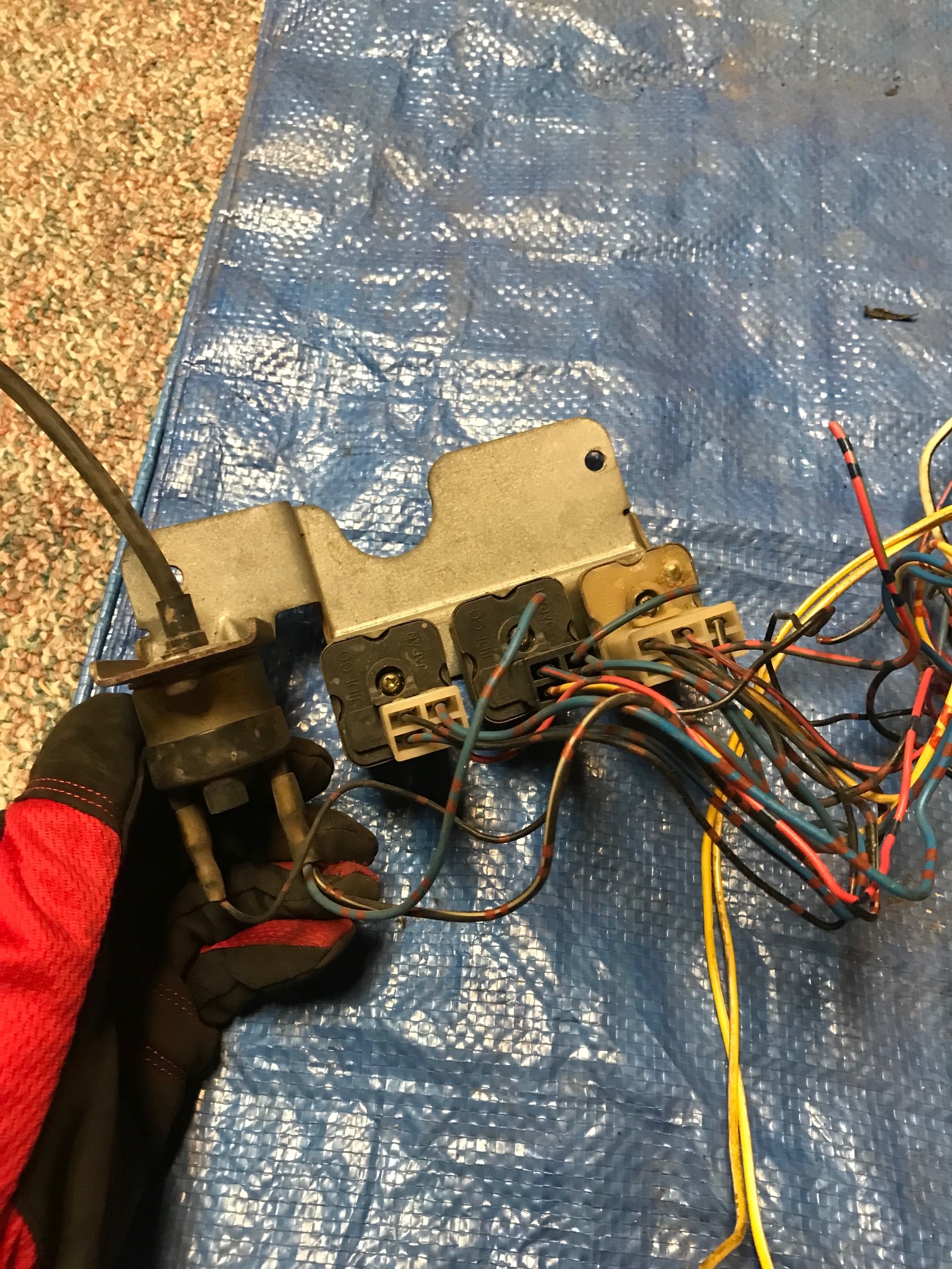

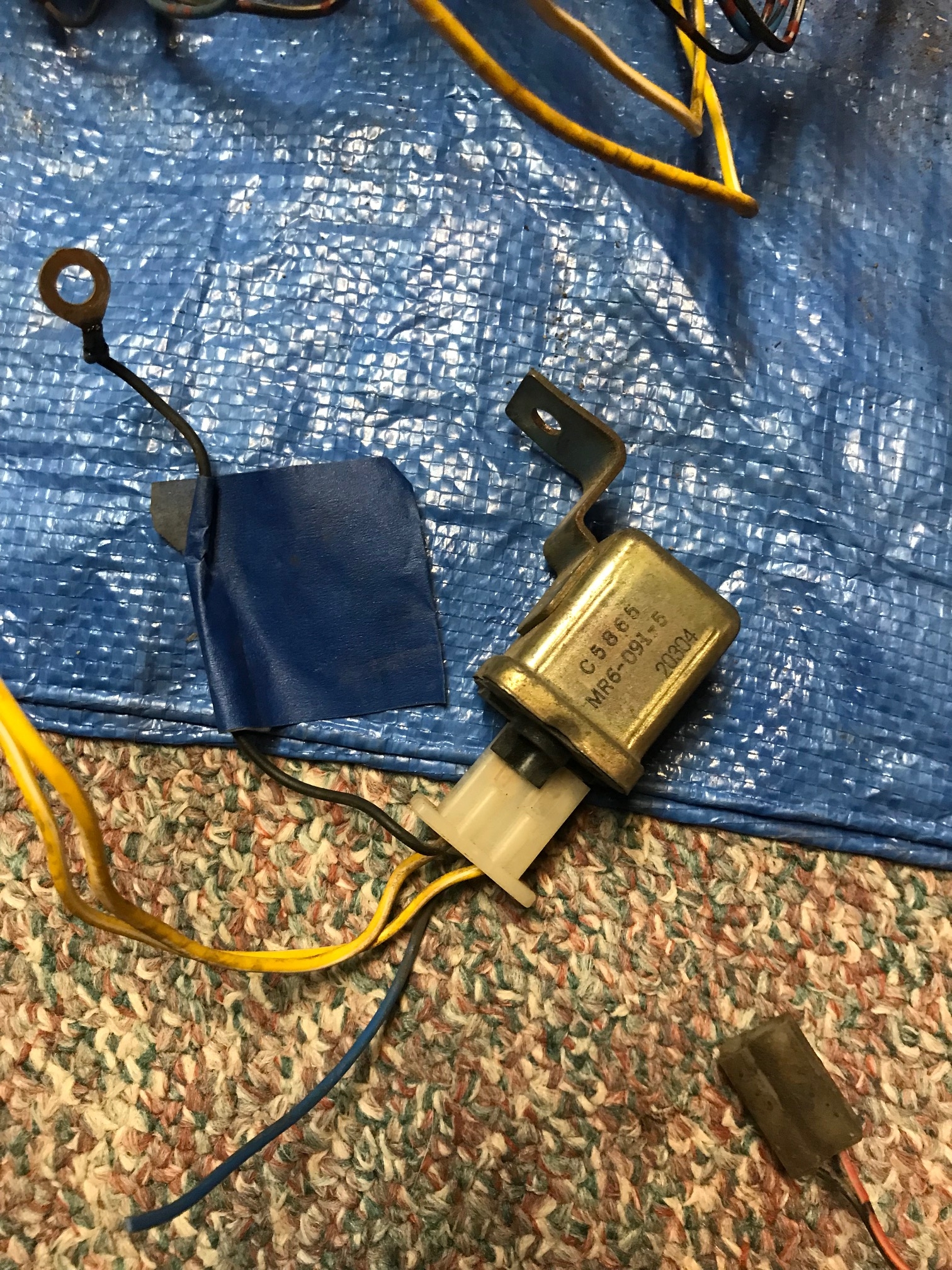

Thank you Bennie, I completely understand that it’s not necessary to remove the Brat’s wiring harness when doing this swap considering it’s mostly going to be powered by the EJ harness, but I just figured I’d clean up the engine bay a little bit and get rid of the rat’s nest of wires I pulled from it. Just want to be safe before cutting anything though. Just to confirm, that picture with the three relays and cylindrical connection point mounted on the metal bracket is all for the A/C? That’s the bulk of the wiring in the engine bay currently, and it just seems odd that there is so much wiring for just the A/C. Plus some of those relays have wires going to some important stuff, such as the headlights and the brake master cylinder. Through a quick parts lookup, I’m pretty sure the cylindrical connection all the way to the left with the hose exiting out the back is the refrigerant pressure switch, so I can rest assured that it’s for the A/C system.

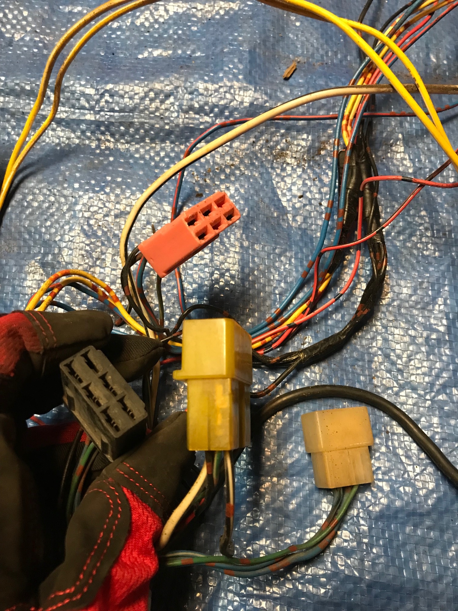

Hi everyone, Finally in the wiring stage of my EJ swap and I'm working on cleaning up the EA81's wiring harness (at least what was in the engine bay). Besides obvious things such as headlights, wiper motor, etc, what wires need to be kept? I have my EJ22 harness thinned out by SJR and ready to go in. I've removed my A/C wires as I will not be keeping it. There's a large cluster of wires and relays that were located on the passenger side by the strut tower, and when I've seen pictures of EJ22 swapped 80s Subarus, I don't see any of those wires there. Before I cut them though I just want to be sure. I'll have to post the pictures in separate posts because they can't all fit in this one post. I've also read in Numbchux's swap guide that the EA starter relay needs to be kept but I can't find any wiring harness that show it. Relays bolted to passenger side strut tower:

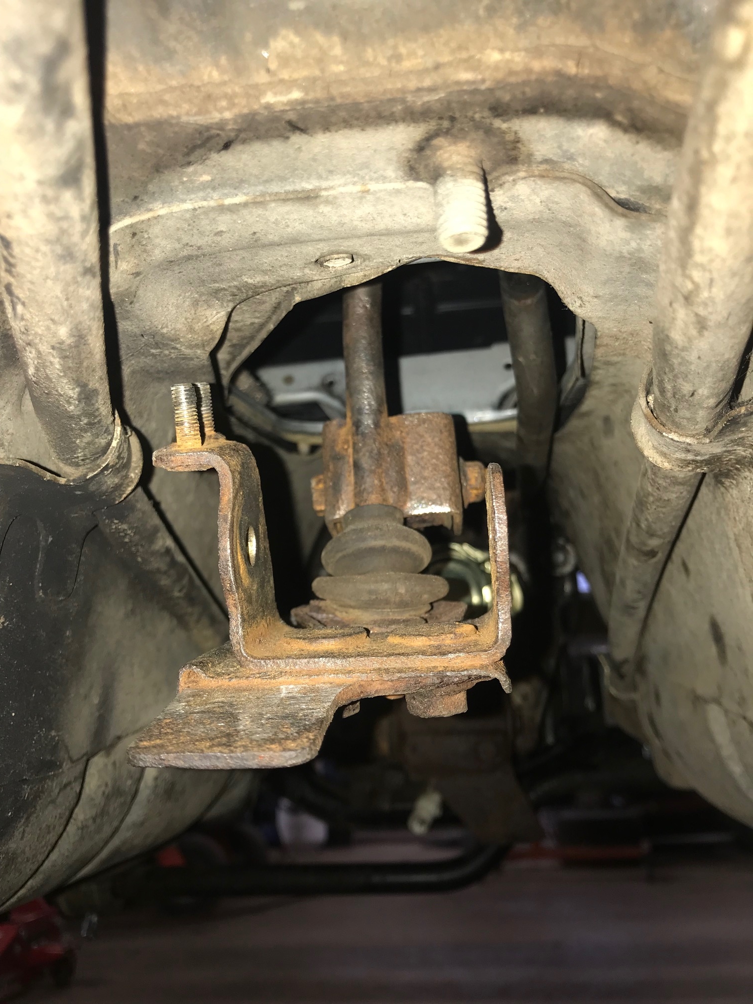

This new picture I just posted shows that unused stud that I believe you are referring to. I've been told about his rubber bushing, but I don't think my transmission came with one when I mounted it. There was one that went between the two bolts holes you can see in the lower bracket, but it was a part of the 4WD selector, and since Jerry's kit allows me to use the Brat's stock selector, I just unbolted it. Additionally, the lower bracket leaves no room for the driveshaft.
Hi Rupart, I think that this picture shows the lower mount bracket you're referring to. The parts diagram you posted labels it as 20. The bolt hole you see to the left towards the rear of the bracket is one of the two holes that mounts the 4WD high/low shifter. The two studs on top on the bracket are for the electronic mechanism that will display on your dash what mode you are in, but I don't place on wiring it. I figured that I would have to keep this bracket as it allows for the 5 speed shifter to be mounted, but keeping it there will not leave any room for the driveshaft, even when I move it as far up and out of the way as possible, therefore I removed it and it's why you can see that really shiny area of aluminum on the transmission. Do you have a picture of that rubber piece that bolts to the bracket and then to a stud on the tunnel you're referring to?
