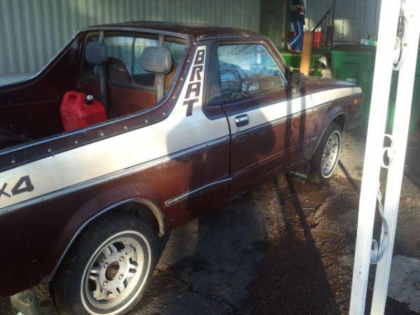

Hey ya'll, I'm talking to a guy right now on a Peugeot message board about picking up some wheels off him and I had a question I couldn't find an answer to through the search bar. (does that thing ever work? I can never find what I'm looking for on there...) The wheels he has are 15" diameter and 6" wide. I'm curious if 1. 15" will fit under a non-lifted 88 GL and 2. if anyone knows if they will line up well and not stick out. I'm having trouble finding backspacing information for the subaru wheels and the peugeot wheels. Here's a pic just so you know what I'm looking at.... Dude told me his are 4x100 bolt pattern in the e-mail, but I think he just doesn't know?? They are coming off a 1986 Peugeot 505 Turbo Wagon. He also said mine should be 4x100....so either he mistyped or is just misinformed right? Any help would be great. Thanks ya'll.
