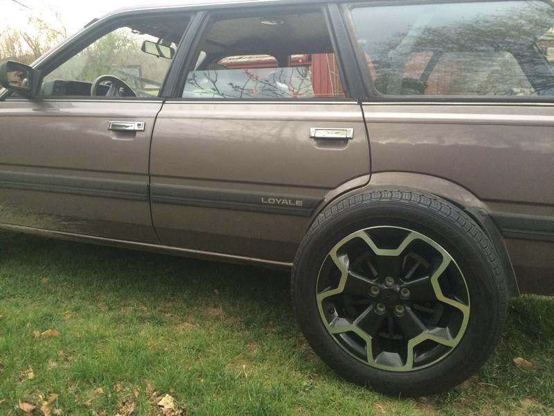

So after many many reschedulings over several months, I am getting my subie lifted with the 2" BOSS next week. I'm having XV wheels mounted with 5x100 adaptors. And I really don't know if this will go smoothly but it's time to give it a try. I have read mixed opinions about the 2" lift and what should or need not be done to the car for optimum performance and less axle damage etc. But i'll give my car a chance to handle this mod without other complex changes first. If it's a mess, I will either revert or make further mods. I'll post an update in a week or two.
