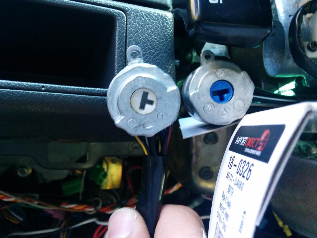

Good morning! I turned the key in my ignition to the "on" position a couple days ago and my car started up fine but after about 3 seconds smoke started coming out from behind my steering wheel, i quickly turned the car off and the smoke stopped coming out. I ripped all the plastics off and found that my ignition switch was the culprit. After removing the switch i saw a piece of solder that had fallen off the connection and bridged two connections causing the short. The short was hot enough to melt the wires around the switch and ruin it so I went out and bought a new one. Being a student i have very little money or time to wait for OEM parts to arrive from the stealership. I bought an aftermarket part for $23. My problem with the aftermarket part is that the rear connections didn't align with the ignition barrel as you can see from the photo, both of these switches were in the same "on" position but they have different alignments on the back.. So the screw mounting hole didn't line up with the the part. I had to use zip ties and JB weld to get the new part into its home. Very frustrating. I am posting this so people can learn something important about crap aftermarket parts. -Mike
