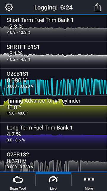

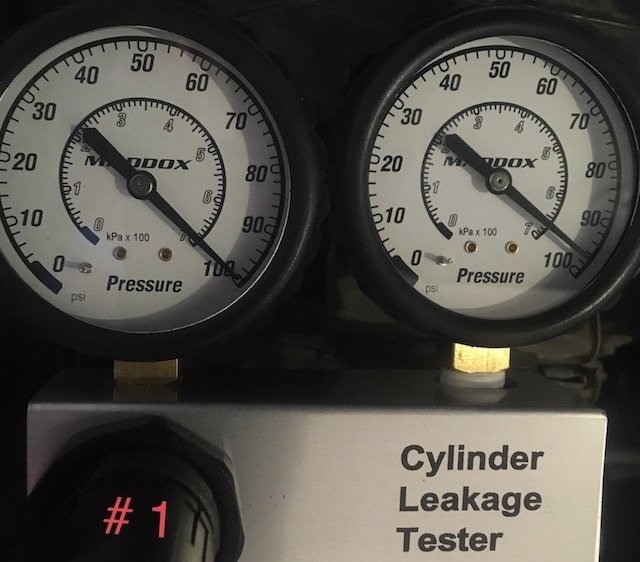

Hi all, EJ251 shortblock, EJ25 D heads, STI gaskets I'm getting an unbalanced shake/hesitation from 1800-2500 rpm. I can't effectively accelerate until rpms are above 2500. Taking off from a stop, the car feels bogged down. Plugs, Wires are less than a year old. Fuel pump/filter/strainer within 6 months. Coil and ignition module are within spec according to an FSM that I read. There was a vacuum leak with the purge solenoid under the intake manifold. It was not operating. Before I found that, my STFT, and LTFT indicated (at idle) 3-10%, and 18-25% respectively. After plugging the vacuum line I have the numbers seen in the photo below. I just did a leak-down test. According to the gauges, I'm within 10% for each cylinder. ALTHOUGH, I do hear/feel air escaping through the intake, and the oil filler tube. I followed this for instructions: I have also done multiple compression tests. For cylinder #3 is 225 psi, the remaining cylinders are between 210 and 215 psi. Can one cylinder being higher than the rest cause an unbalancing/misfire/poor low-end acceleration? Even if the numbers are good, the fact that I have air coming through the oil filler tube and intake, does this suggest the motor is shot? Check my timing again? Is there any change in timing instructions when mating an EJ251 with 25D heads? The heads are closer together, and the bolt holes for the intake manifold needed to be filed down a bit in order to properly bolt it onto the long-block. I've done a smoke test in/around the intake/intake manifold/hoses etc, and don't come up with anything. Thanks for the help, Greg

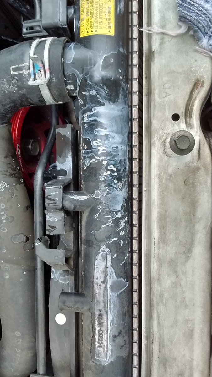

My '06 WRX failed to get me more than 1/3 the way to work this morning. Had a few drops or 'water' up on the winshield near left A pillar, then had a subtle hot coolant smell. Then a wisp of steam. Pulled into a lot, popped the hood. Wet all around front left. High enough that it was blowing back from the hood at the fender panel. Never saw any pinhole stream or active dripping. O'flow tank at mid level , never overheated according to gauge. Went back home. Haven't looked in rad yet - cooling off now. Pulled the snorkel and saw a little gel-booger with dried white-ish deposit 'blown-back' from center-ish area of top tank.(will try to post pic, I haven't really firgured out how to do that very well yet) Everything so far looks like a crimp leak or maybe a crack? in top of rad.? Fans are cycling so, I feel the temp gauge was properly reporting and there seems to be no sign of a headgasket issue . Kinda also wondering about best replacement rad. Denso? TYC? Other? Is there a brand I should prefer or, maybe more important, avoid? I wouldn't ming paying for quality. In Texas, I need as much cooling capacity as I can get. Not really wanting to modify the car so, drop-in prefered of course. Any other work I should do 'while I'm in there' ? I have original hoses so, I plan to replace those. Although it's been wiped away, the little 'gel-like' deposit was near that bolt-head, on the vertical surface of the front brace above the rad's front crimp area. To me, obviously associated with that white deposit. Couold have been seeping for some time.

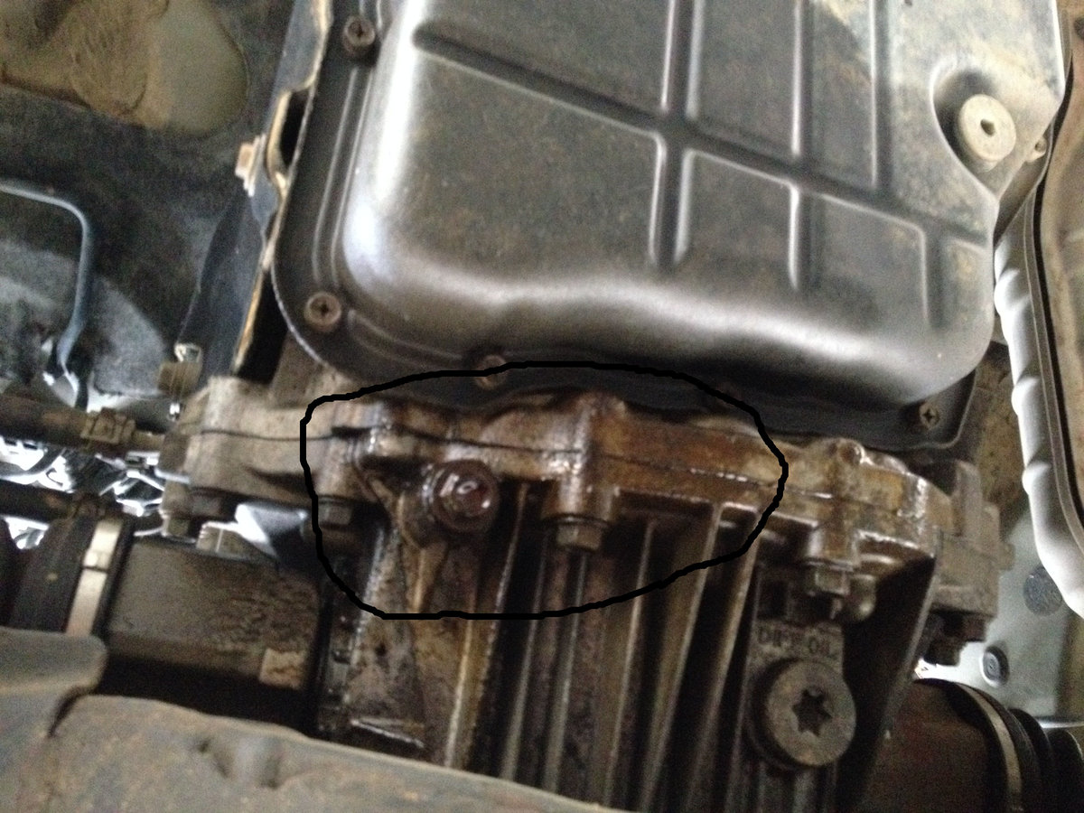

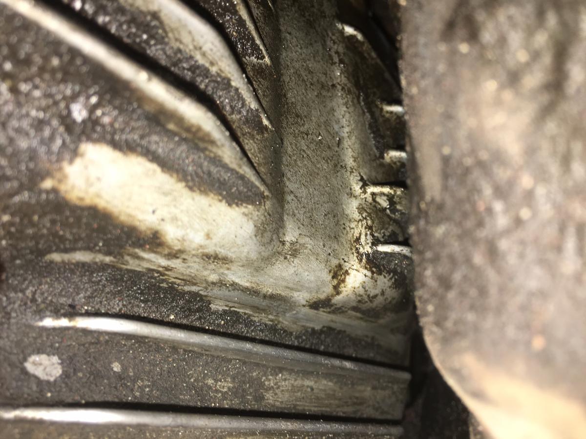

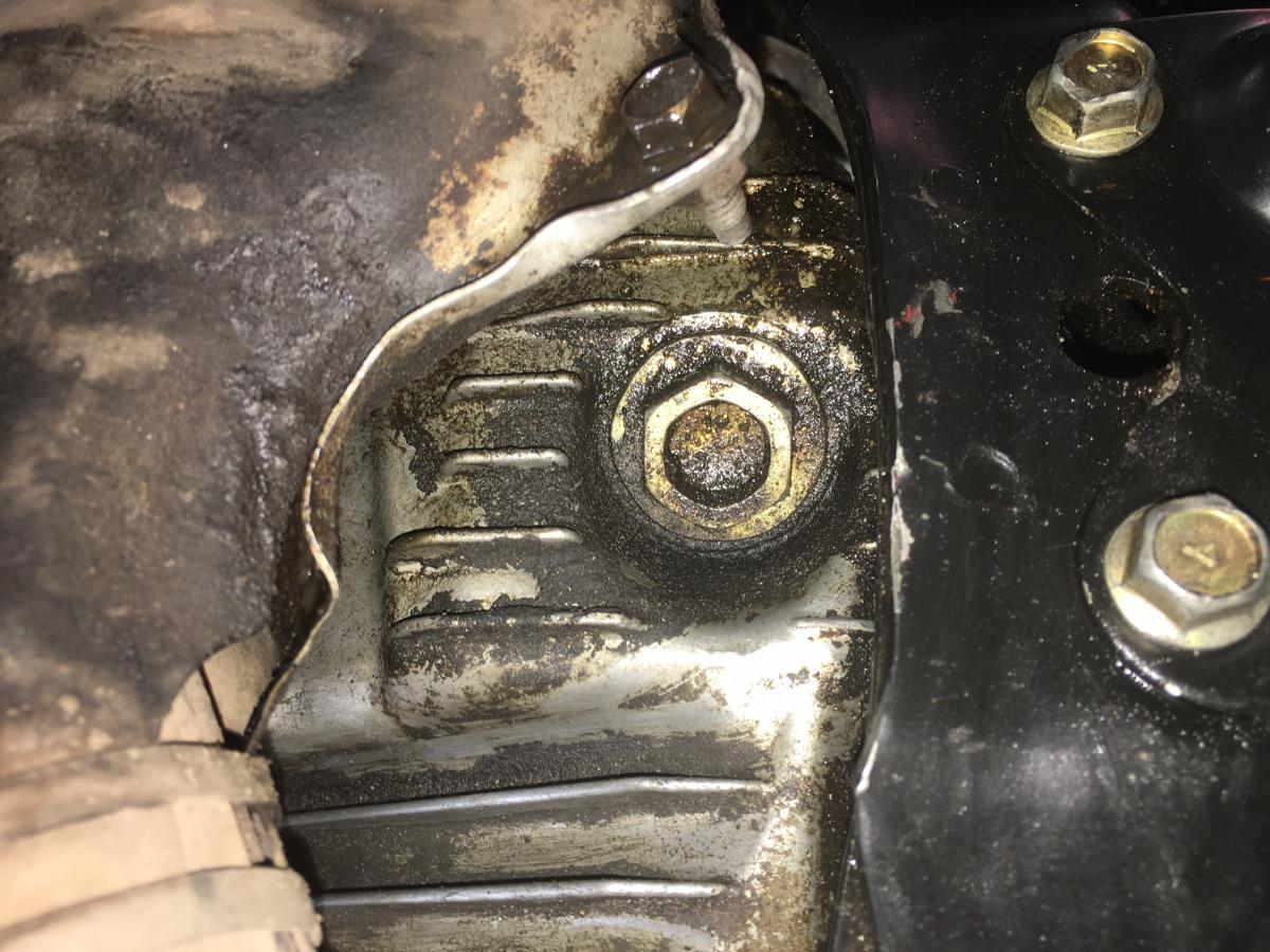

I have a 2010 Subaru Outback 2.4L with about 144,000 miles. I was doing an oil change on Monday and saw some fluid leaking. The area I've circled had fluid on it with it 'pooling' on the bolt near the middle of the circle. It appears to be coming from the front differential but I am by no means an expert and was wondering if I was right. I'm only guessing this because of the 'Diff Oil' label to the right. Last winter as part of some scheduled maintenance I had a Subaru dealer replace the differential oil since it was -40c out and a couple of the things were beyond my comfort level. Over the summer the Subaru is our second vehicle so it didn't get driven much but I started noticing some small spots of fluid on the driveway. I wasn't too worried and was going to check next time I was under there as there wasn't any major spots and I couldn't see anything from the top. If it is the a differential seal/gasket, it seems like something that needs replacing before it destroys itself from what I'm read but I wanted to get some thoughts before running ahead and doing something. Thanks!

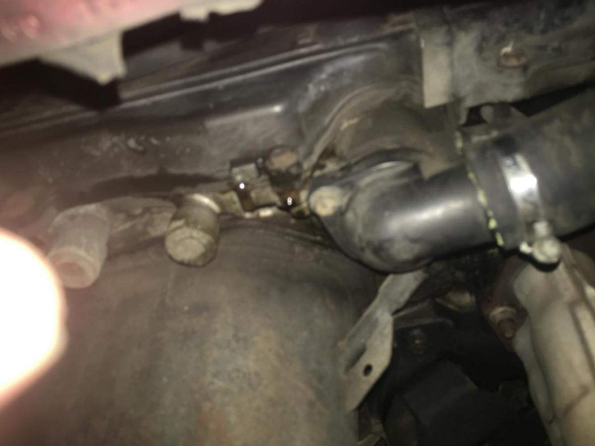

I recently got a 1996 Legacy Outback as my first car, and it has driven great for the first 5000 miles that I've owned it. A couple days ago, however, I noticed some what I think is coolant below the engine. Then yesterday I noticed some more pooling beneath the engine. After checking again today, none has leaked. It seems to me that the location of the leak is next to a radiator hose and timing belt cover (but not on the hose itself). You can see the two shiny drops of fluid in the attached picture. There is no overheating, "off" smells, or any other behavior out of the ordinary-- just the leaking. Any idea what may be the cause of this leak, and what I should do about it? I'm not too mechanically savvy, and this my first car, so any help is much appreciated!
