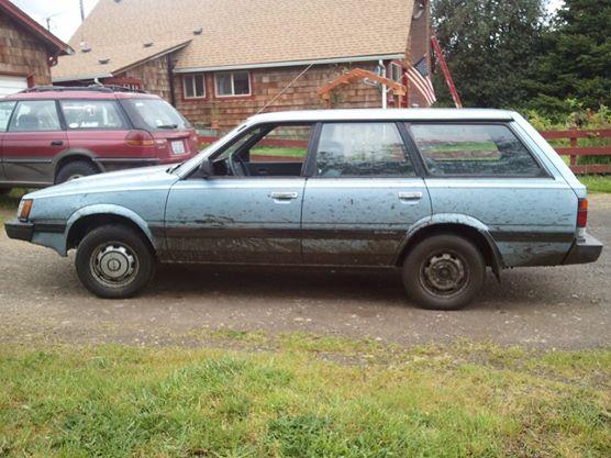

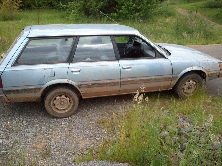

Hello every! So I've started moding up my 1982 GL wagon. It' has a lifted body and suspeion and I'm running kuhmo 27.5 tires. I'm almost finished doing an SPFI conversion and an EA82 swap. Got the engine and harness/ecu from a 1988 GL sedan 4wd. I'm building an EA 81 engine on my shop bench too and may swap back to the original after a while and once I'm finished building the 81. I may.......uh hum.....keep the 82 even until it quits. Either way I'll have the SPFI system on whatever I run. Ive already done the distributor conversion fir the 81 to use the SPFI manifold and SPFi on it. It has a Weber carb now. The new FI fuel pump comes in tomorrow so I should be firing her up. Have a bit of wiring and alot of organizing of the new harness to do first tho. I've been busy fabricating a winch bar and installing a new winch on the front past couple days. Here's a few pics of how that turned out. I found some 1965 mustang sway bars (2)
