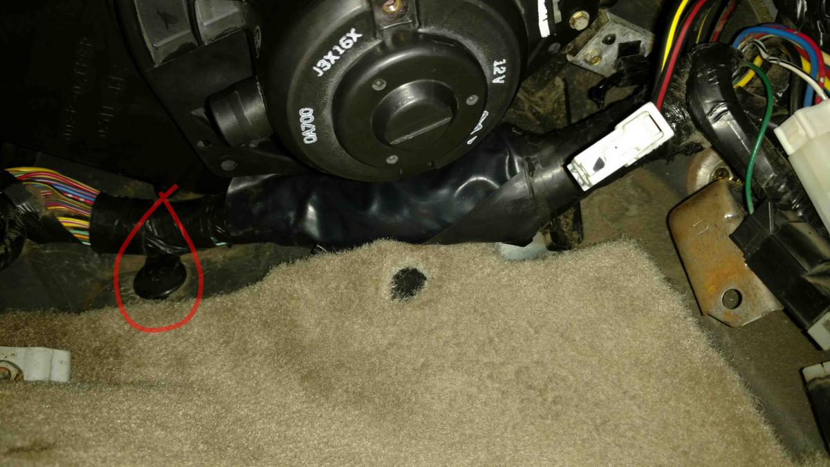

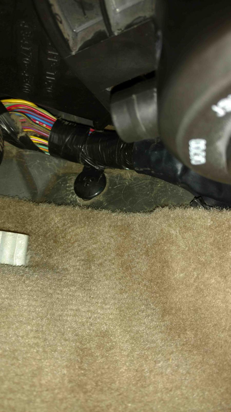

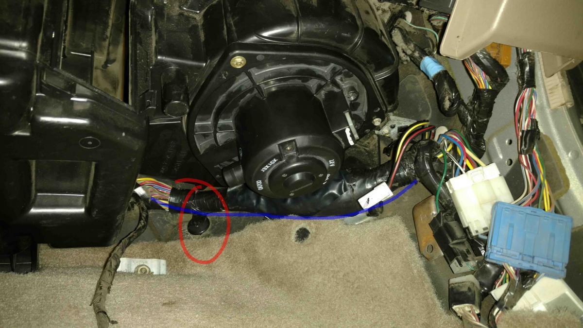

Yesterday I removed the blower motor for diagnostics and replaced its relay near the in-cabin fuse box of my 2004 Outback Limited. Replacing the relay solved the problem with the blower motor. When putting the blower motor back in place, however, I had to really pull and mush on a large mass of wires that runs directly below the blower motor. It was not a simple task to take the motor out or put it back due to this large group of wires (roughly 1-2 inches in diameter) running right under the blower motor with very little room to budge. Immediately after getting the motor back in position, my car would not start and the fuel pump relay would buzz madly with the key in ignition. The stereo receiver died and the lights on the dash were dying. After turning my car off, a part under the hood began to buzz and all the electrical equipment began to rhythmically click and turn on/off. I disconnected the battery and went to bed. I messed something up when getting the blower motor back in. I pulled wires loose or damaged them. The wires branch off after passing the blower motor, some running to the blower and the rest running up the passenger side of the car. When getting the motor back in I pulled on a small black circle with three little holes in it, above where the passenger would rest his feet. It appeared to feed into the group of wires and run out to the engine compartment. Maybe this is important. Any information regarding troubleshooting or what could be wrong with my car would be very helpful. Thank you. Attached are pictures of items I mentioned in the post: the fuel pump relay, the part under the hood that buzzes, the group of wires under the blower motor, and the black circle with the three holes in it.
