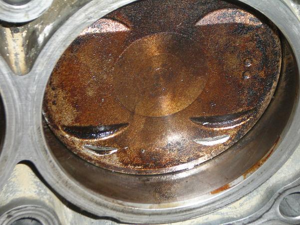

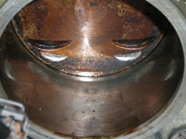

Tahoe Subaru Posted March 4, 2010 Author Share Posted March 4, 2010 (edited) Ericem you win the prize Update.. I have the car running. 98,000 miles, 25 miles after Subaru inspected the belt. failed timing belt tensioner, 6 bent valves. leaking head gasket, had subaru conditioner installed in 2004. compression test after hanging a new belt. 0-0-180-120 the 120 cylinder had 2 bent intake valves, the 0's had bent exhausts, the car actually ran on 1 and a half cylinder. but not very well Subaru engine gasket set. Complete timing kit and water pump New Clutch and flywheel New tires Left front wheel bearing Right front inner axle boot Edited March 4, 2010 by Tahoe Subaru Quote Link to comment Share on other sites More sharing options...
ericem Posted March 4, 2010 Share Posted March 4, 2010 Wow those valves collided pretty good with the pistons At first I was like WOOT a prize, oh, dang lol. Quote Link to comment Share on other sites More sharing options...
Tahoe Subaru Posted March 4, 2010 Author Share Posted March 4, 2010 (edited) yeah I'll buy you a beer. next time I see you, HA when my BMW shed it's timing belt at 61,000 miles, of a 60,000 mile interval, it broke the cam towers. kinda f----- up ed the head. any way thanks. my girl is happy Edited March 4, 2010 by Tahoe Subaru Quote Link to comment Share on other sites More sharing options...
