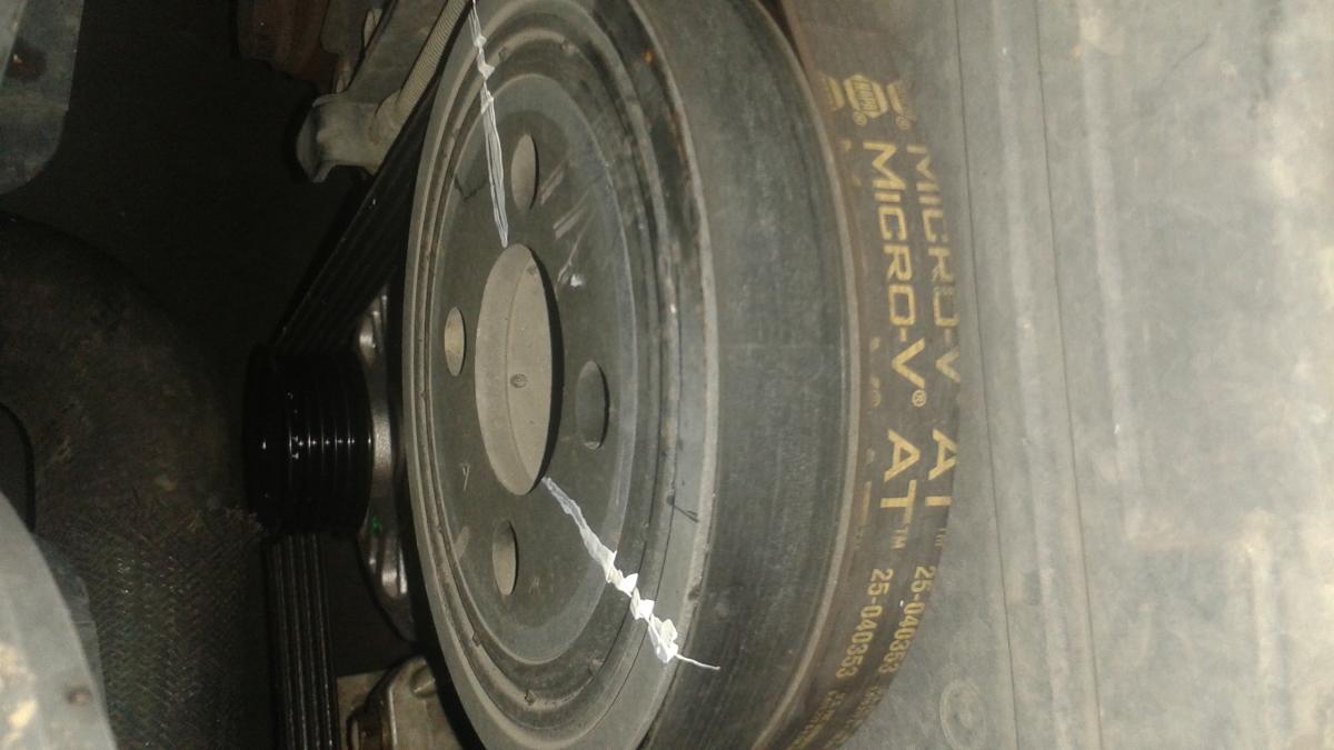

Draw a line across the face of the crank pulleye - chalk/sharpie/etc.
Run the engine.
If the line breaks up - the pulley is separating.  The belt isn't turning enough to produce much output from the alternator.
This produces - alternator failing symptoms, but replacing the alternator doesn't fix it...because the issue is still present.
Testing alternator voltage first - would point to reduced output.  Which tells you to check the pulley or test the alternator off the vehicle in the parts store.

Marked the crank pulley and ran car a few min. Acelleratin a bit. I have no voltmeter to check for voltage drops. But i figured i could check the grounds by hooking up a wire from the alt. case to the -battery post. No change.
