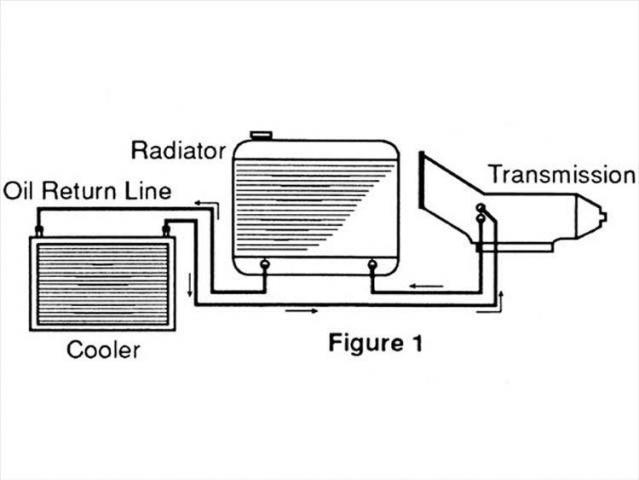

Can I bypass the cooler in the radiator all together or do I have to install it like a secondary like the instructions show??? Oh. I'm wanting to put an aftermarket trans cooler on my legacy.

I would go as a secondary, placing it between the tranny and the raditor. Keep in mind that the heat exchanger in the radiator serves two purposes. Not only does it help cool the transmission, but it also helps it warm up faster. If you put it after the radiator you may be keeping the tranny too cool.

That's funny. I thought there was no such thing as too cool when it came to autos. My next question is: which of the 2 lines is the return? I'm assuming it's the lower one.

There is always such a thing as too cool. All liquids have an optimal operaiting temp. When they are cold, they are thick. This means everything has to work harder as they are resistant to being pumped. The tranny also will hold gears longer when cold to aid in the warmup of the transmission. If you live in a very cold climate I would suggest a Thermostat on the line. IN all honesty off hand I forget which is which I would have to look it up

The top hose is the pressure line. The lower is the return. I'm also about to install a tranny cooler. I was going to completly bypass the radiator heat exchanger. After reading nippers post, I'm going to rethink that idea.

IN all my years of doing these on small displacemnt engines I have always put them before. I have also always installed them with temp gauges too. NOw if you live someplace hot it wont matter that much, but places with real winters it would.
Handy chart
http://www.txchange.com/heatchrt.htm
Sort of why subaru recomends 36000 mile fluid changes. With a cooler
My temp sensor is in the hotest spot, the feed to the cooler. My driving (NYC stop and go) I have seen it as high as 100 over ambient, but that is peak summer).
Anything over 275 is bad, 200 is on the lower end of high, and 175 is just right on average). If you live in a hot climate all year round then I would go after.

Running it through my head, without the t-stat still just 4 clamps and two hoses.
normally: one hose to and from the cooler = 2 hoses and 4 clamps.
with Both in place it's now:
1 hose from trans to rad
1 hose from rad to cooler
1 hose from cooler to trans
so we are both a bit off - it's now 3 hoses and 6 clamps instead of 2 hoses and 4 clamps. 50% increase in risk and failure modes.
