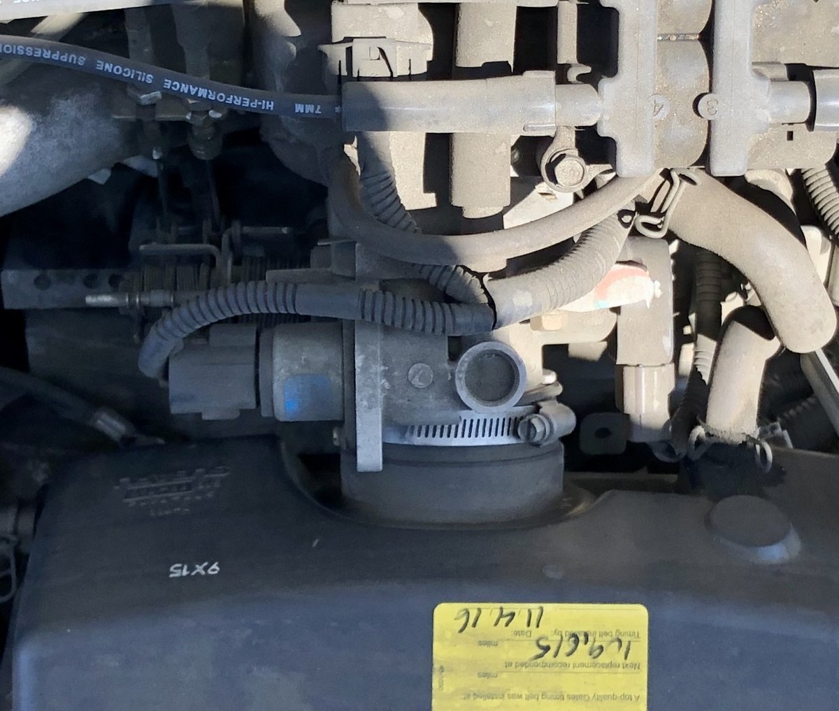

Today, on my way to work, I noticed that even when my foot was off the gas that the car would continue to accelerate. However it was slow, and I saw that my cruise control wasn’t on, so I brushed it off. As I got closer to work, I came to a stoplight and noticed this unintentional acceleration getting worse. When I was driving into my parking space, the car abruptly , ON ITS OWN ,mind you, revved up to 6000 rpm . As fast as I could, I turned the car off. Later in the day, my cousin came to help me look into the problem. Two things we found, number one, there was a chip of wood stuck between the butterfly valve of the air intake on the engine manifold. ( where the Engine metal meets the plastic)
We assumed that was the issue, as wood chip was actually allowing air to get into the system and rev the engine even without pressing on the gas pedal. The real question was how a piece of wood big enough got into that area. That’s where the second problem comes in , I noticed while putting the air filter back in place that before this whole situation I had never had the filter latched in correctly. There’s 2 notches on the bottom of the plastic cavity and you need to make sure the air filter is clicked into those before snapping on the clips at the top.
I hope this information helps anyone with a similar problem. I believe the wood chip got in because that air filter was not correctly connected.

I just started up my 2003 Legacy L SE wagon for the first time since December today (had left it on the opposite coast). I did a 3.5 mile test drive around the hilly, rural block. At two points in the drive, the car floored itself. When I pushed in the clutch, the engine would go up into the red at 6500+ rpm, so I let the clutch back in and used the brakes to slow me down to prevent overrevving. It was then normal for a few minutes, before it floored itself the last mile to the end of my loop. There is evidence of animals living under the hood, nut shells and stuff - it had been completely clean under the hood when I had left it in December.
I'll clean all the debris out when I get a chance tomorrow, especially the air box and throttle body where you found stuck wood chips. I think I might find more debris left by animals.
