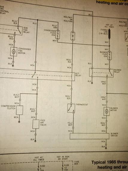

rrgrr Posted December 9, 2013 Share Posted December 9, 2013 Something (probably me) killed power to my heater blower -the fan fuse was blown, and when I replaced it, nothing. I've hotwired a battery on the pass side floor to run it. If someone could describe the circuit path of this thing it might save me some digging. The 2 wires on the blower are green/white(grnd) and blue(+). Do they come from the fan speed knob? Quote Link to comment Share on other sites More sharing options...
Gloyale Posted December 9, 2013 Share Posted December 9, 2013 Pretty sure the ground is actually the blue wire, and comes from the heater switch. The green/white wire is POS 12v from the relay. Likely your're relay is blown. What year and model? Quote Link to comment Share on other sites More sharing options...

Cougar Posted December 11, 2013 Share Posted December 11, 2013 Just an added note in case you aren't aware of it. The speed control resistors are located on the return side of the circuit for the blower motor. Power comes from the relay, then to the motor, and then on to the switched resistors and ground. Quote Link to comment Share on other sites More sharing options...

rrgrr Posted January 5, 2014 Author Share Posted January 5, 2014 Your not understanding relays. The Blue/red is 12v from fuse box, to the relay. The Green/white is 12v out to the fan when the relay closes. The Red/yellow wire should be 12v signal when key is turned on. From fuse 12 15amp. If key is off, this wire has no power, and the relay is open so no power goes out the Green/white. The last wire should be Red/white. This wire should have ground. Non A/C ground all the time........A/C models ground only when one of the mode select switches is depressed (heat/vent/defrost/etc..) Sounds like you either have no power to Red/yellow or no ground on the Red/white. This means the relay never closes. fix that and the relay will work. Then replace your blower resistor because your 1 and 2 speeds are burned out. Sounds to me like the power is not getting to the trigger wire with Key on. Thank you for helping me try to understand this. I think I have determined that red/white is not grounded. I followed it, but It goes into that harness and I don't want to get into that much if I don't have to -Can I just cut it and ground it elsewhere? Quote Link to comment Share on other sites More sharing options...

coronan Posted September 24, 2014 Share Posted September 24, 2014 I have a similar situation on an 82 brat. My manual says 80 - 84 has the same wiring. I found the blower relay above the fuse box. when the key is on it closes 12v from white to green. At the switch all legs have power except black (ground). Resistance on each leg was 50 to 250 ohms. I am to understand that the relay sends power to the blower but is switched on the ground side???? So if my blower does not come on but the switch has power and ground = bad blower motor Right???? Quote Link to comment Share on other sites More sharing options...

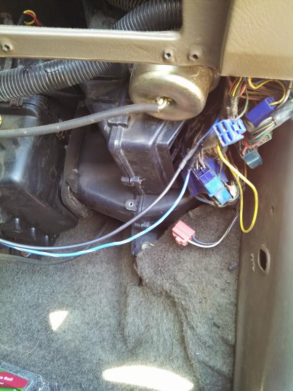

coronan Posted September 24, 2014 Share Posted September 24, 2014 (edited) I'm spelunking under the dash for the blower resistor. to the left of the glove box is this: 6 wires Behind the glove box is this: 2 wires Is the blower resistor hidden in this rats nest? ?????? Thanks! Edited September 24, 2014 by coronan Quote Link to comment Share on other sites More sharing options...
Gloyale Posted September 24, 2014 Share Posted September 24, 2014 I have a similar situation on an 82 brat. My manual says 80 - 84 has the same wiring. I found the blower relay above the fuse box. when the key is on it closes 12v from white to green. At the switch all legs have power except black (ground). Resistance on each leg was 50 to 250 ohms. I am to understand that the relay sends power to the blower but is switched on the ground side???? So if my blower does not come on but the switch has power and ground = bad blower motor Right???? Unless your brat has A/C installed.......you don't have a Fan relay. Read my writeup in the USRM about the EA81 blower power supply. http://www.ultimatesubaru.org/forum/topic/140176-ea81-blower-circuit-jumperrelay-connection/?do=findComment&comment=1179606 Quote Link to comment Share on other sites More sharing options...

coronan Posted September 24, 2014 Share Posted September 24, 2014 Still haven't found the blower resistor box. Is that where all the blue wires lead to from the switch? I pull the blower an jumpered power to it. It spins fine under its own power. Funny thing is it has power when the switch is in the off position but none of the on positions. I'll pull the blower switch out again tomorrow and follow the blue wires. Hopefully they lead to buried treasure. I shopped for a resistor and a new switch but could not find anything at Orilies, Napa, Rock, Autozone (though i try to avoid shopping there) Suggests this part: http://www.autozone.com/autozone/accessories/Electrical/Relay-and-Resistors/_/N-2659?filterByKeyWord=blower+resistor&fromString=search But its only 3 wires??? http://www.autozone.com/autozone/accessories/Santech-Red-dot-units-71R-1450-blower-resistor-block/_/N-2659?itemIdentifier=262814_0_0_ I should just put in a PWM..... http://www.amazon.com/Pulse-Modulation-Control-Switch-9V-60V/dp/B00MN6R6JW/ref=sr_1_8?ie=UTF8&qid=1411594954&sr=8-8&keywords=pwm+20a Quote Link to comment Share on other sites More sharing options...
Gloyale Posted September 25, 2014 Share Posted September 25, 2014 resistor pack is mounted IN the ducting.....I believe you can see it on the drivers side beside and above the gas pedal. 4 pin connector The blues wires through the switch and resistor are the ground for the circuit........that's why you see power on the wires when it's off.......12v coming through the fan from the relay. When you turn it on, it closes the circuit, and drives the volts on the blue wires to 0 v. The switch connects the blue wires to ground. What you need to do is test for power on the Green/white wire at the blower w/ key on. If yes....then relay is good. Then test the black wire at the switch to see if it's connected to ground. Even if the resistor pack is bad the blower should work on high (4). So if it doesn't work at all the problem is either power to the motor, or ground to the switch, or some break in the wiring between. Quote Link to comment Share on other sites More sharing options...
ivans imports Posted September 26, 2014 Share Posted September 26, 2014 3 inch from blower motor Quote Link to comment Share on other sites More sharing options...
ivans imports Posted September 26, 2014 Share Posted September 26, 2014 whoops on newer on old one is just above heater coolant valve Quote Link to comment Share on other sites More sharing options...

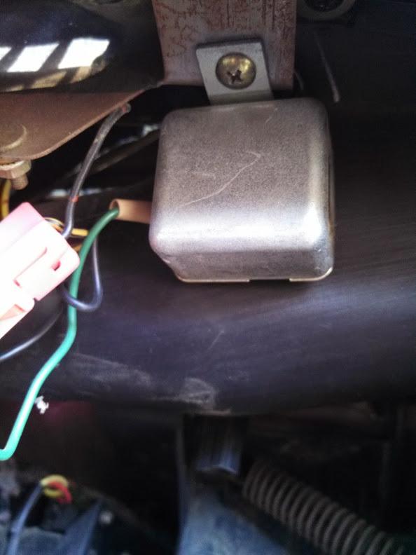

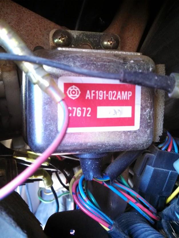

coronan Posted September 30, 2014 Share Posted September 30, 2014 (edited) Found my problem. Thanks to Gloyale for pointing me in the right direction with this image. <a href="http://s209.photobucket.com/user/Gloyale/media/IMG_0192_zps09c006bc.jpg.html" target="_blank"><img src="http://i209.photobucket.com/albums/bb29/Gloyale/IMG_0192_zps09c006bc.jpg" border="0" alt="A/C jumper EA81 photo IMG_0192_zps09c006bc.jpg"/></a> This particular relay lives mounted directly above the fuse box on the drivers side. To get to it pull the fuse box with 2 screws. Then pull the bracket with 1 screw and bend it down. Vola! Even though the Fan had power from the AC circuit it would not run. ( I still don't know why. ) The glass fuse in my fusable link was rated 20 amps same as the blade fuse in the box. They are so close to one another I'm tempted to bypass it. It looks like my white wires got hot due to a bad connection. I'm not sure of its purpose. Any one else had trouble with this fuseable link? Edited October 1, 2014 by coronan Quote Link to comment Share on other sites More sharing options...
