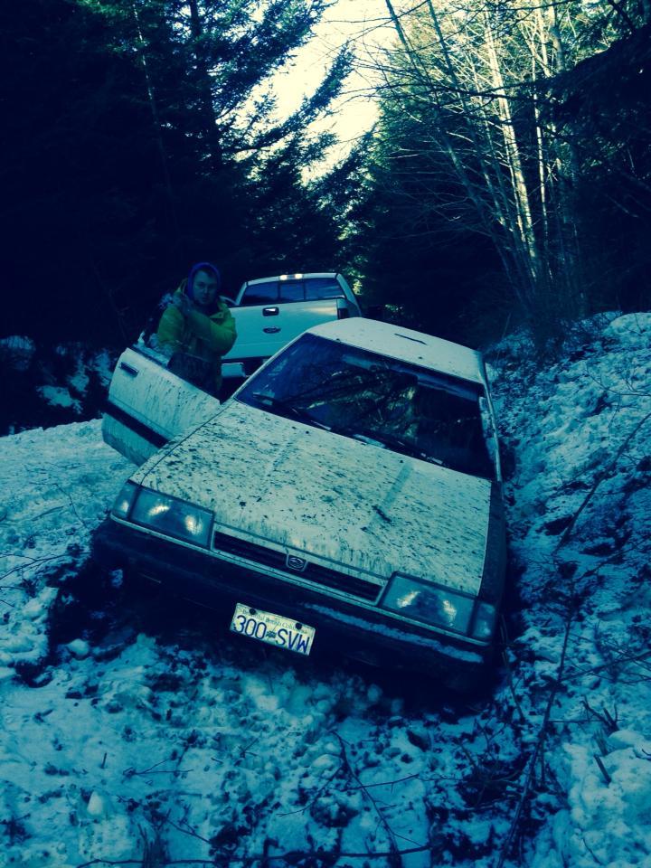

Subaru stuck. Burned clutch. Need replacing or can it be adjusted ?
Hello everyone. I'm sort of new so Subaru's. I had a 1980 when I was a kid to bash around in and took my road test on an 83 turbo. Now I have this 1993 Loyale 4x4 wagon and had a big mishap yesterday and got stuck almost on it's side in a snow/mud filled ditch. I tried getting it out and smelled the clutch burning. We got it out today and when I drove it home the clutch doesn't engage until my foot is almost off the clutch. It also will slip in gear. Do I need a new clutch or can it be adjusted to driveable again ? Any help much appreciated !
