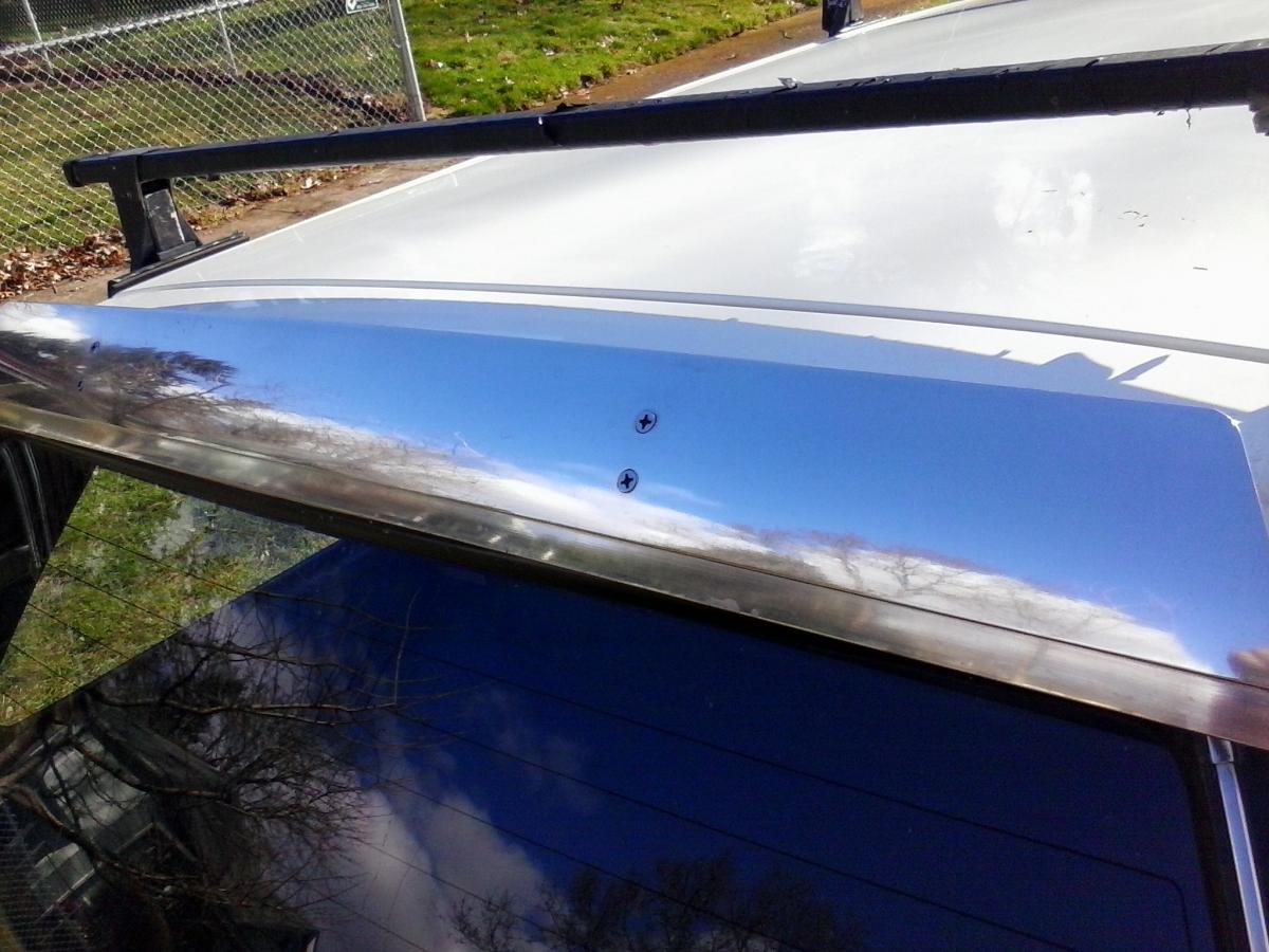

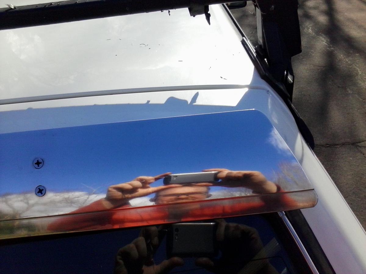

several steps:
24 years of road grime slowly chipping the black paint away,
jasco paint remover,
0000 steel wool,
3000 grit wet sandpaper,
Mothers Mag and aluminum Polish.
Elbow grease,
Sunshine.
Stainless steel wood screws.
