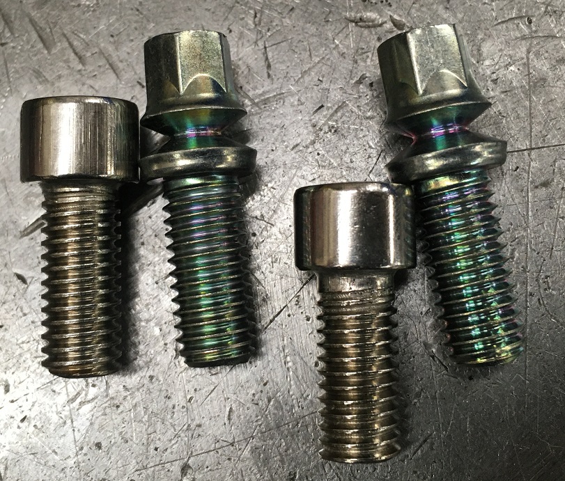

When I bolted in the new one I used socket head cap screws (left) instead of the break off bolts supplied (right).
Turned the car on and off without blowing fuses.  Still had to use the start button fairly often especially when the starter was hot.  Can't take the key out in the on position anymore which is annoying.

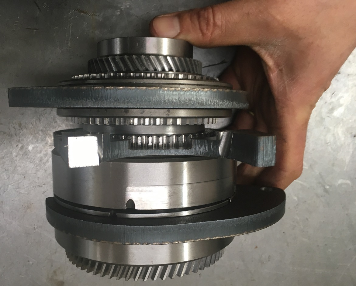

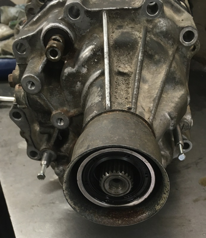

I've been waiting to post about this all year.  Let me start by saying these won't be cheap, on the order of $4000 retail.

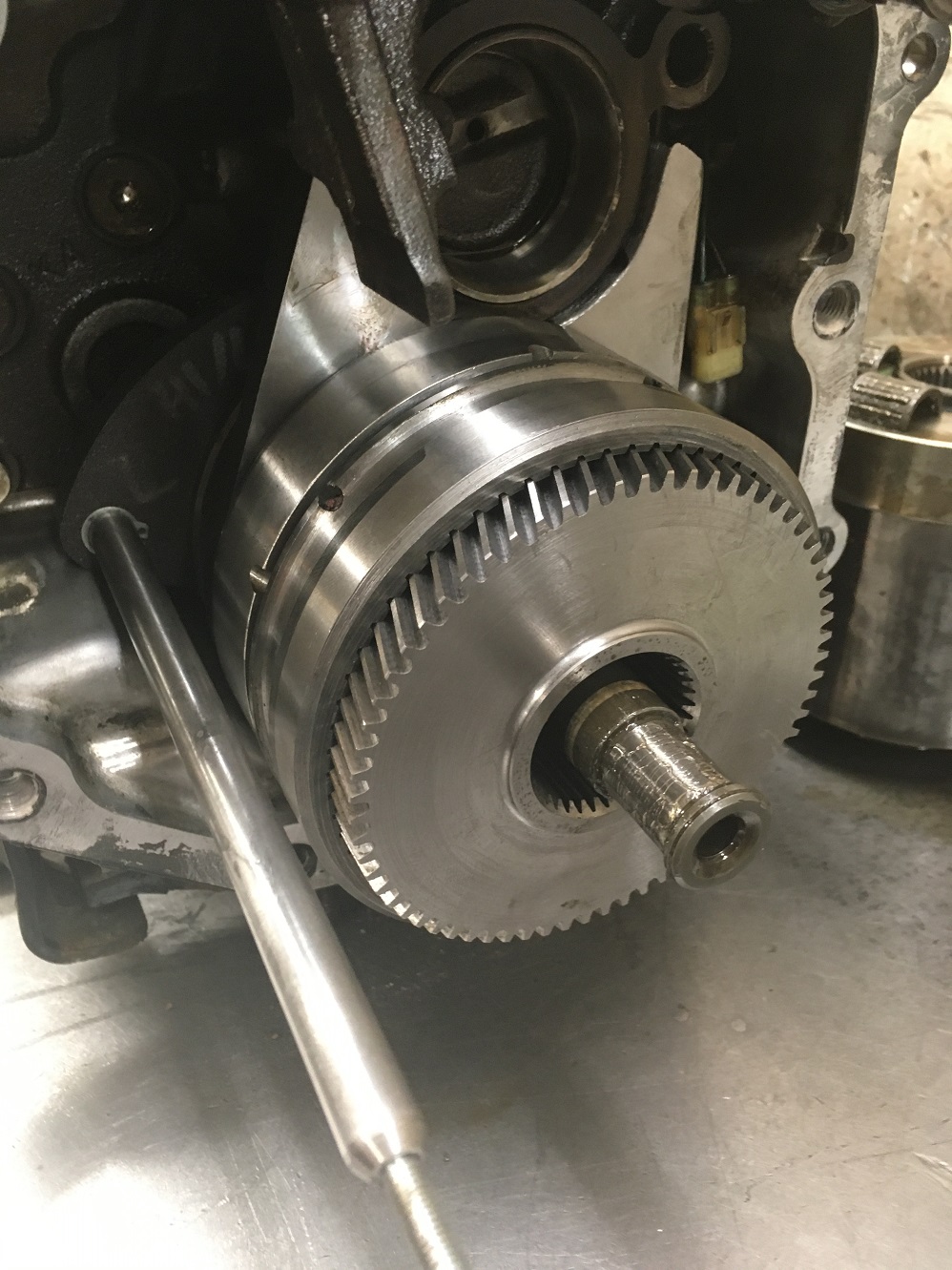

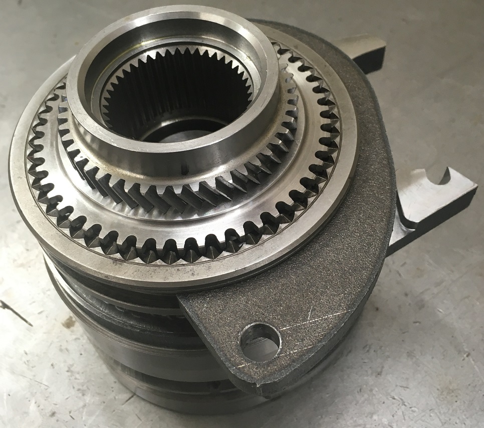

This has been a few years in the making but we finally made a proper low range for a Subaru.  Replaces the center diff of a 2006+ STI 6MT.  Shifts between 1:1 high and 2.94:1 low.  Center diff shifts between open and locked, no limited slip feature.  We've had one in my 99 Outback for about five months now.  We've had some shifter cable issues.  It popped out of high on rough portions of V2R.  It occasionally shifts into center diff lock also, most often on rough trails.  Those problems will probably be fixed by a better shifter.  Unit itself hasn't had any problems yet.  Everyone who drives it says it's like cheating.  Low range in B's Forester with the 1.6 dual range is equivalent to in between second and third in low with this trans.  We hardly even use first low on climbs, second or third is usually plenty, even putt up some hills in fourth low (equivalent to about first in high).  Finishing a few more we have most of the parts for, next one is going to slammo.  These are some pictures from the mockup, not the finished product:
Video from our test run at Badlands off road park, video never does the hills justice but at least watch the rock crawl starting at 1:15:
https://www.youtube.com/watch?v=FyDVQnRx-Dc
I think we can fit the same thing in a 5MT which obviously has a much larger market.  It looks like the easy way to do the shifting would be to use a rear case section from a pre 97 5MT with the access panel on top.  No idea how the standard driveshaft and R160 will hold up to a 2.94:1 low range but I guess we'll find out.

Correct, those have a female splined rear output gear and I don't know of a good way to make that work with this design.

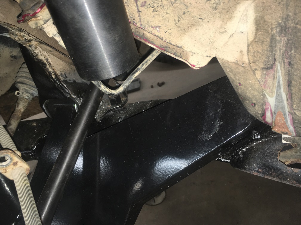

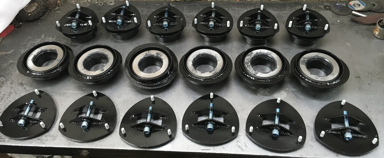

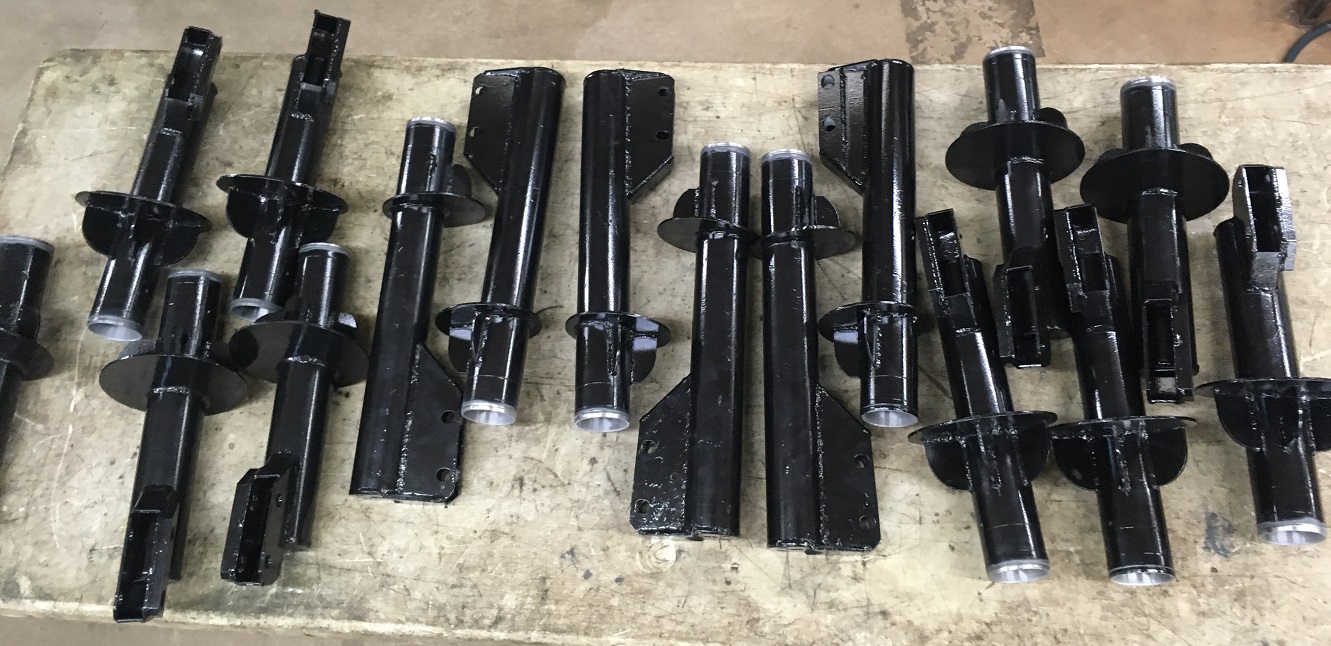

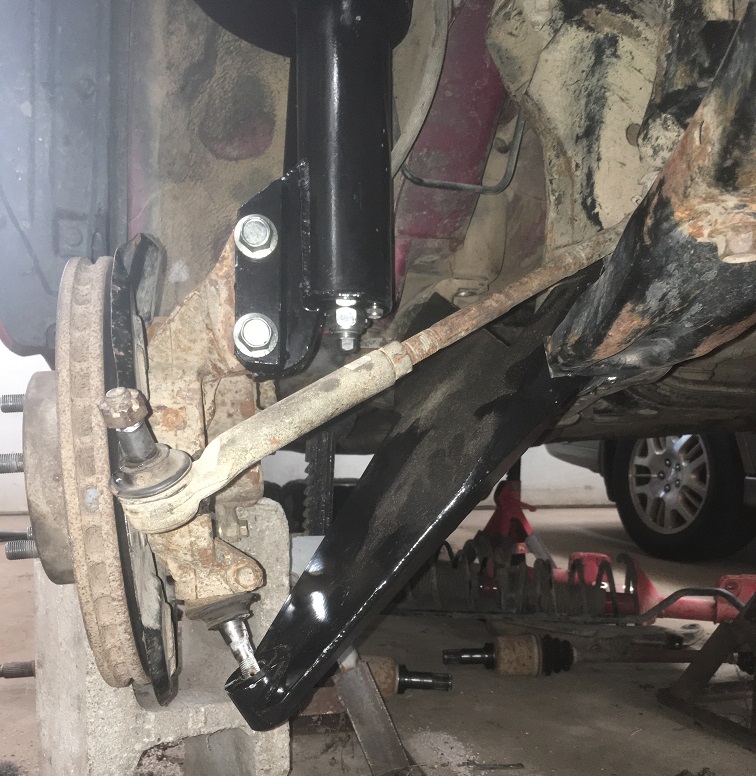

We've been working on the long travels.  I think this is all the housings - galvanized, painted, and ID ground.
Prepping the tops
Z's set is all assembled and ready to install on his car which should happen soon.  Really just need a couple bushings and bumpstops to finish slammo's set.

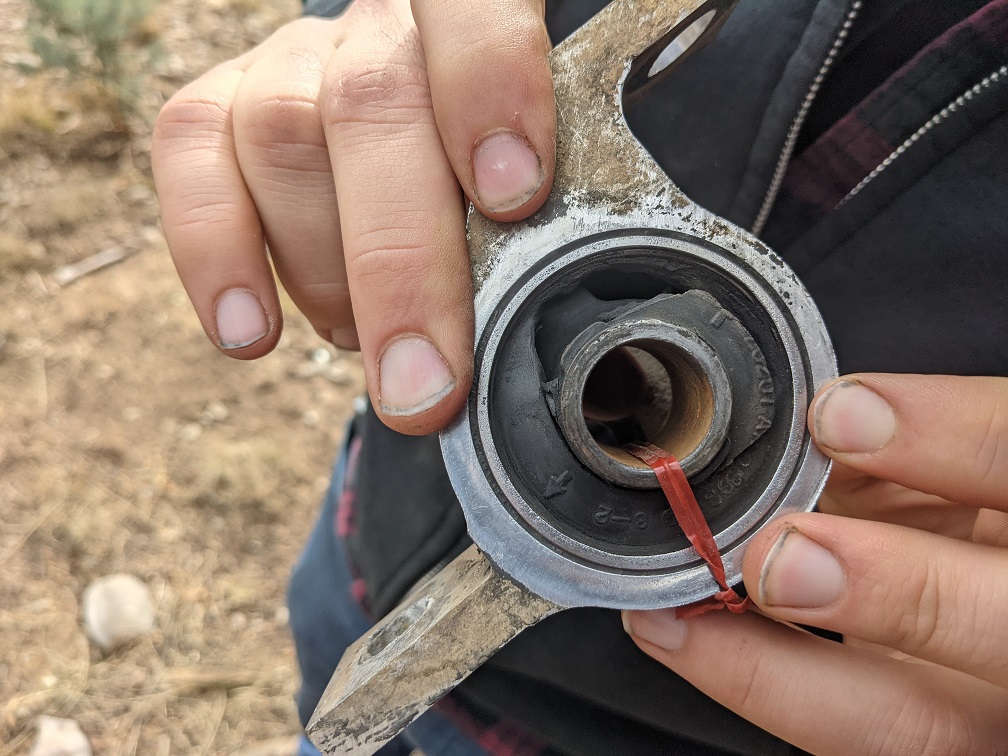

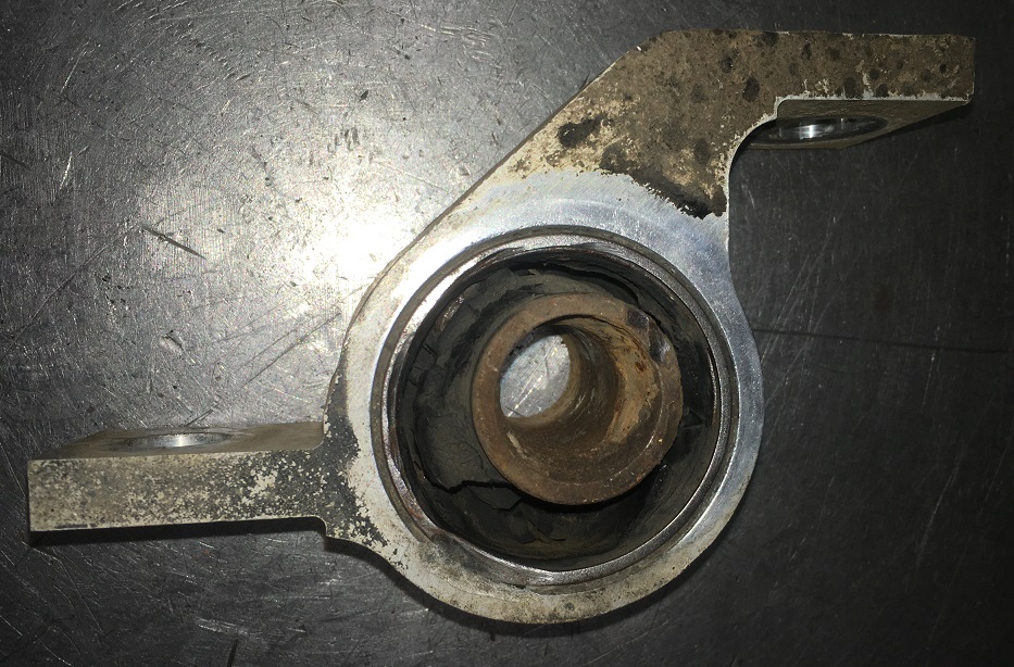

Front control arm bushing off B's Forester.  Maybe the most worn out one I've ever seen.  He recently replaced both his rear wheel bearings, another reminder we have to do the billet rear knuckles.  Still need to get his dual range back together and back in his car too.

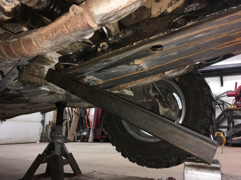

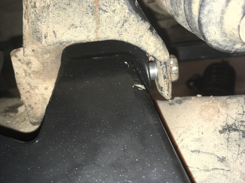

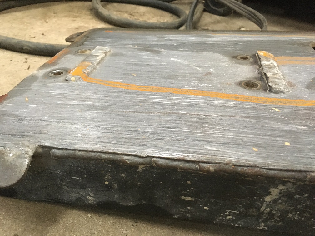

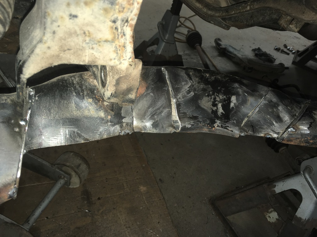

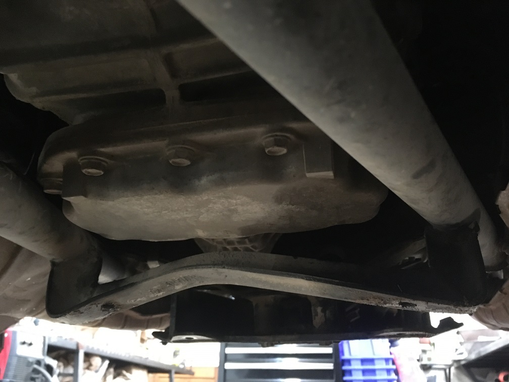

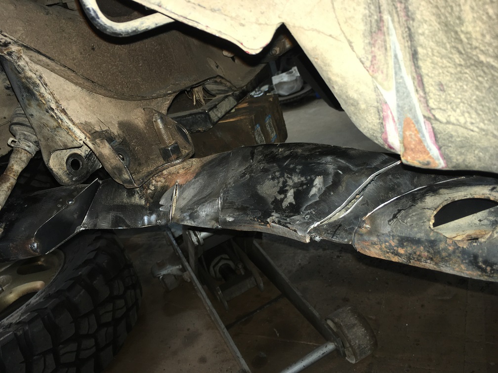

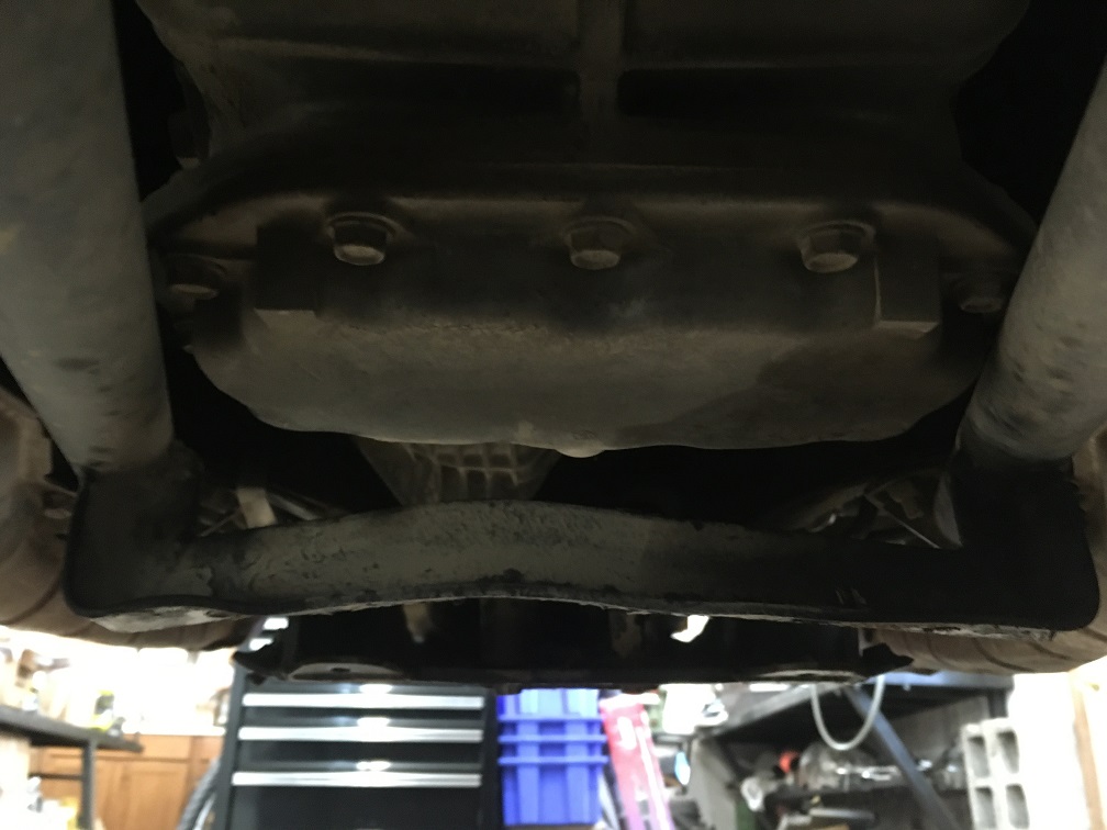

Support for the trans skid plate on my 99 was quite bent after the Vegas to Reno.
Bent it back about as straight as I could using a big piece of tubing and the floor jack.
Flattened the panel back out in the vice and got it bolted back in.  Definitely not flat but much better than it was.

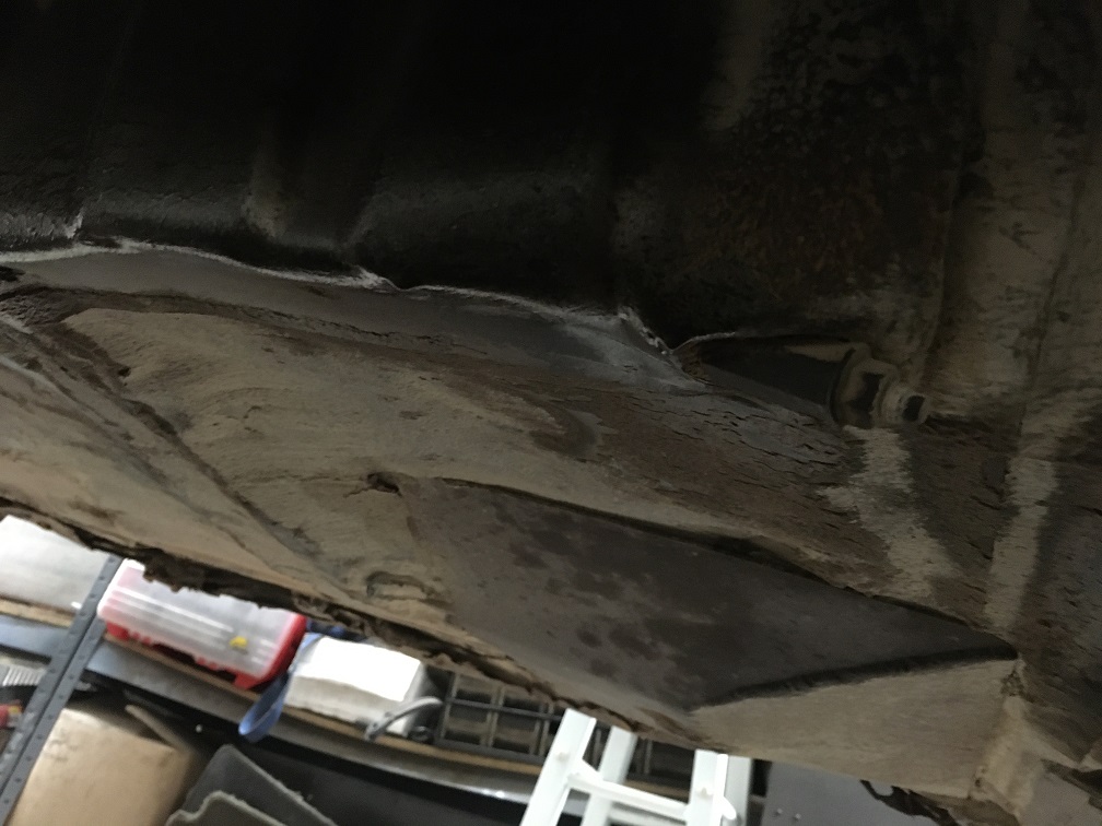

Hard to get a good picture showing how beat the floor of this car is, in person it looks like the ocean.
Many of the skidplate bolts looked like this.

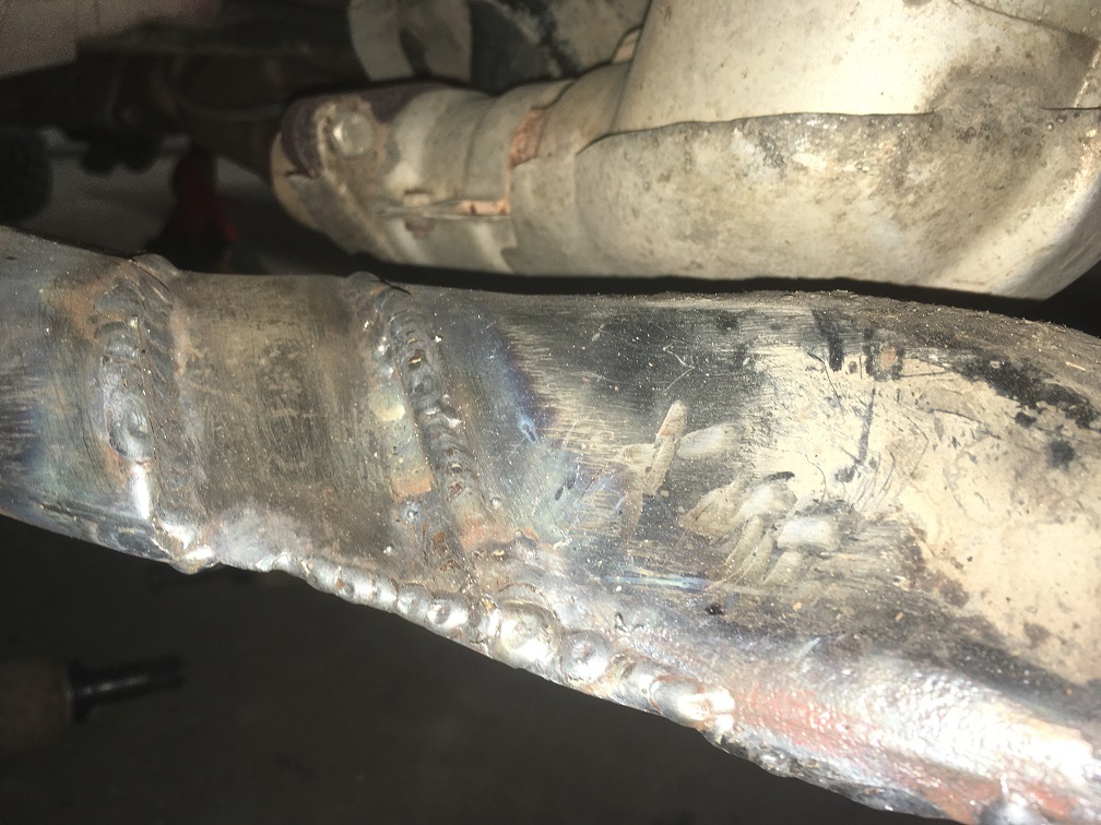

Hard to tell in this picture but that rear strip (left) is about half the height it started out at.  I welded another strip on there before we put it back on the car.

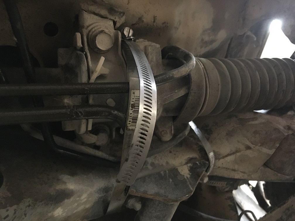

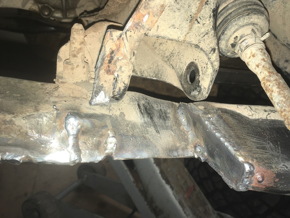

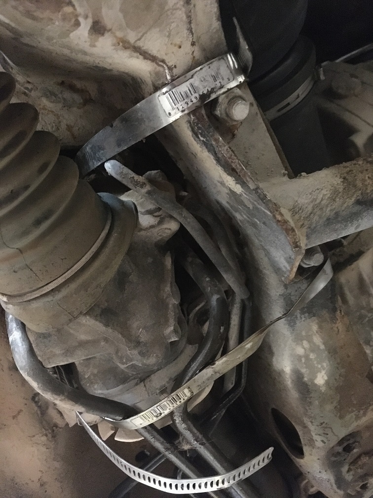

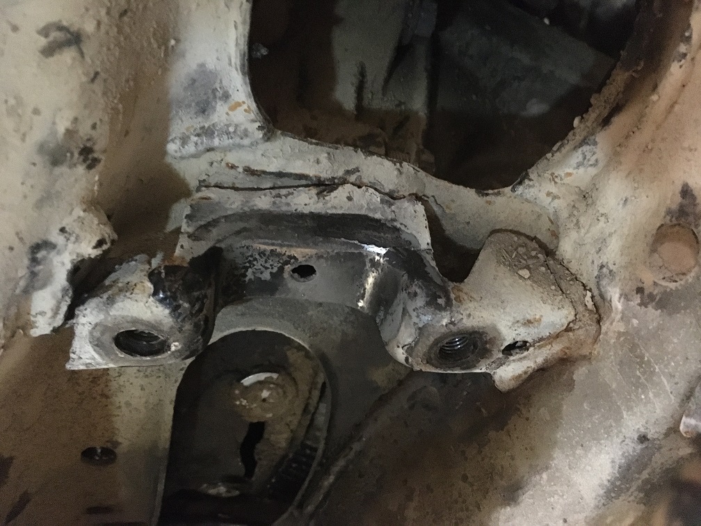

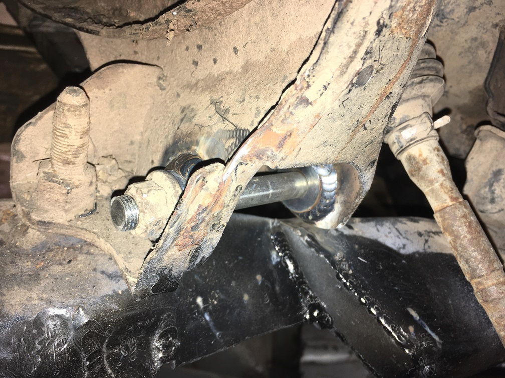

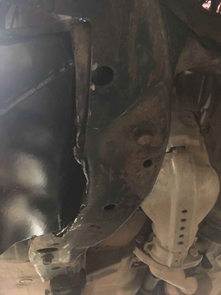

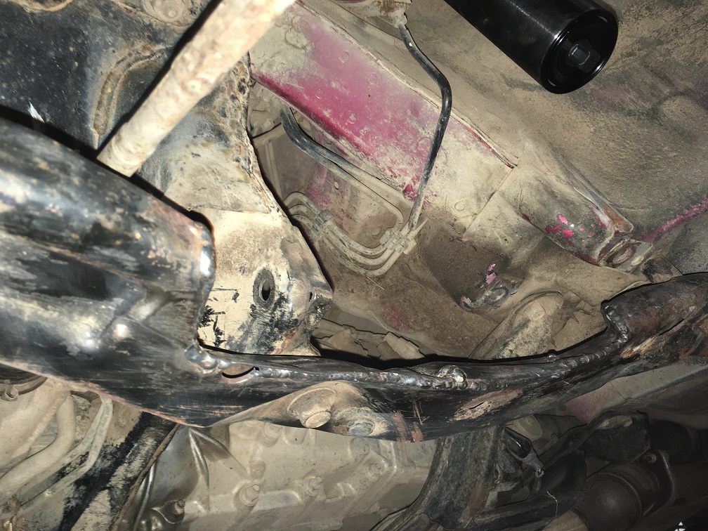

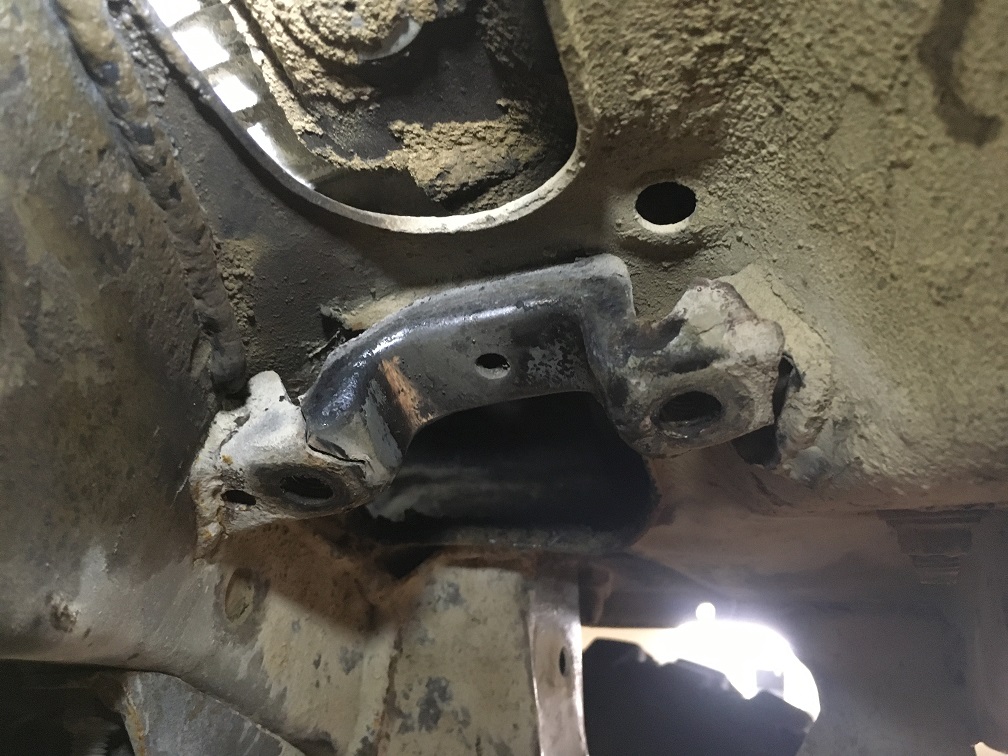

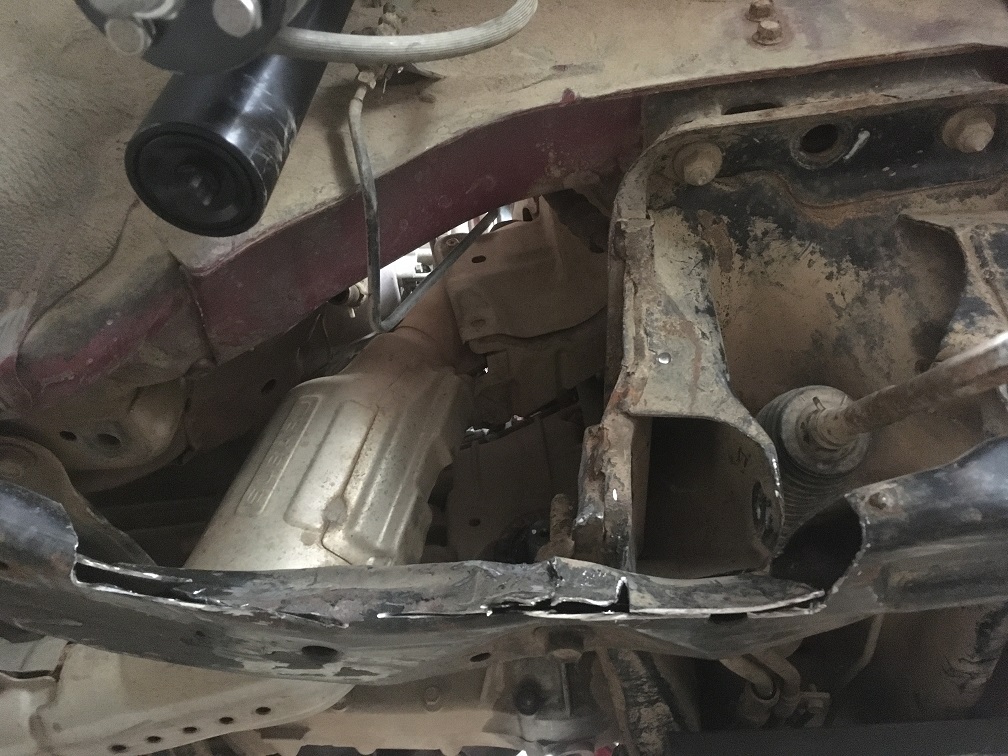

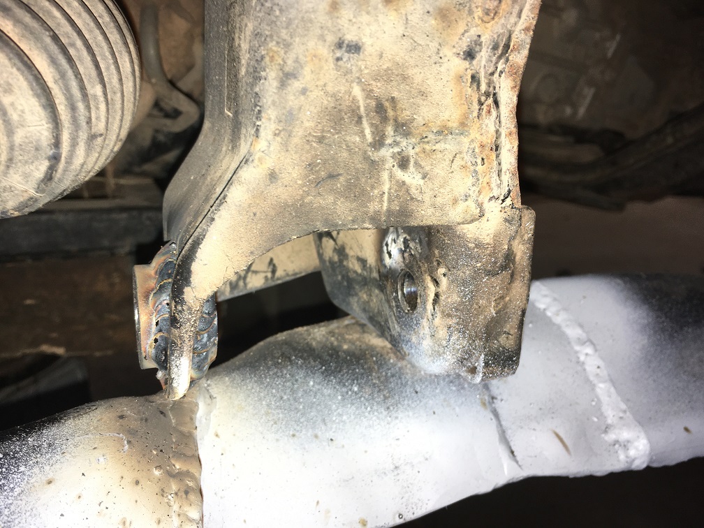

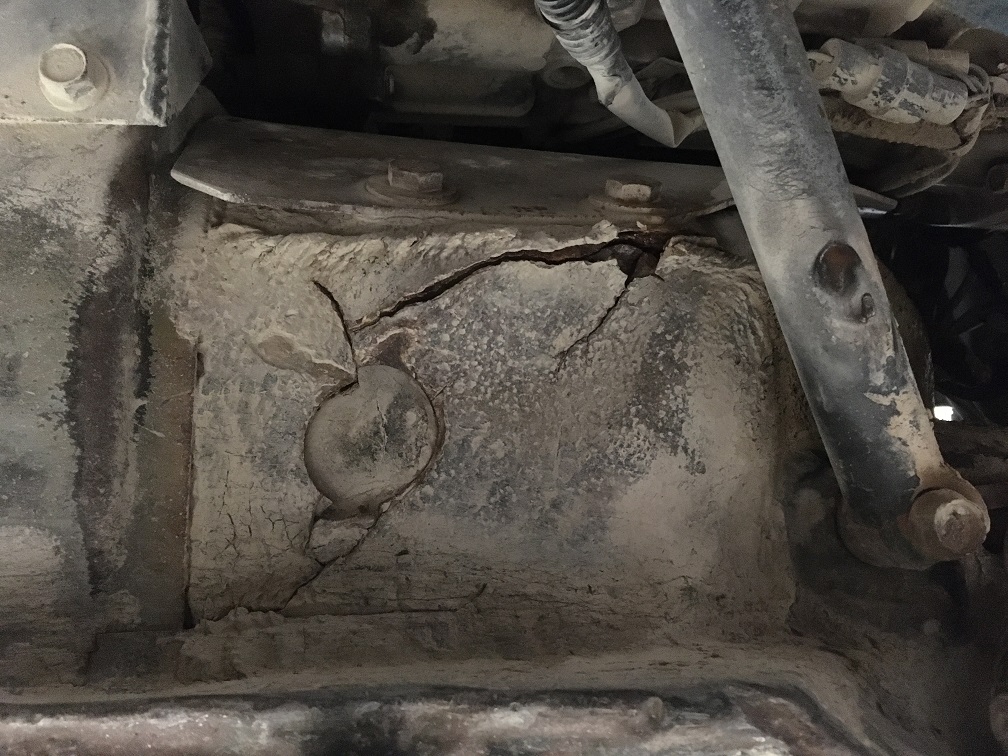

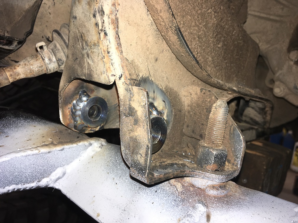

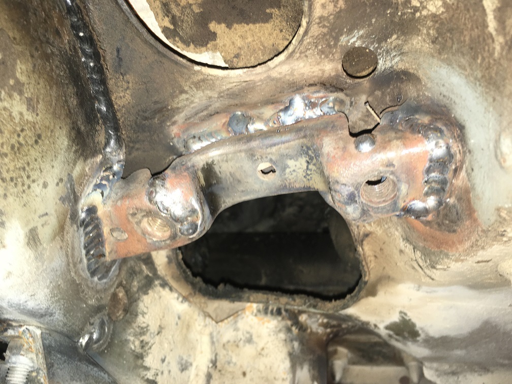

Here was our main structural failure during the race.  Hose clamped the driver's side of the steering rack back in before we drove home.

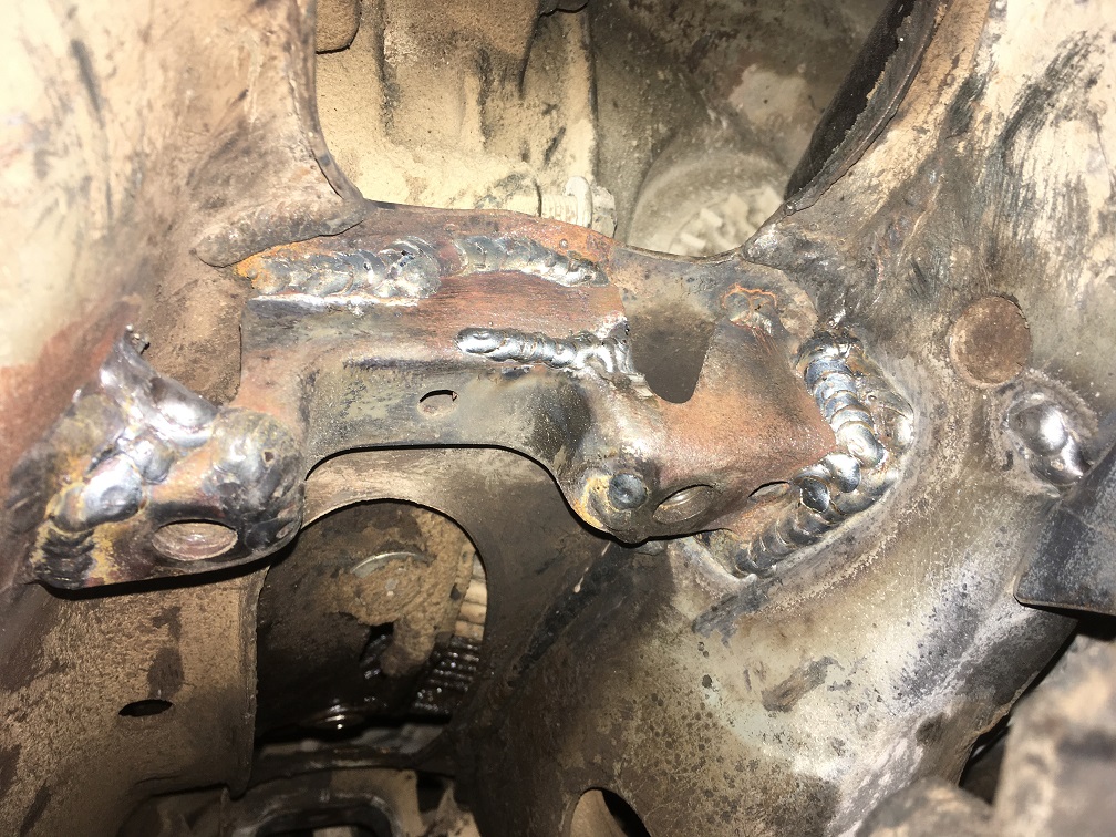

Bracket was essentially disconnected from the crossmember.  The way it cracked it couldn't quite fall out but there was zero weld left intact.
Not pretty but welded it back in place.  Should be good for the life of the car if we don't do any more desert races with it.

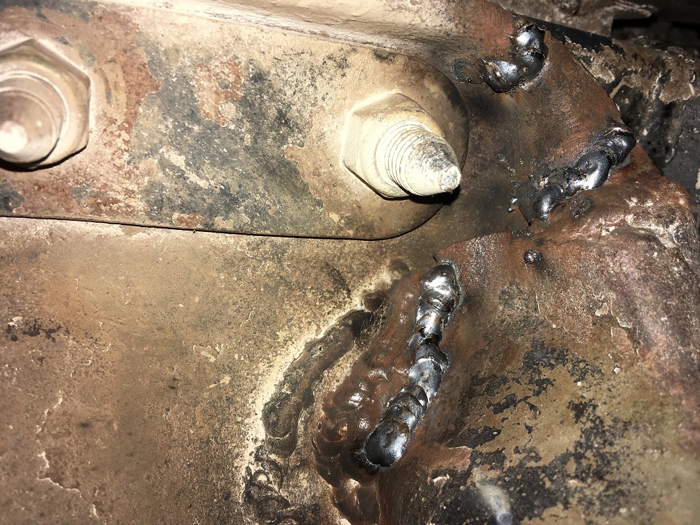

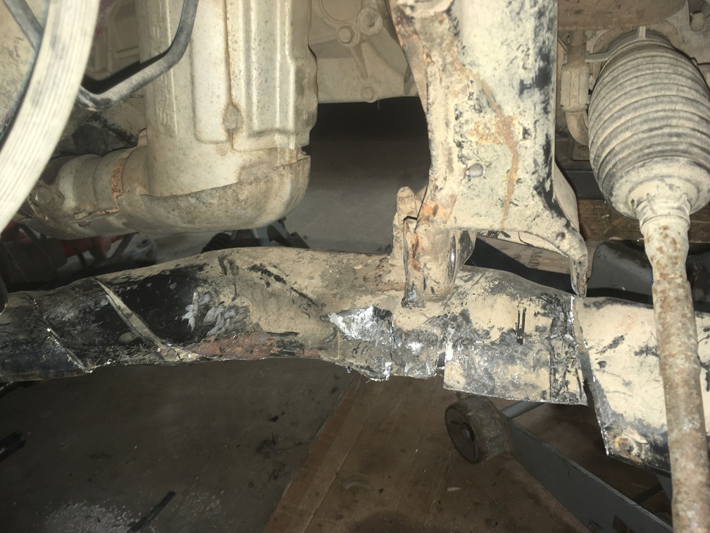

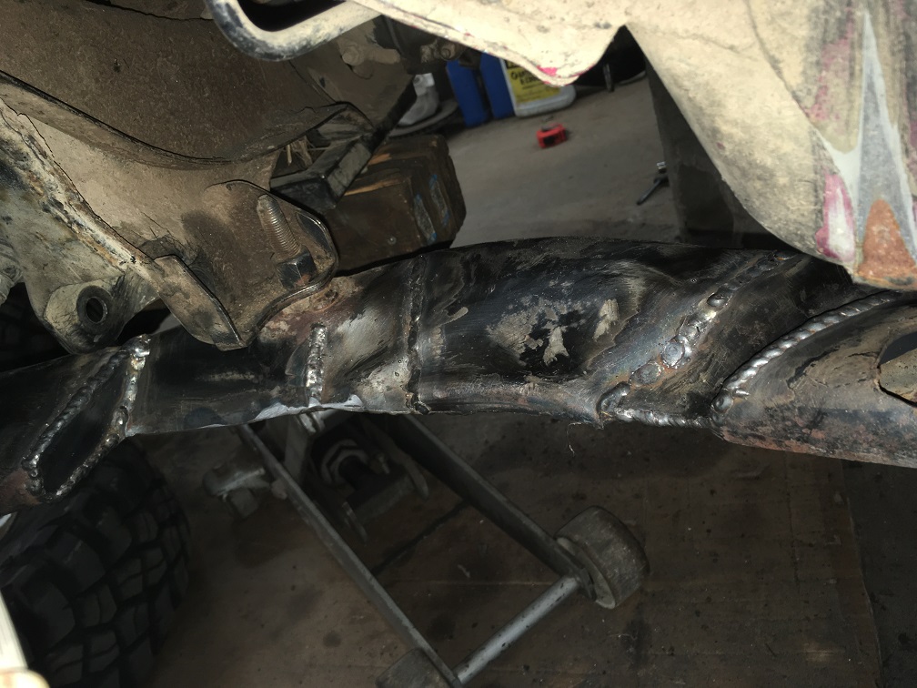

Some of the many cracks I welded up, these were on the front crossmember near the rack mount.

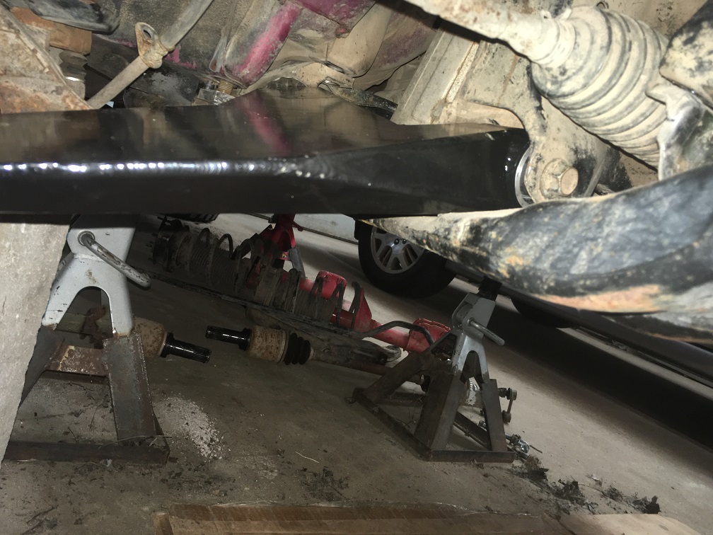

Put in new rack bushings and got the rack bolted back in.

Maybe eventually I'll post more pictures of the 6MT low range but without showing it to you in person or some kind of in depth video it would be hard to explain how it all works.
