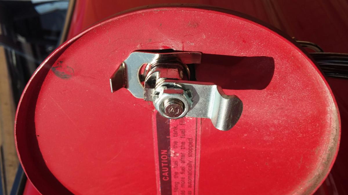

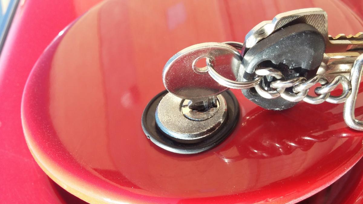

I personally prefer the locking door option.
This last weekend I went to get gas and the locking cap I am using wouldn't hardly come off.
It is one of those that you have to hold the key over to be able to remove the cap and it would't
hardly budge.
If we could trust that no one would NOT come along and try to steal gas or put extra crap in the tank
I would not be near so adamant about keeping my gas tank locked.
I just don't trust STUPID, a lot of them end up dead, not near all of them though.
Here is what mine looks like now, I do need to find a washer to lay between the lock and door.post-38620-0-06925400-1426093126_thumb.jpgpost-38620-0-67394200-1426093146_thumb.jpg
