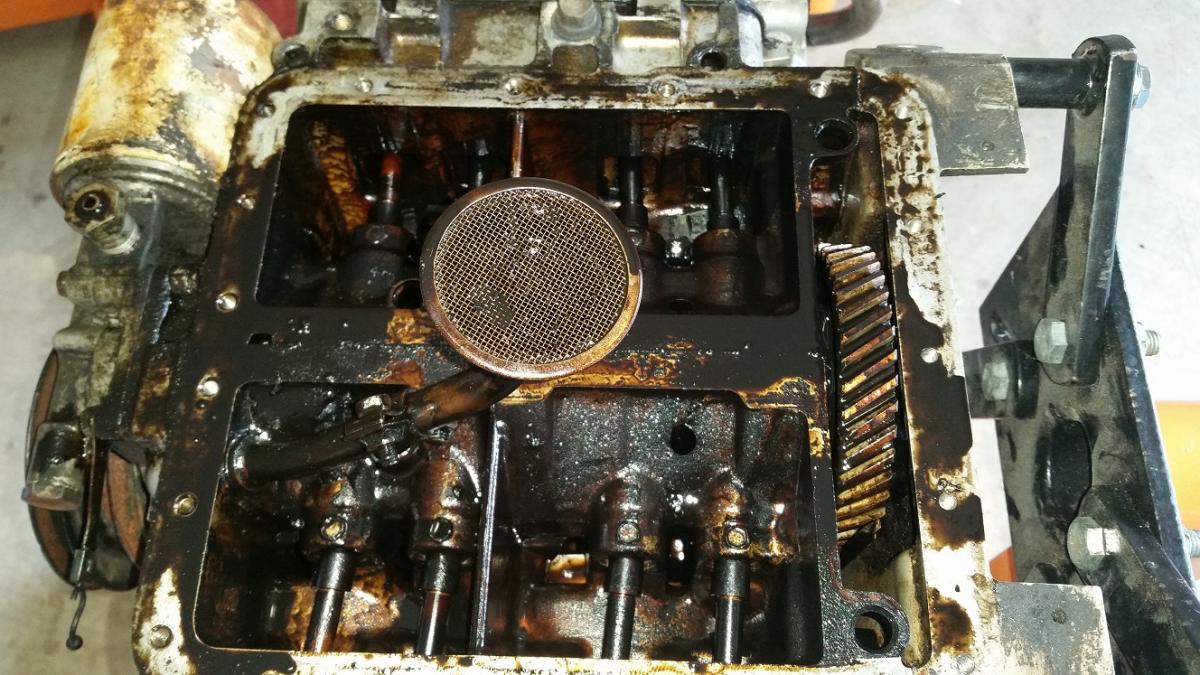

Well, I got a little further today and a couple questions came up. Overall I am pleased with what I saw today. With the exception of a couple stripped bolts on the exhaust manifolds things look good. The cylinders don't show any pitting which make me positive about the cam condition. I was thinking about taking the heads to the machine shop, but I better make sure the host block is buildable before sink any money into the heads. I have no idea what a ready set of heads are worth should I get stuck wish them. Anyway, can one kind guru help a newbie with these questions?
1. How do I get the oil pick up tube out? I tried everything I could think of.
2. Can anyone tell me what distributor this is?

Personally Ide leave the pickup tube in. I realize the o-ring is tempting to replace but its almost impossible to get the tube out without damaging the mating surface. If you must u need a soft metal chisel. Unbolt it from the block (do not loosen the clamp its needed for proper alignment). Hit it HARD on the o-ring flange right where it sits slightly above the oil pan mating surface. Keep ur chisel as true with this surface as possible, or you will crush the tube. You will have to file the nicked edges down, as I said it will get damaged. Reinstall requires some time in the freezer....
