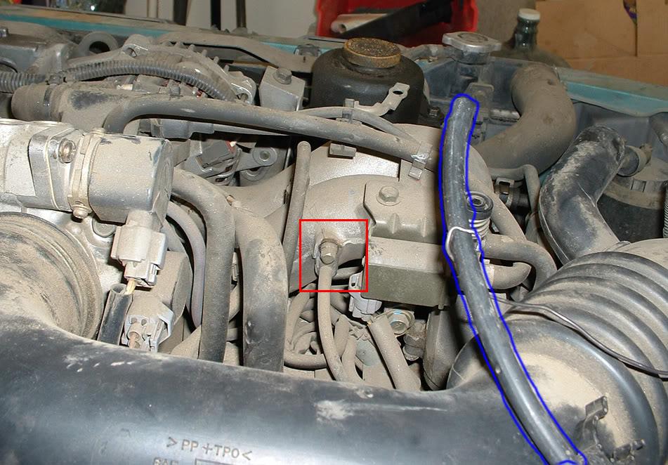

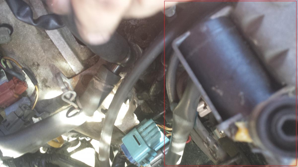

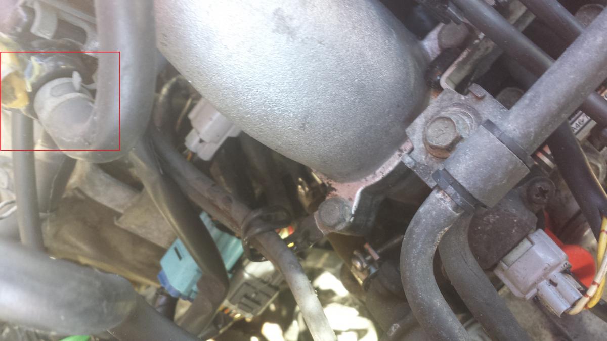

pchafin Posted October 16, 2015 Author Share Posted October 16, 2015 Ok, here's where we are. I have an ej22 block and heads being run by a 95 obd1 in a 95 Impreza. To the best of my ability, it has the ej18 im. With the im inverted this morning, I found a vacuum type sensor with no electrical plug. This sensor is on the right rear of the im, had two vacuum lines and has what appears to be an Allen key adjustment on top. I need to research this, because it wasn't connected electrically. I found no obvious damage or anything suspicious inside the block. However, the engine is quite anemic, losing significant amounts of acceleration past 4000 - 5000< on the tach. This rpm limit does vary. I believe my problem is logic-based, because the computer is not receiving complete information. Timing also keeps slipping, every time I reset the timing belt. Quote Link to comment Share on other sites More sharing options...

Fairtax4me Posted October 17, 2015 Share Posted October 17, 2015 (edited) Ok, here's where we are. I have an ej22 block and heads being run by a 95 obd1 in a 95 Impreza. To the best of my ability, it has the ej18 im. With the im inverted this morning, I found a vacuum type sensor with no electrical plug. This sensor is on the right rear of the im, had two vacuum lines and has what appears to be an Allen key adjustment on top. I need to research this, because it wasn't connected electrically. I found no obvious damage or anything suspicious inside the block. However, the engine is quite anemic, losing significant amounts of acceleration past 4000 - 5000< on the tach. This rpm limit does vary. I believe my problem is logic-based, because the computer is not receiving complete information. Timing also keeps slipping, every time I reset the timing belt. You need to replace the tensioner piston. It's damaged internally, and isn't holding pressure against the belt correctly. Solenoid is the evap purge control solenoid. Should have been hooked up. There shuld be a metal tube under the manifold that runs from just below the fuel lines and comes out under the manifold sticking out toward the right front corner of the engine bay. That's the evap line from the tank. Should have a line going from the tube to the round charcoal canister mounted on the frame rail. Then another line from the canister to the solenoid. Then a line from the solenoid to a nipple on the manifold either on the back of the number 3 runner, or to the top of the throttle body. Power loss could be fuel pressure dropping off, clogged cat maybe, or could be because timing keeps skipping. Edited October 17, 2015 by Fairtax4me Quote Link to comment Share on other sites More sharing options...
