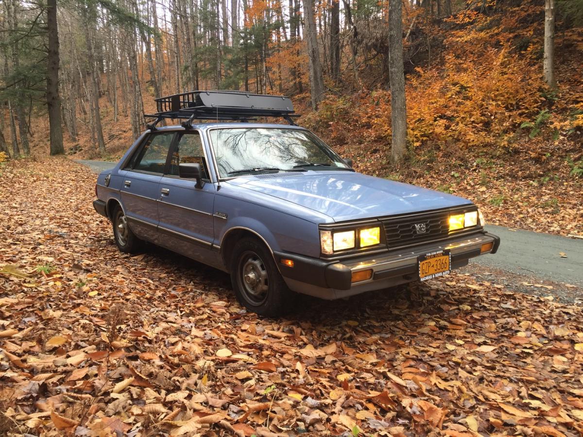

Well I bit the bullet and bought the Weber for $320. Also bought new plugs, wires, cap, and rotor while I'm at it. I should be getting the parts next week and let you all know how the install went. Here's a picture of her in Vermont.
