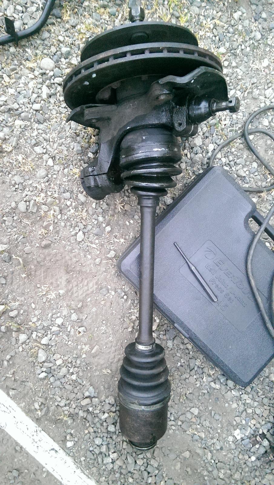

Tried setting the weight of the car on it to no avail. Ended up removing the whole knuckle with the axle attached. Was able to get the ball joint in with some encouragement from my medium BFH, but now I can't get the castle nut off the ball joint stud! It doesn't look like I damaged any threads while installing, but the stud spins around in the joint while I try to remove the nut.
Did I damage the ball joint if it spins/moves like this? Doesn't have any up or down play but it does move more freely than when it came out of the box.

Ok so lesson learned, never hammer on the end of a bolt or stud you're planning on using again. You've mushroomed the threads and now the nut isn't going to come off. File it down flush with the nut and you might be in business. A pneumatic impact would help here... Whatever you do, don't grab the taper with visegrips or it'll never seat right. Try to get the nut threaded further on to free up some working room on the threads. Threads aren't meant to take impact, so when you get the nut off make sure they aren't damaged.
Also just a caution, don't pry open on a pinch fit like the subaru knuckle, when I worked in a shop I saw more than one guy break one of the ears off.
