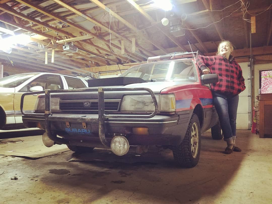

Tons of updates, but no pictures at the moment.
The car is now sporting a 6 lug swap. I have also added the accord rear springs. Up front I made my own 2 inch lift blocks and will also be adding the Ford tempo springs as documented in Jezek's write up. I have also added a winch to the front bumper.

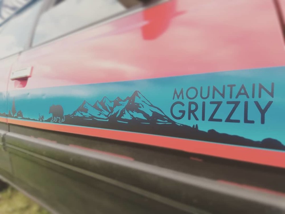

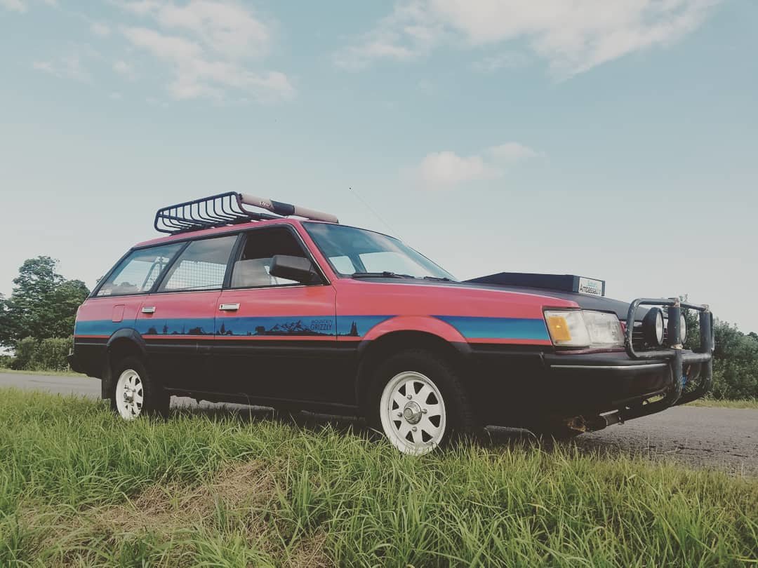

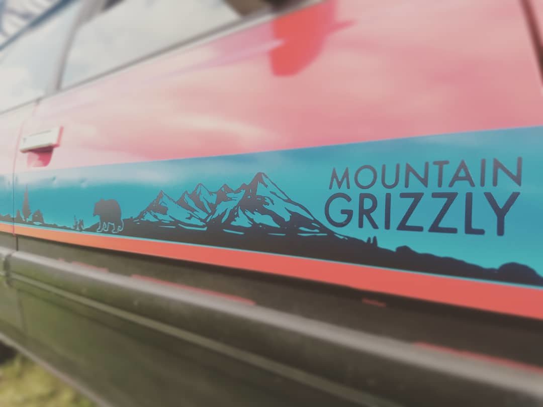

looks good grizzly! i like the stripe and graphics
just an fyi, i just did the spring upgrade on my 90 loyale and will be cutting them here soon. with 2 inch blocks you might be good. love the stiffness they give to the ride though, feels much better
Share this post
Link to post
Share on other sites
Why have you decided to cut them? Are they just too stiff?

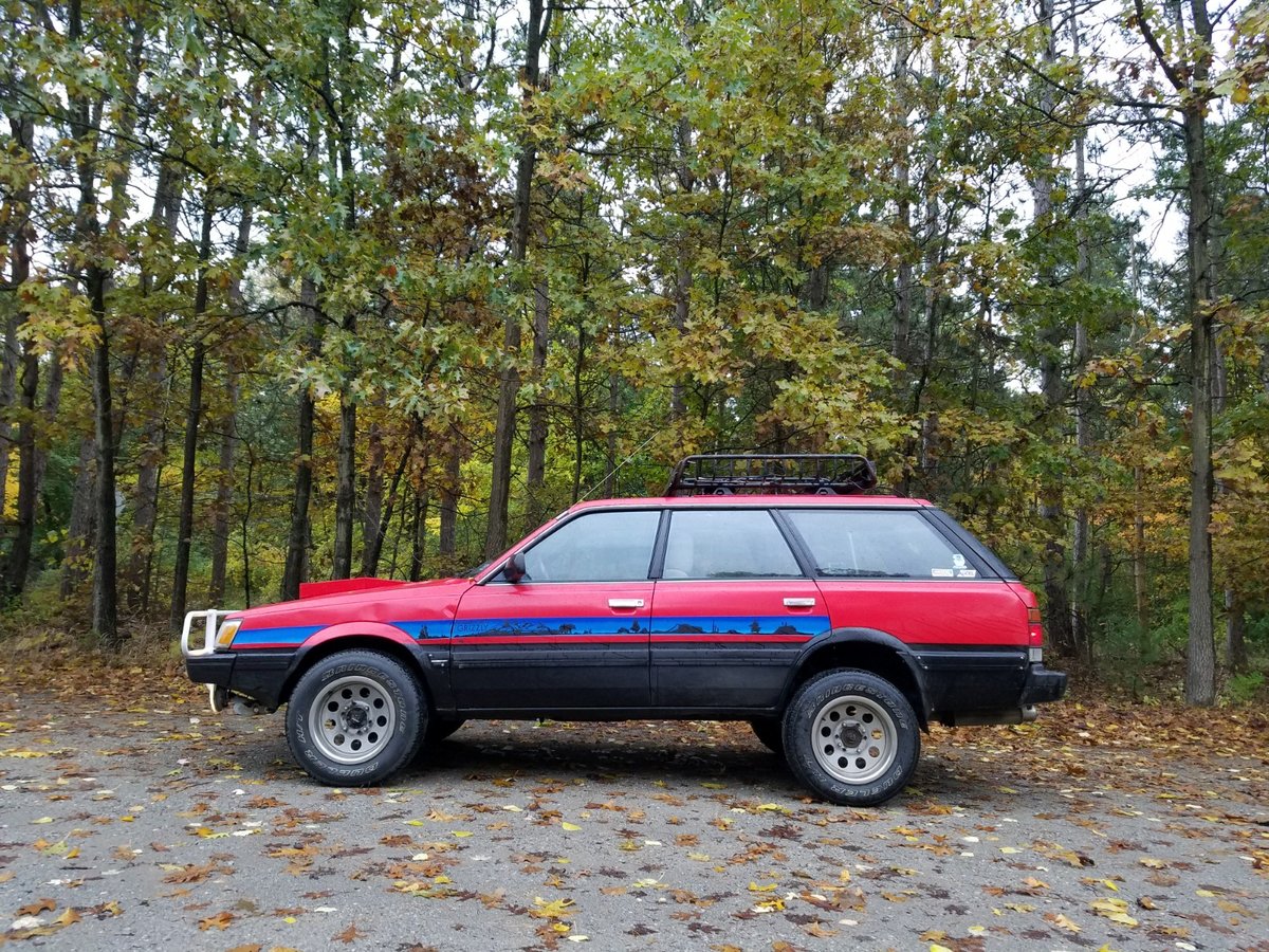

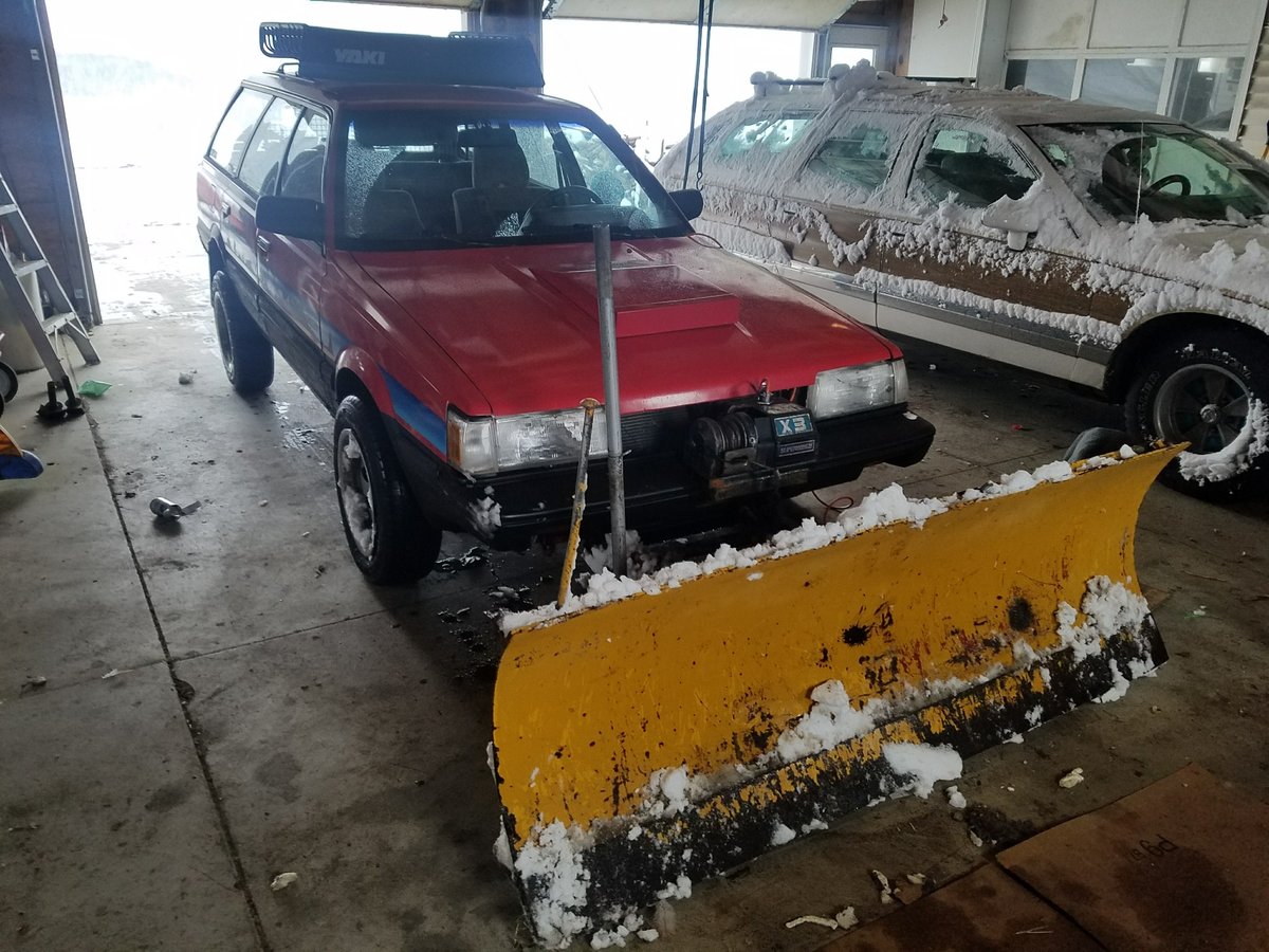

Here's a almost current pick with 205/70/15 tires. I have since swapped to a 185/65/15 winter tire.
I hope to have the new front springs on Monday evening. Then I can finish up building the snow plow set up.

not so much the stiffness but i have 4 inch blocks so camber is off a little. i thought for sure with some weight and settling that they would be good but not so far. i havent cut them quite yet though.
*rereading your post, i think youll be fine with 2 inch blocks.

I ended up installing my new springs this evening. I did not reinstall my upper strut lift because the stiffer springs make up for them. I actually think the front sits higher now with the new springs than it did with the old ones plus the lift blocks.
The maiden voyage as far as snow plowing was Sunday morning. We had some pretty wet snow, maybe 3 inches. The car was able to push my long drive way without issue. Problem being the antique superwinch died. I have since picked up a harbor freight winch today, but have to reengineer my winch mount and wire it all up.
I also have to build some kind of light bar to mount some headlights and turn signals to get them above the plow when it's raised up.
Overall, I'm so happy and proud of how far this little car has come. It is a true Swiss army knife vehicle.
