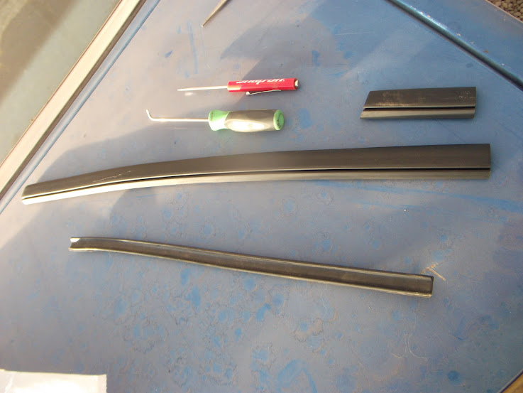

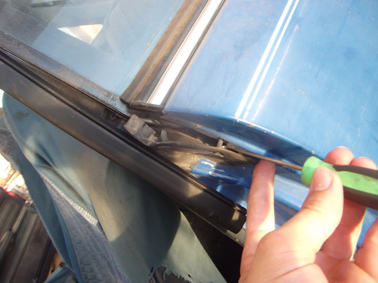

I found these on ebay and they fit perfect. All i did was clean out the metal seal rails with a small flat head, cut the seals to length, then worked them in with the rounded edge of a pick. http://www.ebay.com/itm/New-Metro-Quarter-Window-Glass-Seal-Insert-VS3/391537716170?_trksid=p2047675.c100012.m1985&_trkparms=aid%3D222007%26algo%3DSIC.MBE%26ao%3D1%26asc%3D38618%26meid%3Df40e18573b3e4b399d840be2d82131a2%26pid%3D100012%26rk%3D1%26rkt%3D16%26sd%3D391524456322
