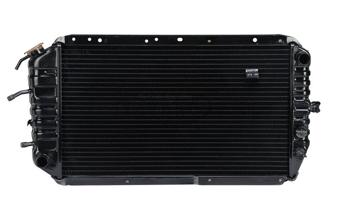

Looking into a new radiator, mine seems to be leaking at the spot where the cap tube meets the radiator as well as a main hose. I'm looking at the one pictured, but realizing mine doesn't have those outlets I labeled in the photo. rather there are just two metal screw plugs. possible to get a radiator that doesn't have these or is this what we are working with now?  Also, what are those for? where would they go?
Thinking I can just cap them off, but seeing as that just adds more spots for a leak to happen I'd rather get one without those. Maybe I can unscrew them and put my metal screw plugs there? any info would be appreciated.

Those are the lines for the automatic transmission cooler. If you don't have an automatic, just cap them with dust covers, and use it. Not a leak risk. I've never seen an aftermarket radiator without them.

They are not open to coolant flow. You do not need to cap them or connect them. Just leave them open. Alternatively you could run engine oil through them as an auxiliary oil cooler/warmer.

Ahhh got ya so they flow separately from the coolant interesting and good news. This radiator looks nice too (all metal) what rads are you guys using or do you usually run?

The first rad i posted is a CFS one. I think it's that same 933 your talking about beech. Doesn't look like the dual row exist anymore new unfortunately or not in the US? good tip on having to grind down the rad a little for the thermo switch. thanks for passing that along. looks like CFS it is.

YnotDIY,
That picture you put up is an earlier radiator to suit the Gen 2/"MY" platform. That's in the Wagons, Hatches and Coupes made from '80-ish through to when the the Gen 3 Loyale/Leone came out in '85. That radiator continued to be used in the Brumby/Brat untill they were phased out in about '92. Think of it as an EA71/EA81 radiator.
Also they are a Brass-copper unit as opposed to an aluminium-plastic one that's in the Gen 3s.
The filler off to the side there is a bit strange hey, theres no other way to describe it in my opinion other than an outright terrible idea as it actually sits lower than the water crossover passage that runs up the middle of the manifold. EA81s have a small water bleed screw that you need to open up when your trying to bleed the system or else you'll never get rid of the air bubble in the manifold. I'm glad they changed it for the Gen 3s.
