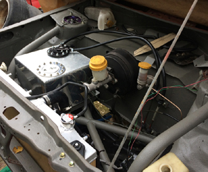

Engine Bay 2
The engine bays looking good. Cross member installed, Suspension installed.
F Boot
The front nearly ready for fuel cell, brake lines,steering lines and still have to put tower to rail brace in.
F Bumper 2
The front is all mocked up and braces for grill and bumper done.
Has a wrx front bumper installed and the brumby grill, still with to front guards to be flared to fit rims and tyres it will line up fine.
I no the gap looks bad between the guard and bumper but trust me, when we finish it will look fine.

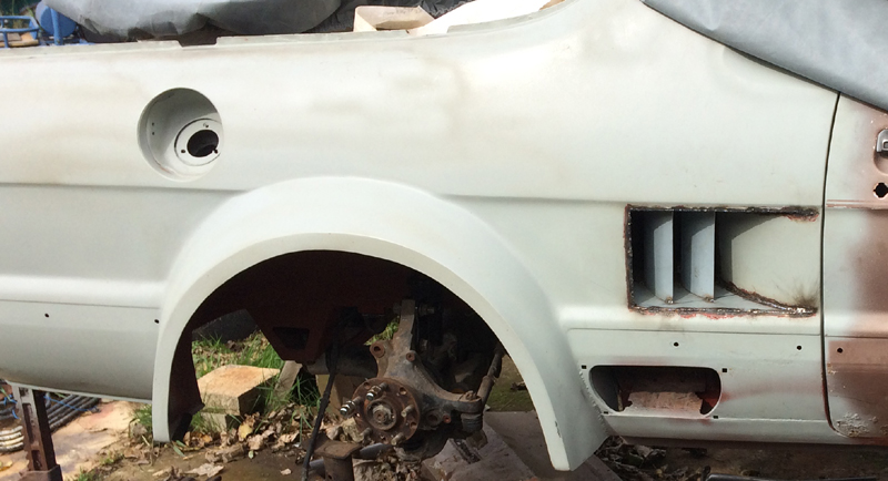

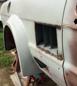

And for the first look at the rear flared guard.
R Guard 3
Still some work to do.
Not to sure what to do at the front lower section of the guard,
but a spoob load or cardboard and tape will come up with something.

Looks good mate!
Rear flare: thought of a 70's inspired inverted duck tail upward "scoop" from the lower body edge up to meet the flare?
With some sort of similar scoop on the front end, either the flare or the front bar, it'll look schmick I reckon!

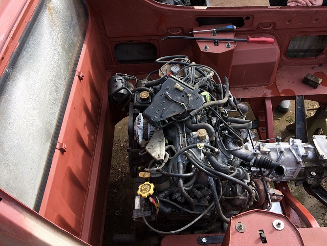

well its been some time since the last post.
Weathers been a bugger.
But now at last thing are moving forward,
Check it out
246028265_BrumbyRside.JPG.832f60ff3933fcc3b43fc73ca242d756.JPG1027240338_Brumkbyengine1.JPG.b639052b91113554bd90d71a3b9626e3.JPG882105513_Brumbyengine2.JPG.05e9db61cc6c1057acb0b39ed515f2a1.JPG

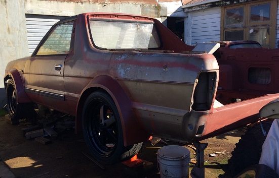

As you can see the front and rear guards are almost done. Still have the front right to do.
Got new Rims & wheels, 18" 235 offset 35. Got some Advan race tyres of a friend of mine who races in the NZ v8 ute series for $50 each.
He gets new tyres all the time so he has always got some in various states of  life, but for mock up these are fine.
Thinking of fitting running boards. Have made some cardboard one's and they don't look to bad.

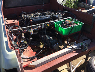

And yes the engine is in place. Almost room for a boxer 6. I think about 150mm to fire wall, of the top of my head.
Still have to make rear gearbox mount, but have a plan in place for that.
But starting to look good.
enjoy

That car should be a blast!
You could definitely fit an H6.  The EG33 is only an inch or two longer (25-50mm), the EZ30/36 is less than an inch longer than the EJ.
It is probably much too late in the build for this, but can you lower it?  What do you need, 50mm ground clearance?

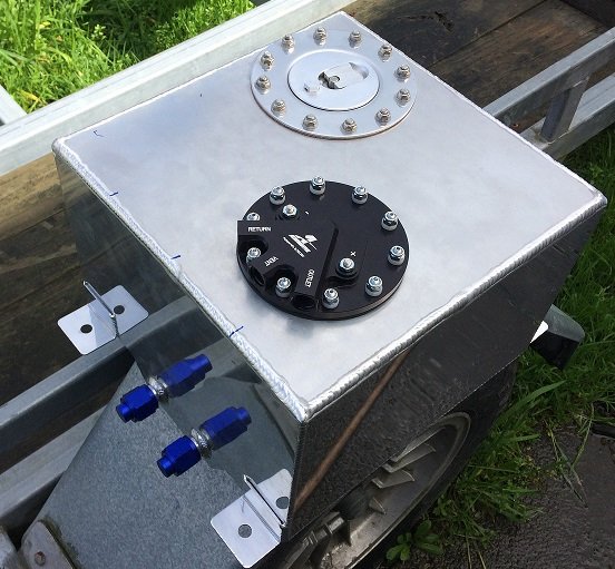

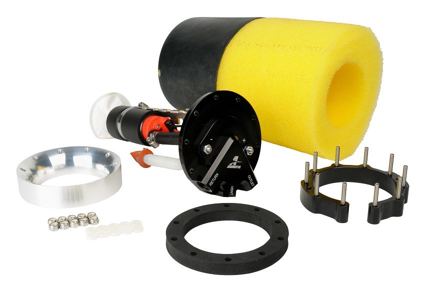

Got a 19ltr fuel cell. Had the filler in the middle of it, so have changed it to fit the aeromotive phantom in tank fuel
pump with buffer. cool little unit and should pump 400hp easy. More than we need to start with.

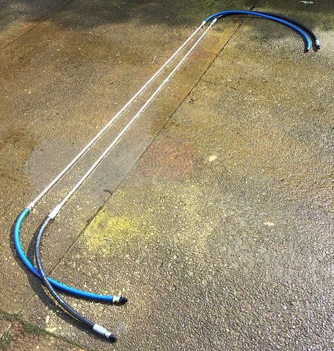

Also have had some power steering lines made up to go under the car.
I have a 3d printer so I'm making up 4 custom twin mounts that hold the power steer lines in place.

o yea. The phantom system I'm running.
I thought it would be easier to run this system than the 3 pump surge tank systems around.
