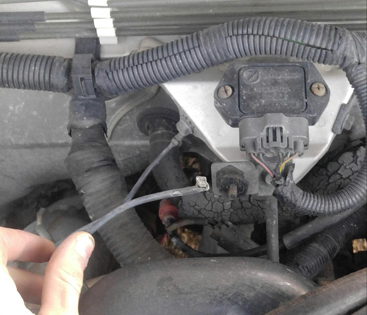

Update, I replaced the Knock sensor, crank positioning sensor, throttle positioning sensor, ignition coil, and every relay in the box. Checked my timing belt and it's still new looking. It still won't get spark in any cylinders. I tracked down nearly every plug and wire to see what could have happened. I found one bad ground coming off the middle of the firewall but couldn't find where it went to. So very stumped about what is going on.

This is the only ground I could find that was not attached to something. Where does it go? I tried to find where it's supposed to lead to but I couldn't find it

I don't know where that goes..but not clear on why you can't follow it back to where the other end is?...Unless it goes INto a wiring harness?

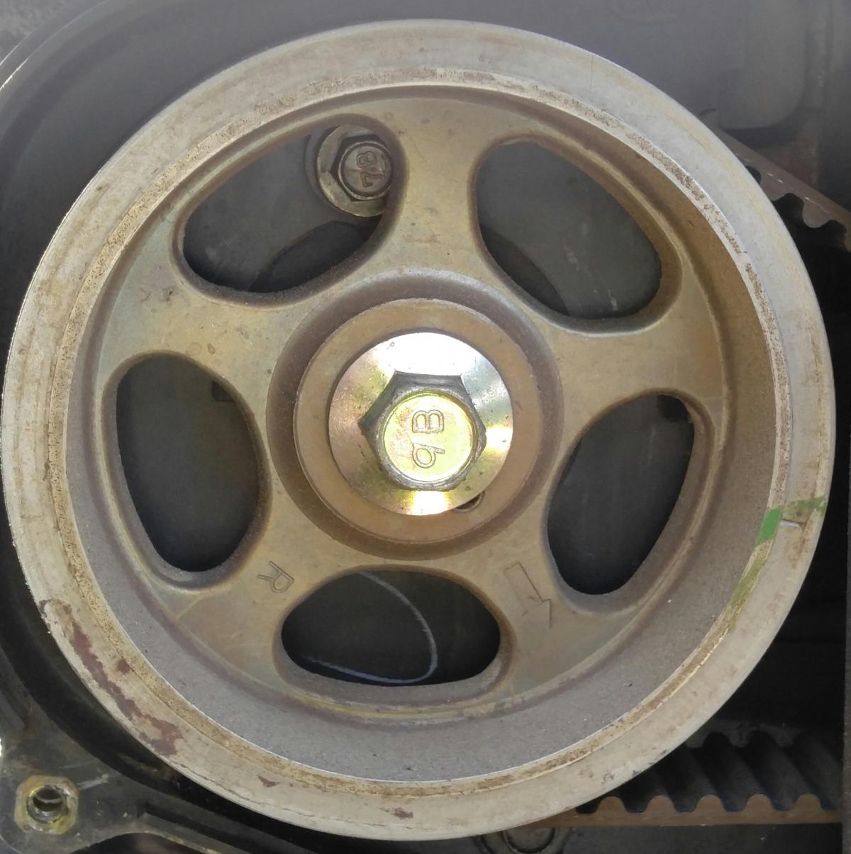

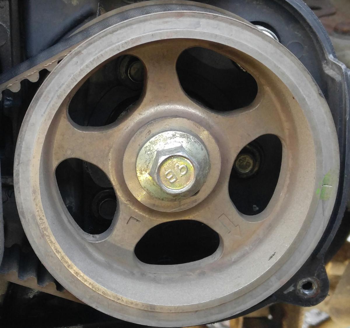

Hash marks correspond to the notched marks on the timing covers for the cams. (block for the crank) They will be at 12 o'clock. The cam pulleys each have double the teeth of the crank sprocket so you may need to rotate further until all three hash marks are at 12 o'clock.

Turn the engine over (by hand) till all the hash marks are straight up. It looks like the cams are probably aligned to each other. But it's typically the crank that skips on the single cam engines (if it's going to at all).

All 3 will be at 12 o clock. Depending on tension/belt stretch I've lined them up with the drivers cam pulley just slightly past (maybe 1 or 2 mm) as releasing the tensioner brings it back a tad.
Take some pics if you're unsure, we can confirm, but if all 3 don't come to the 12 o clock then it's off.
Edited by AdventureSubaru

I set the timing perfectly all hashmarks at 12 a clock and it still only cranks and cranks no start. Very upset that my 3 hours of work and tons of parts replaced in vain. Once I finally get this thing started I'm grandma driving for awhile.
