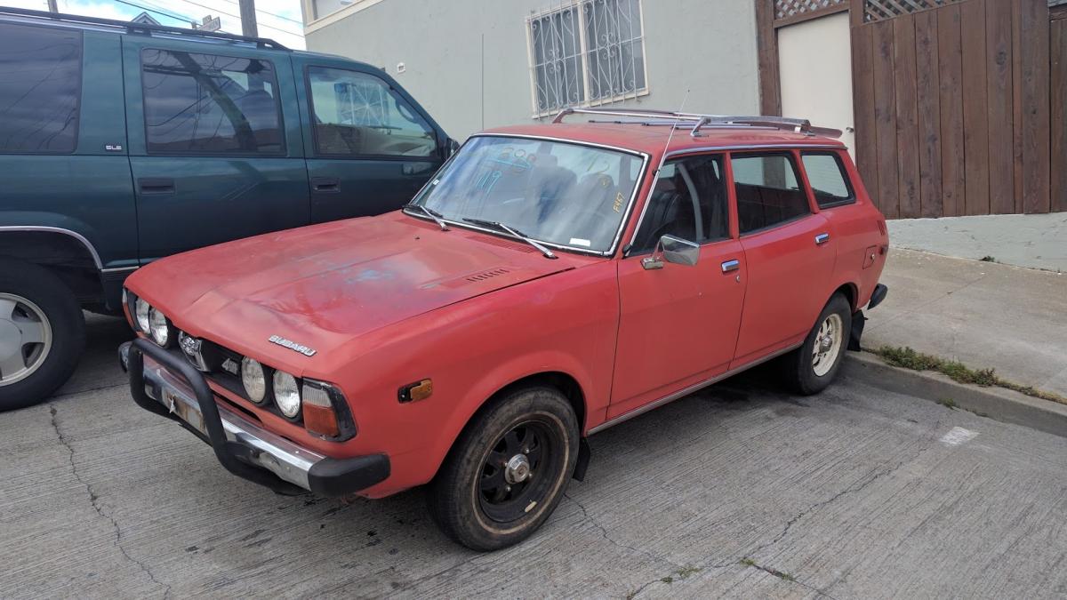

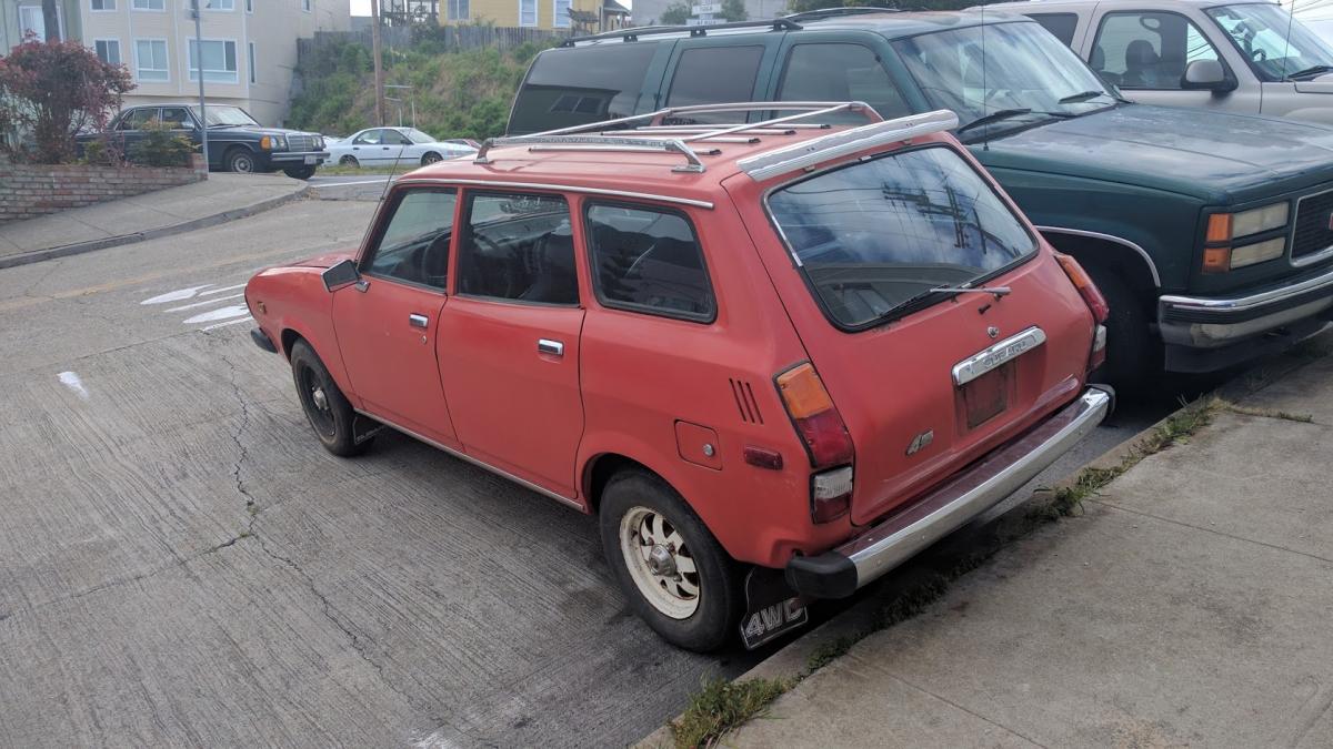

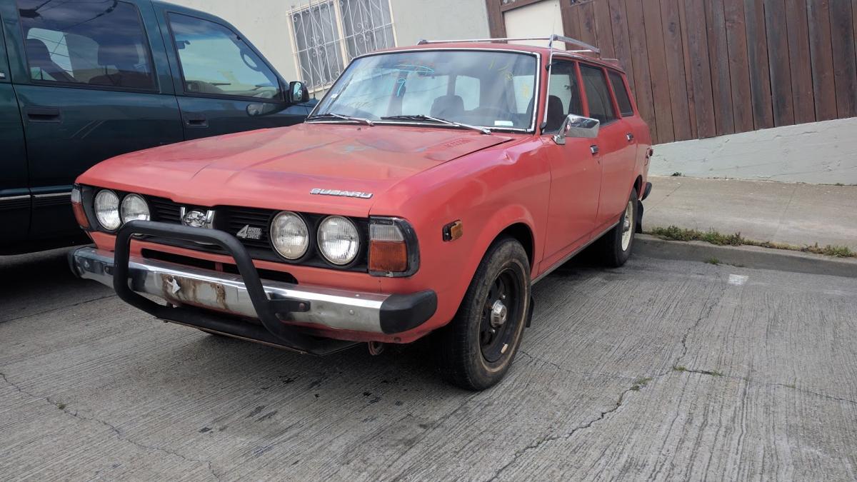

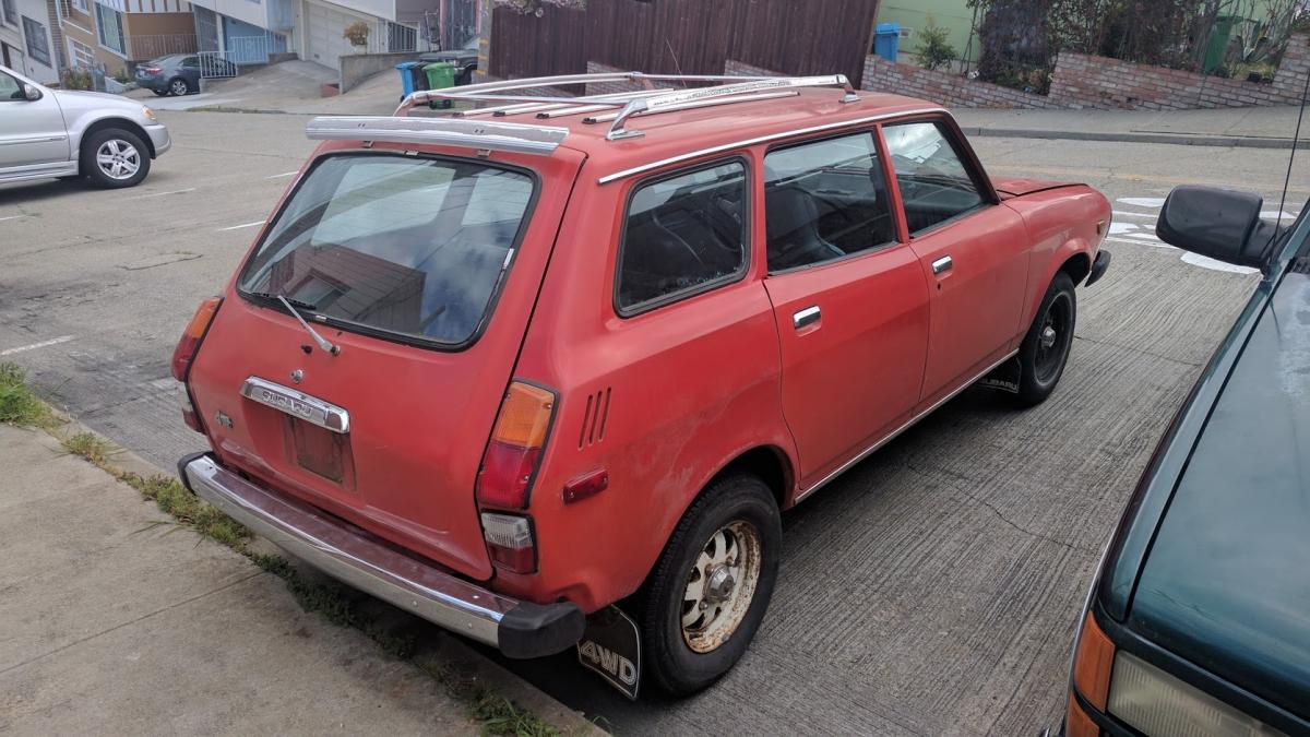

Hey guys! I just picked up 1977 4WD wagon. It is california car without rust, seems to be original paint and interior. Odometer is 8900, but might be 108.
It started and drives, but front drivers side wheel make a lot of noise grinding and clicking (cv shafts and bearings?). Is there a repair manual online?
I got it through the auction so it has lien sale papers and I need to smog it,does anyone has advise on CA smog? i believe subaru did not have catalytic converters right?
I want to keep the car, but need to make sure it is not huge pain to to repair / register. If I can't get it smogged I might consider selling.
any advice recommended. Here is few pictures:
