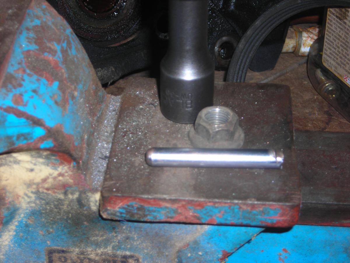

But when picking up my tools, I noticed a metal rod about the diameter of a pencil and 4 inches long on the ground. Only thought is it is part of the ABS sensor, which I removed early on in the process.
Is this rod somehow part of the hub/knuckle/sensor?
Would hate to put all this stuff back together only to have to take it all apart again.

Went out and looked at that rod again.  Little less than 2 inches in length, not 4 inches. One end shows a fresh break. Other end is rounded and looks normal. Don't think it is part of the ABS but what is it?

Caliper slide pin?
I thought that this morning.  Don't recall a slide pin when I removed the caliper.  Went to rock auto and checked some photos of calipers and didn't see a pin.  Have to look more closely tomorrow.  But I do know whatever that pin is it isn't part of the hub/knuckle   and only the caliper is left.
Don't know if this is related but bought the car 2 years ago and it had a brake shimmy.  Replaced the rotors and pads. Little better but the shake still there. Hardly ever drive the car as it's the wife's car and she rarely uses it. We are both retired.
Share this post
Link to post
Share on other sites
The slide pins usually stay in the caliper bracket, but I imagine that's also been removed if you have it down to the wheel bearing.
Did the pin have grease all over it?
Can't get a link to post but rockauto lists it as a "caliper guide pin". Similar, but they only show aftermarket versions.
