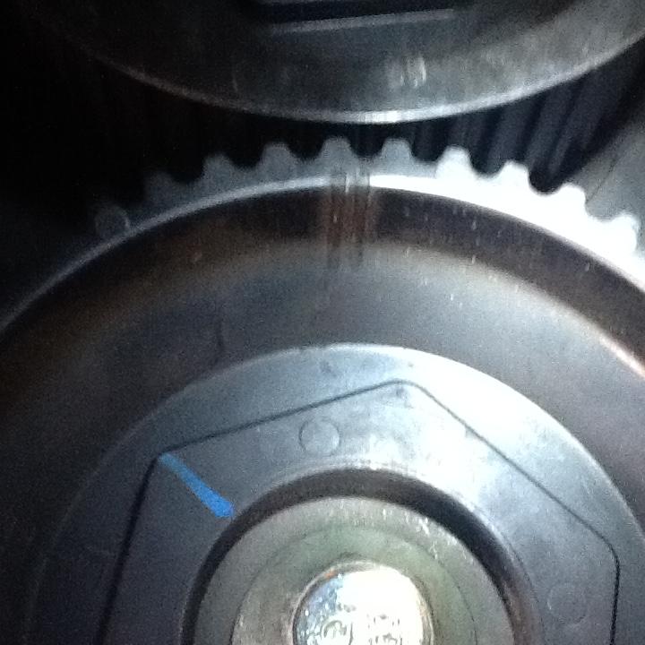

I ended up taking off the belt and decompressing the tensioner. Put it all back together, pulled the pin, all marks looked good.
However, after turning the crank 2-3 times, the 2 marks on the bottom cam drivers side is off by about 2 teeth.
Next time I take the belt off should I rotate the bottom cam 180 degrees? Would that make a difference?
Do you mean the actual cam marks?
They need to line up. You shouldn’t need to do anything different or special. Line it all up, install and pull pin.
I sometimes install without the lower pulley on the passengers side. Then once the belt is on install that pulley, just push up on the belt while installing it and the bolt.
The timing belt marks don’t matter, they only line up every so many hundred revolutions after you install it.

Also, I've been running naked for awhile, and there are no discernible paint or hashmarks on the camshaft pulleys that I can see to properly align them. Do I just need to look closer?

Hash marks will be evident once you remove the timing belt cover and use a good light.  The image below is from a SOHC 2.2L.  The DOHC has different marks so verify if you have the EJ22 or EJ25
These are from the EJ25 DOHC

Thanks Mike 104, I downloaded the FSM. I have an EJ22e.
I learned about "running naked" on this site. The timing belt cover has been removed for some time, so the pulley rims are kinda crusty. I'll likely pressure wash the area real good and try to find my best bright light to help my tired eyes locate the hash marks. I ordered a Dayco assembly kit from rockauto $140.

well, I can't say it's UNIVERSAL, but those cam arrows may very well all be pointing -uh - North-East , when aligned.
keep looking for the marks - should be ' similar' to mike's image posted above or try a google image search, however, EJ22 may be some older marking scheme ???
