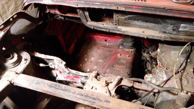

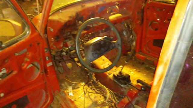

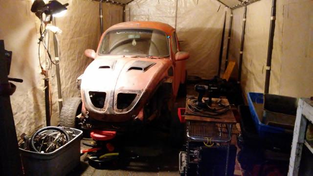

I got this thing a few years ago, traded for some 2x4s I think.. A friend got it from a dude who definitely got it from some people who do meth, but alas, it lives. We got it running, and then it sat for a long while and I decided it needs to get up and go.

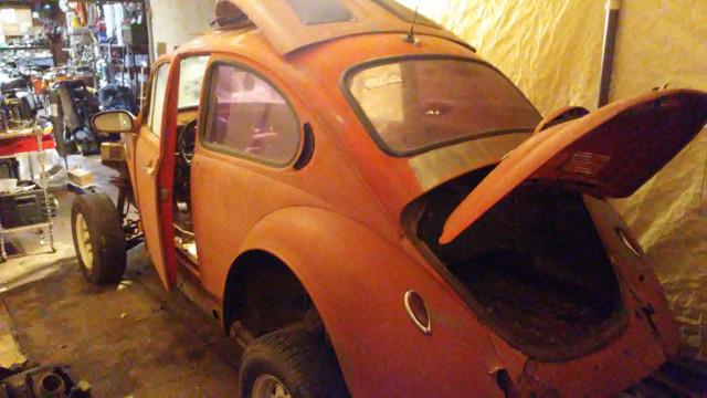

It's a 73 super beetle body on an 86? ea82 hatch tub and running gear, suprisingly the two match up pretty well.
My intent is to use it in the Gambler 500 coming up this July, getting it registered and insured will probably be the most expensive and difficult part...
This thing has the worst fabrication, wiring, and general tweakery I have ever seen hands down, but the proof is in the pudding I guess because it does work.

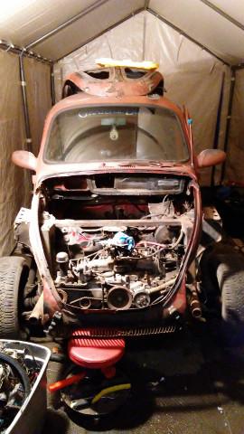

Aside from making it much less terrible in all respects, I have one major obstacle to hurdle and that is: where do I put a radiator???
currently it is air cooled, and I'm sure the ea82 doesn't like that. I would like to put a rad up above the engine and still be able to have a stock hood but are there any issues with having the radiator above the engine and probably slanted? otherwise I might put one out front and add some bumper guard thing but that would look pretty awful. I guess thats the point with the gambler so maybe...
any advice/thoughts whatever much appreciated

I don't know how it can run more than a few minutes at idle with no load air cooled....  Cooling EA82s is the most important thing about keeping them running.  The OEM cooling system was just barely adequate, so start there, as anything less is asking for trouble....

I don't think it ever did more than run for a few minutes to move it around, at least that all I've done. I can't imagine anyone could be quite so ambitious (meaning dumb) as to think you could eliminate the water cooling but I wouldn't put it past these folks.
I have an ea82 radiator that I think can fit above the engine but the piping will be interesting. I'm sure there are aftermarket rads I can buy but free stock parts are what I've got lying around. I'm also leaning toward a garish steel front bumper and radiator in front of the engine. or a rolls royce grill

Yeah, start with the one you have, if it's in decent shape.  Add a couple of electric fans for when it isn't moving.

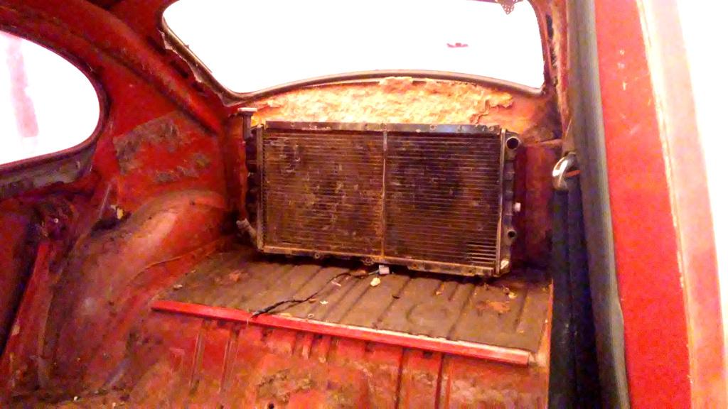

Easy: side mount the radiator on the side wall in the panel behind the seats/under the rear window with air ducting out the back of the vehicle, create an opening to the outside world with a grille/fins/air scoop.
Could run a radiator each side of the vehicle and use an oil cooler in one for the engine oil (if the auto cooler is up for that sort if pressure - cold starting oil pressure could be an issue with that distance to travel come to think of it...).

el_freddo, I like that idea, I thought of using the trunk space but was concerned about long rad hoses, though I could probably use a section of steel pipe for some of the run to avoid too much rubber hose. I'm thinking getting the cooling out of the engine bay is probably going to be easier than stuffing it up front.

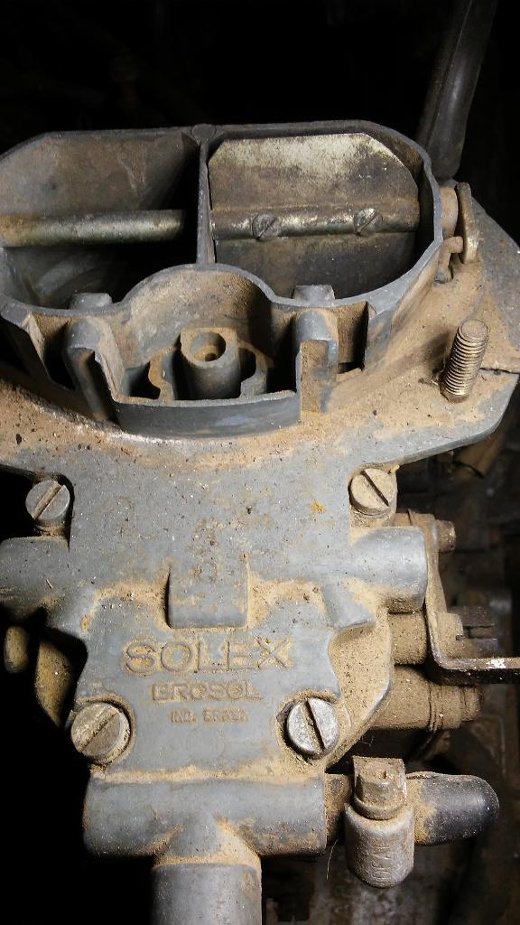

Something I thought was interesting... Apparently a Solex carburetor works on an ea82. I don't know anything about these but heard its a german thing?
that looks like a weber not a solex.
Solex for VW were single barrel.

looks like a weber or weber clone.  probably of the DFV model instead of the DGV model.  same carb but reversed in direction for the throttle and have a slightly different top plate shape.  just look up a weber DFV and you will probably see that it matches.  if it is a DFV most all of the parts are interchangeable such as jets and things that arent direction specific.

I'm leaning toward rear or side rear radiator(s). I have a couple ea82 electric fans that will work and I'm sure I can scavenge up hoses and pipe. this things already got plenty of holes so a few more for air flow wont hurt. I guess if vanagons had the radiator in the front then a bugaru can have it in the back... I've heard of hoses popping frequently on water cooled vanagons but only in the case of having a rubber hose running the whole length of the vehicle which just sounds like a bad idea.
as far as the pan crumpling it's getting an internal cage so that should help.

from a short lookup the carb is a Solex Brosol 2 barrel for a 1.6 litre chevrolet chevette. made in Brasil, motor is either isuzu or chevy. makes sense because this engine had a chevy alternator on a piece of square tube welded to a chevy seat belt bracket and bolted on...
https://articulo.mercadolibre.com.ve/MLV-460293542-carburador-chev-chevette-16-2-bocas-automatico-brosol-solex-_JM

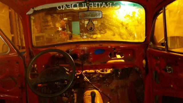

I really need to start working on this during the day, it's so much easier to see... pretty simple, radiator with two electric fans, side ducting to shroud, hot air out the back. might even have room for a passenger.

Several people think the solex carburetor is likely junk and after removing it I can say with my very limited knowledge that is probably the case. Unfortunately I traded away all of my ea82 carbs and would be interested in a weber but haven't come up on anything cheap.
I believe I have everything for a full SPFI setup but that seems like a bad idea from the get go. fuel injection on my 87 GL has always treated me great but in this application may not be worth the work.
I'll read up on Loyale 2.7 Turbo's weber post and in the meantime looking for a used 32/36....
