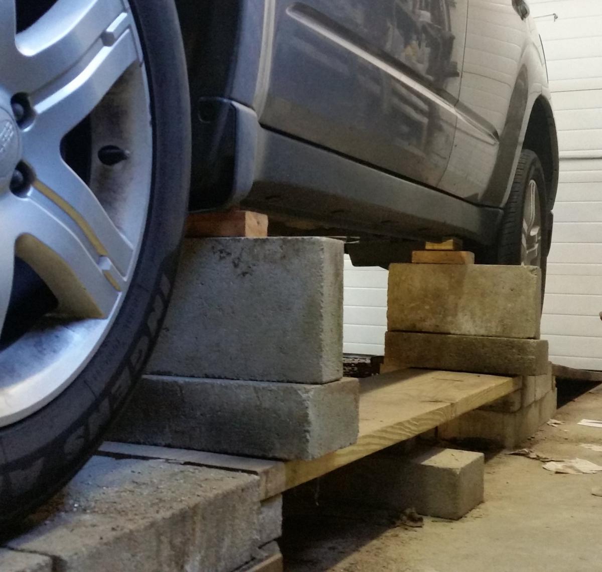

Got the car up off the wheels today. Ran it in gear, wheels spinning.
Nothing conclusive listening through a hose to each hub. Not much via a rod either.

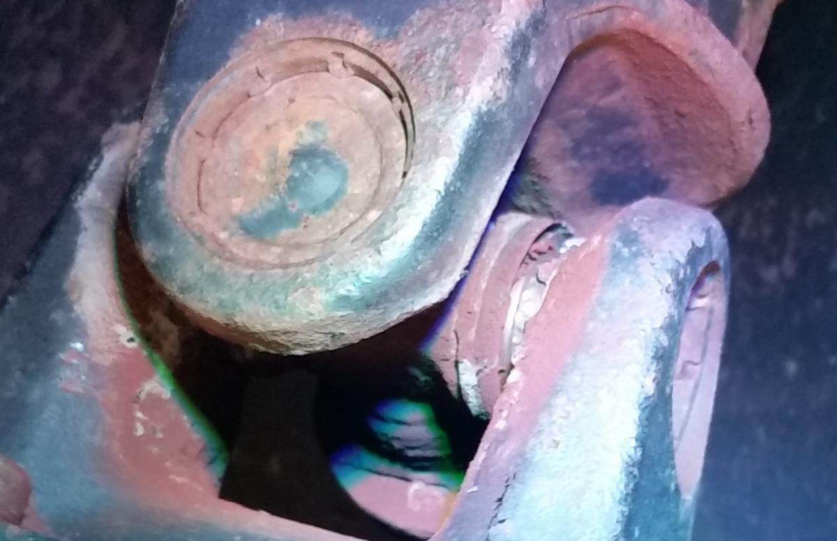

After a while, I did catch a couple mettalic creaks. I checked the driveshaft after shutting it down. On the rear universal joint, one of the cross shaft seals is gone. Bare shiny metal and rust powder. Hmmmmm.
Wheels off the ground -
[note - the concrete blocks used are solid.]
Bad U joint -

Got the driveshaft out tonight.  It is possible to get it out without removing the exhaust, if you can remove the heat shields.
The bad bearing in the picture is really bad.  Has visible play now that it's out.  Feels horrible, like all sorts of chewed up metal in there.
