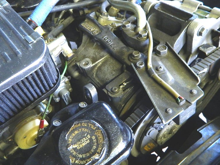

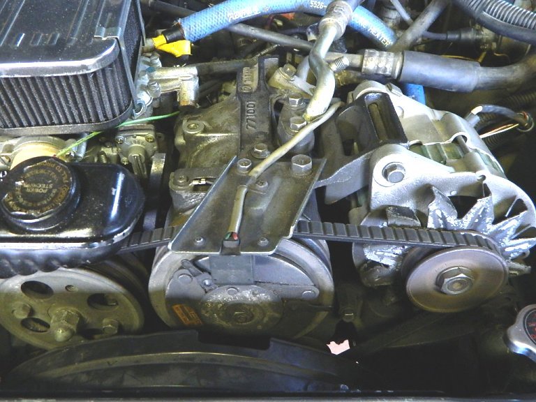

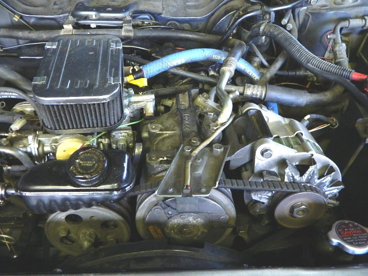

On 8/1/2018 at 2:10 PM, Subarule said:
Here are the photos of my compressor. What do I have, factory or dealer-installed? Or can you tell?
