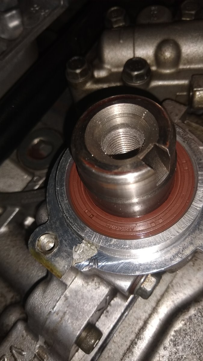

steve56 Posted October 1, 2018 Share Posted October 1, 2018 (edited) Have 06 Legacy. The heads are recently resurfaced. Resealed the cam plate and put in new cam seals.Started dripping from ds cam seal about one drop every five minutes. Reinstalled a new driver side cam seal and have same leak. There is oil on bottom of seal. I thought the cam plate was leaking because there is oil right below the cam seal where the cam plate and head are come together. Have a couple of pictures, but can't really see the oil on cam seal due to not being able to download a high resolution picture on this site. I'm looking for some direction to determine if its the seal or the cam plate that is leaking. The only thing I haven't done is cleaning the came shaft with fine grade Scotch Bright pad to make sure there's no build up on the surface of cam shaft that is stopping the cam shaft seal from sealing properly. Edited October 1, 2018 by steve56 Quote Link to comment Share on other sites More sharing options...
steve56 Posted October 2, 2018 Author Share Posted October 2, 2018 (edited) Had Subaru Tech friend come over. He diagnosed the the oil leak. It was a scratch on the cam shaft that was right underneath the cam seal. The fix is to sand the scratch out starting with 800 grit and working up to a maroon 3m pad. Edited October 2, 2018 by steve56 Quote Link to comment Share on other sites More sharing options...
