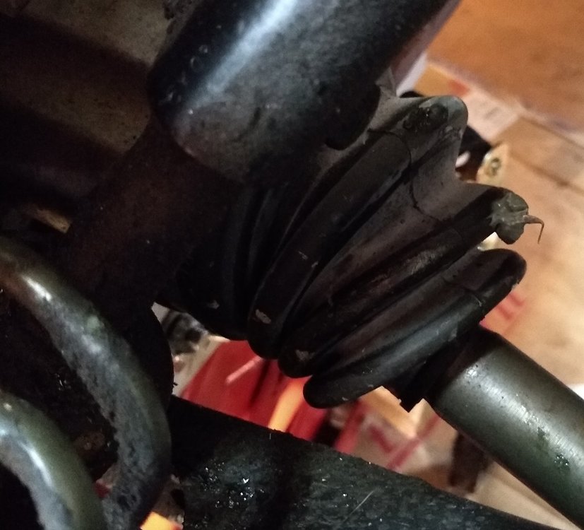

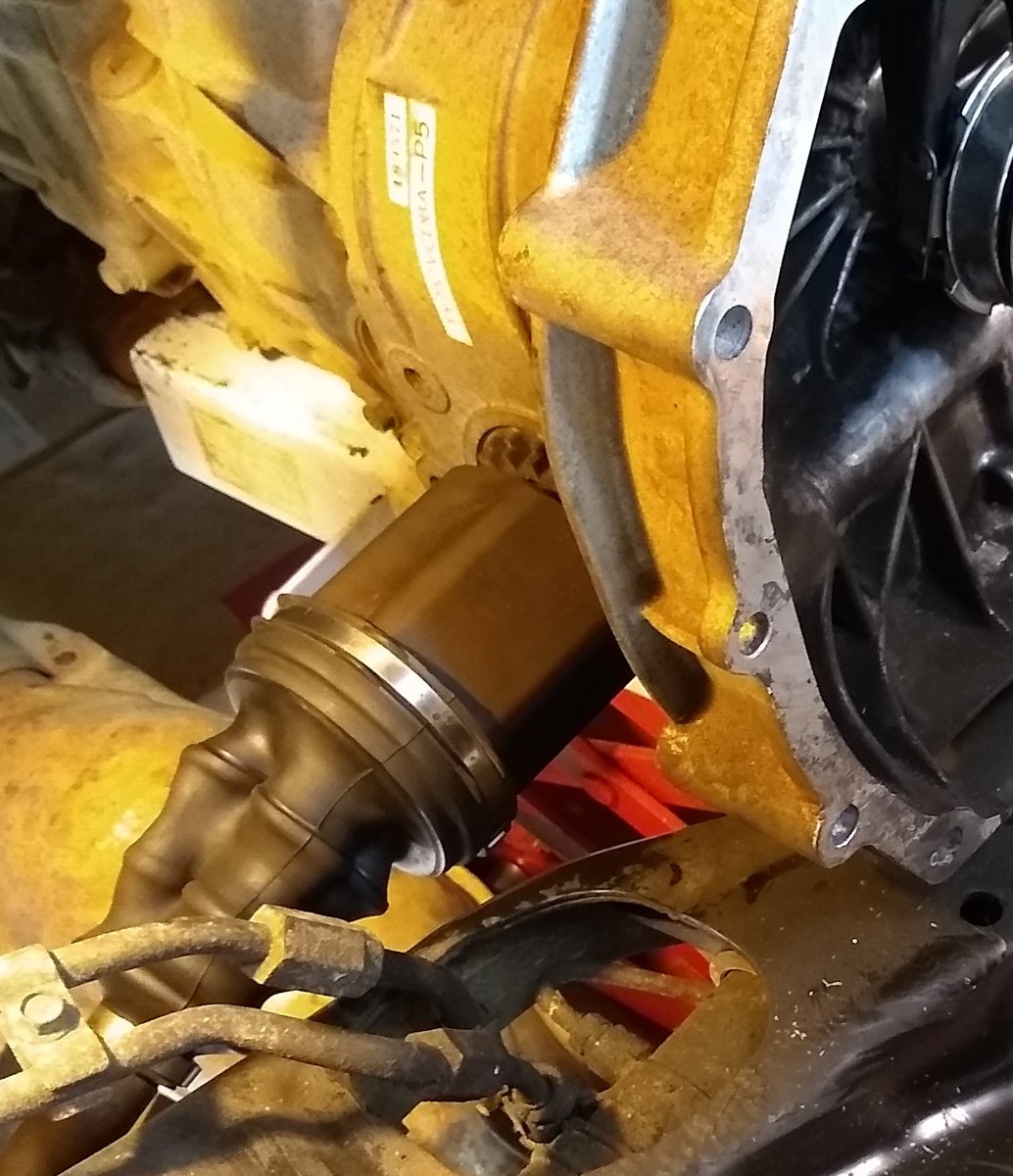

2007 Outback Wagon 2.5 with 5MT.  Engine going back in after head gasket job.  What I am having problems with is both front CV axles are somehow locking, they don't rotate freely.  Passenger side inner joint is all stretched out.  Driver side inner joint was at an awkward angle.  The inner joints don't have freedom to flex 360 like they should.  All wheels off the ground.  In neutral.  Parking brake off.   I tried to stretch the inner joint on an old axle all which ways to force it to fail but couldn't.  These are the new axles with the pin-less inner joints.  FSM says to lever them off the transmission.  PS axle is aftermarket for sure, maybe also DS.  Car is new to me this summer.
Do these axles need replacing or can I just take them out and coax them back into shape?
Some background:  Before the engine removal I disconnected the transmission mount crossmember and supported the front of the trans with a jack, figuring the extra degrees of freedom of movement with the unbolted supports would help lining things up going back in.  Both front axles left in place.  I left the exhaust hanging by the transmission bracket so now picture the front two cats mated to the passenger side straight pipe all loading the transmission toward that side.
During the engine reinstall I tried various pitch and roll changes of the engine and trans to get the bellhousings to line up.  Somehow the trans got into an awkward roll to passenger side weirdness and wouldn't budge.  Pulled the engine back out.  The driver side axle's inner boot was bent at an ugly angle and stuck,  LF wheel would not turn more than 45 degrees.  I finally unbolted the center trans exhaust bracket and then was able to lift up the bellhousing and rock the DS axle into a normal position and free it to spin.  PS inner joint is still all stretched with the boot sucked in.  Sometimes the RF wheel won't turn. Engine is just minding its own business on the crane.  I'm doing all this manipulation standing in the engine bay.
The newer style tripod joint axles don't have any retaining mechanism to hold the tripod into the cup of the inner joint. You have pulled the joint apart. You will have to probably disconnect the ball joint to get some play so you can manipulate it back into the joint. You will just have to play with it till it slips back in.

Well the old dewalt DW292 electric impact got the axle nuts off in less than 5 seconds.  Not rusted though.  Pulled the axle out.  Tried to manipulate the joint to get it back into shape but it wasn't happening.
Took the inner boot off and looks like the tripod style triple-toroid bearing assembly doesn't automatically slip back into the grooves in the cup unless the toroids are at the outer extremes of the center ball.  Just like GD said, there is no keeper mechanism to prevent the bearing assembly from falling out of the cup.  Once it falls out, its probably not going back in unless you can fiddle the three donut shaped bearings back into the cup slots.
Looks like OEM axle has a stamp in small type on the inner cup, "NTN"  grey coated metal.  Engine bolted up ok to trans a lot easier after the axles were taken out.  Lost a bunch of gear oil.  No axle stubs to keep it in like in the 90's.  Well I wanted to change the gear oil anyway...
  • 3 weeks later...
Rebooted the NTN driver's side inner boot.  Drawing shows a circlip for the inner cup but unless it got ground to bits it isn't there.  Tripod is mildly pitted.  I used a Doorman part with a Lisle 30950 band clamp tool.  Disassembled, wiggled the tripod bearings back into the cup, and reclamped the aftermarket inner side.  No problems since reinstalling.
