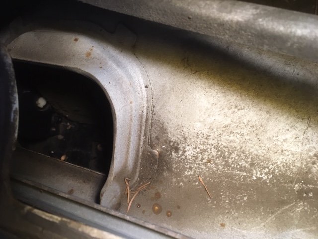

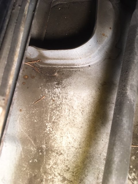

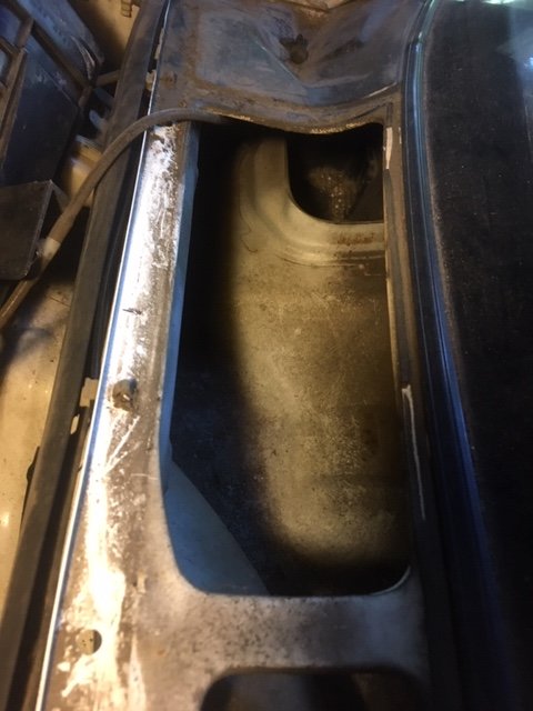

Some photos of the intake ports; I removed the hood, wipers and the 4 center plastic insets holding the two plastic screens in place. It's a shame Subaru didn't screen off those ports. Would keep the drivers side port closed - AC position for any vehicle being stored to block mice access.
