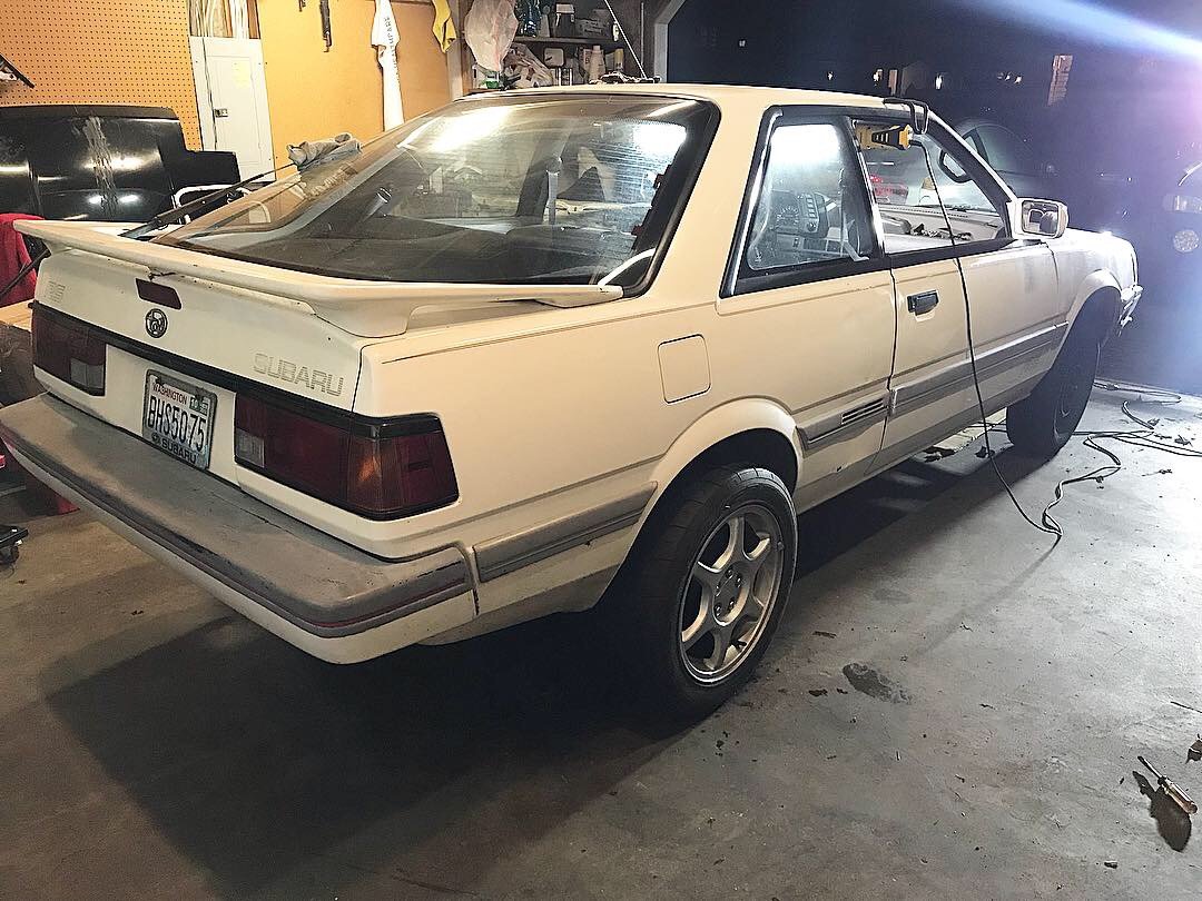

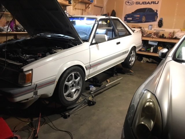

Gotta make a little bit of room in my garage for my neglected G35,

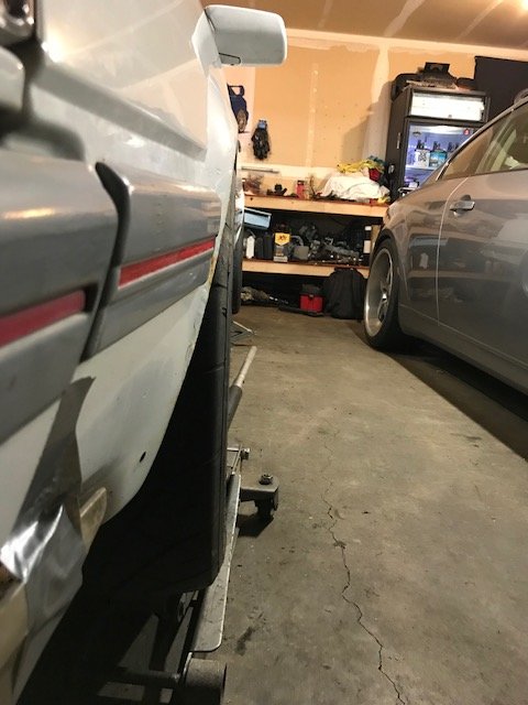

I lowered the car down on all 4's for a Test drive. The track width and wheel size is crazy compared to the front. Cant test the 4wd in this orientation but I can still drive it.
Great news! Drives just fine so far, had it up to about 40 mph no weird sounds wobbles or anything abnormal. Of course I wasn't driving it like a grandma and started tossing it around as much as I could to see if I could feel irregularities or weak points. Seems fine so far and the brakes work amazing. I will be doing something a little different for the front end swap of course he width will match.. stay tuned!
P.s the last image shows exactly where the rear wheel sits because of the pump in width.

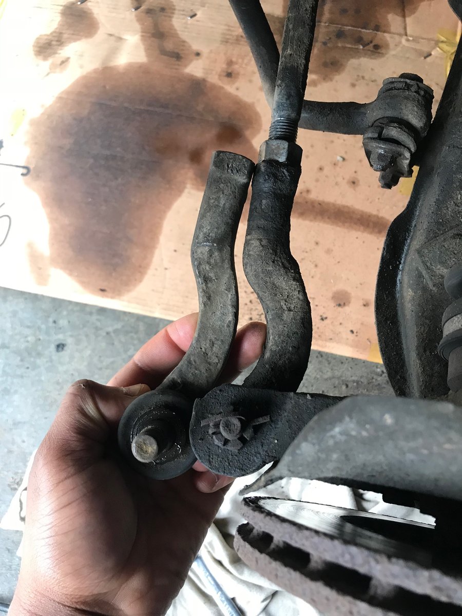

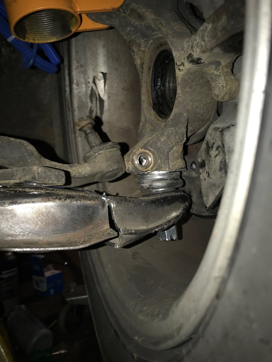

Or just bore the ball joint opening in the EA82 control arm for the EJ joint.
Also need EA81 tie rod ends (EA82 uses smaller stud in the knuckle than EA81 or EJ, and EJ ones are too long).

Honestly that’s not a bad idea.  Definatley giving me ideas!!! My initial plan was to cut the ball joint end off the EA arms and weld on a ej ball joint/ end of arm on.  (Cut at red line) The idea was to plot my cuts so I could add 3/4” of an inch or so to account for the longer axle lengths and to match the rear, since the arms have to be extended anyway why add a piece and have to weld twice vs. just adding the EJ end and welding once to join them.
But this is just ideas..
Thanks for the info on the tie rods.  I knew the ea82 ones wouldn’t work. But I’ll have a look into the ea81 tie rods and see if they are a better suit.  The ej ones compared arnt that much longer.  And considering I’m going to extend the control arms out a little with that much thread left on the inner tie rod, I think it will be ok.  One way to find out!
Yea, if you're extending the arms, you'll probably be fine. The length is very similar, if not identical. BUT, the tab coming off the knuckle for the tie rod end is angled differently on an EJ knuckle than EA82/XT6. So with XT6 knuckles, you can just use XT6/EJ rod ends. But with EJ ones, you need shorter rod ends. This changes the geometry a bit, and gives the car a bit more Akermann angle.

There is no reason, besides aesthetics, that the F/R track needs to be the same width.  Aerodynamics will suffer a bit, but outside of that it won't really change too much.
Leaving one track different to the other would seem like a half arsed effort, and I’ve not seen any factory Subarus look like the Citroën from back in the day.
Isn’t there a handling issue with the front track less than the rear?

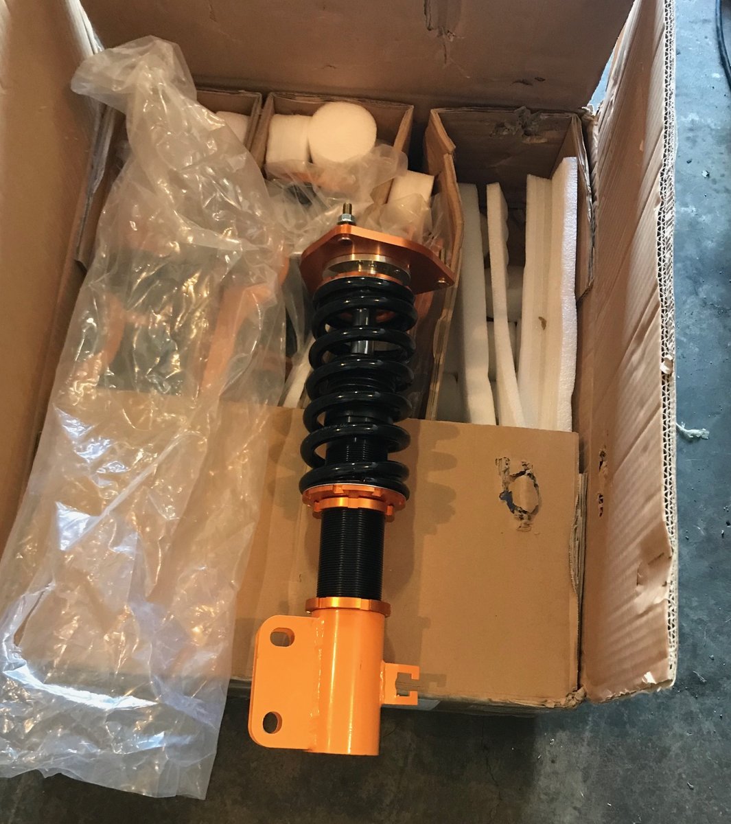

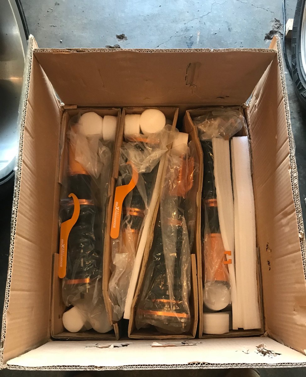

Delivery today!
Super super cheap coilover suspension finally showed up! And when I mean cheap I mean cheap! I snagged the whole set for $180 shipped to my door!
Honestly I won’t drive this car enough to be afraid of it failing if it even does, I’ve got more than enough to choose from so going cheap for this one scares me no bit!
Besides that I went a different route than “Suberdave” he used 4th Gen legacy suspension and re drilled and welded the top hats. I chose the 3rd gen legacy suspension as the top hats are almost identically sized to older gen strut setups.  Granted I have to open the holes a little and the camber adjustment I’m never goin to use is pointing the wrong way.... but hey. No welding lol. The rear suspension is the same as the 4th Gen legacy so mods will be similar to his to make them work!
  • Like 2

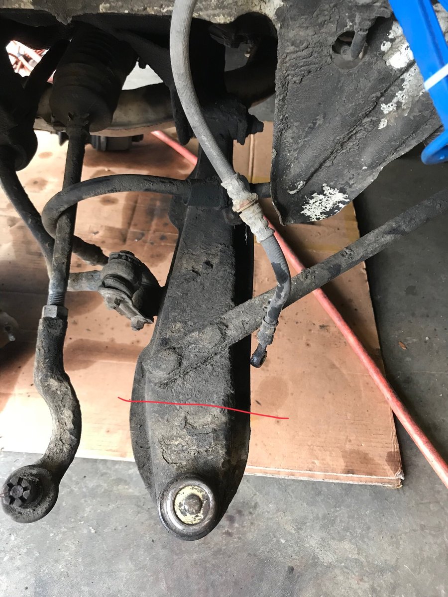

So here’s the plan for the front...
I snagged some front control arm ends off an impreza and the plan is to plot the cuts so I only have to weld once with the track width extension. I will be gusseting ofcourse for extra strength.  Also with this I have no worries of the ball joint angle being wrong on the EA arms if I was to bore them out etc.
On ‎1‎/‎28‎/‎2019 at 9:55 AM, carfreak85 said:
Cheap coilovers make me sad.  Modifying control arms without doing geometry modeling first also hurts my heart...
Completely understandable, but have to proof the product first before you go all in. Just how I run things. Upgrades to better quality products can always be done!
Geometry modeling would be awesome, I'd love to do that. But considering budget constraints the number of vehicles I have on hand which are far superior imo, I'm just not going that deep. Gotta pave the way and start somewhere my friend! Think of how far suspension modding has come with the s13/14 chassis with just  back woods country techniques.

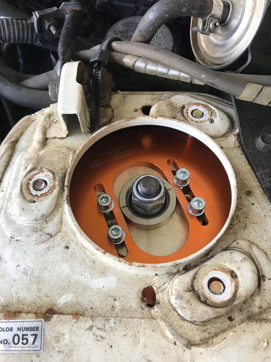

I was hoping you would have liked the 3rd gen legacy top hat discovery considering everyone else redrills and welds lol

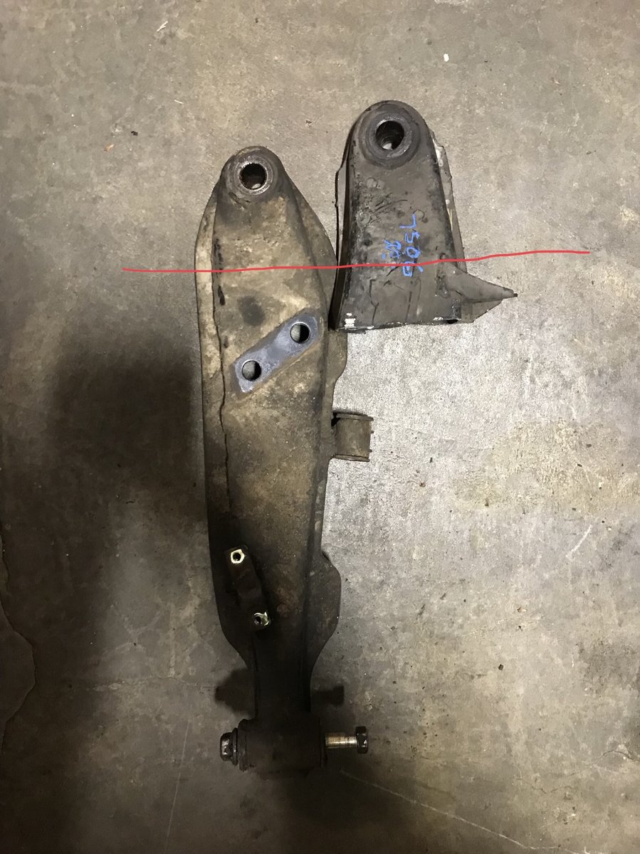

 1/29/19: Working With Angles
Plotting ball joint angles with the EJ extended portion of the control arm. This is just an early proof of concept and not the final product, I'm a few steps ahead of this point already but as it stands ive added 1" in control arm length. Angle was tested with the suspension loaded as shown, personally I don't think I will run the car this low maybe an inch or two higher but you get the idea! future plans are build new control arms from tube and replace the bushing  portion with a hiem joint as well as split the transverse link, thread both ends and add an adjustment sleeve.
I love the 3rd gen Lego top hat discovery, but the other side of the coin is that you get minimal camber adjustment due to the incorrect orientation...  I'd prefer to drill some new holes versus giving up the adjustment.
I assumed you were just modifying the OEM control arms and were going to leave it at that.  I have no problem with tubular control arms (which is what you meant when you brought up the Nissan S-chassis).  Got it, up to speed now, carry on.
yeah I think I'm going to make new top hats with correct orientation. even if I was to weld and re-drill holes I could not rotate the top hat in the correct orientation with out further modification aka. opening a can of worms, I did look into it though but there's just not a whole lot of room for play in that tower in stock form. But for anyone trying to use Stock Stuts/ lifted or solid top hat coilovers your good to go!!
