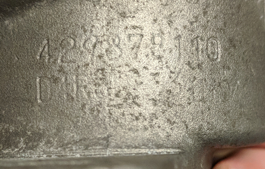

Part numbers stamped in the outside of the dist body
How about quote these?
Are they the same numbers to begin with?
Edited by jono
@jono: not sure what you mean here... but here's the side of the disty, tough to read...

Picture not always worth a thousand words! Can't decipher photo. I guess I was getting at if you come up with legible part numbers first to compare yourself, others might identify something odd by numbers of both dist and your new cap n rotor
