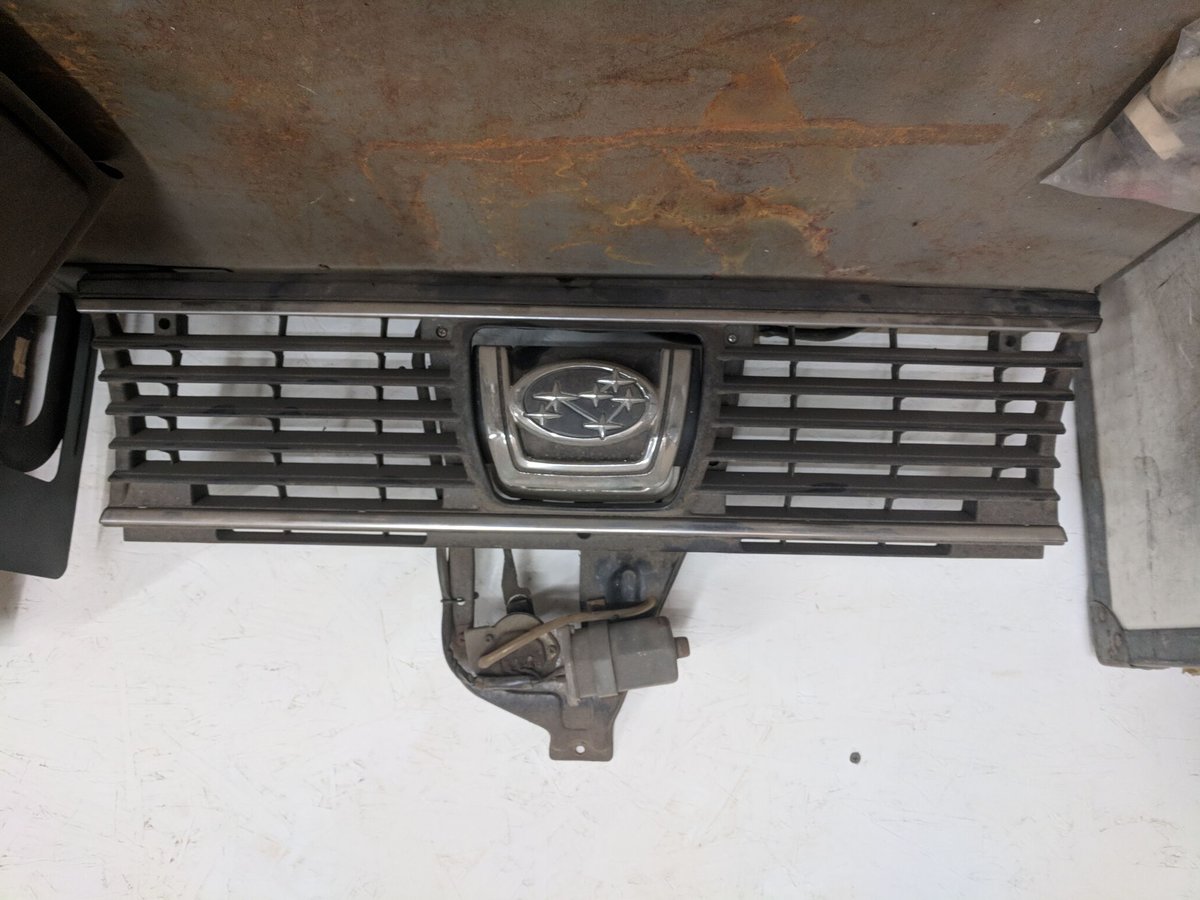

What does your original grill look like?  I have the honeycomb grill and if you carve out the center you can get it to fit the center lamp really well, it's already the correct shape.

What do you want for the original honeycomb grill with shipping to 10301? Thanks! I should mention I have the original untouched slatted grill, see attached of original 82 grille designed for cyclops (pic is upside down, lol).

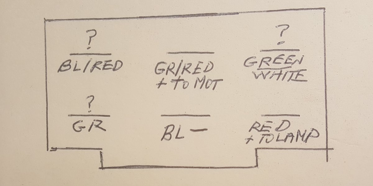

Chris, I just got the 8 pole relay and everything I need to start the hookup. I'm confused about three of the wires in the harness coming out of the cyclops, see attached and thanks!

Green and Green/White are 12v+ in to the rotary switch.  One for open, one for close.  when one of those wires sees 12v, it then passed through the rotary switch and on the motor to move the door.  when it rotates far enough, the switch opens, and power is no longer sent to the motor, so door stops.
Black/red is 12v out of the rotary switch in the door unit.........loop it directly back to the Green/Red for motor 12v+.  I think OE style it went out and looped through a lamp on the dash to tell you when the motor is moving.  But that isn't necessary, so my diagrahms just show it looped back to the Bl/red.
I would ditch the 8 pole relay.  Not needed and hard to source a replacement if needed.  is it even a 12v or is it 120v AC relay?
Anyway, 1 or 2,  87A relays would be enough.  1 is enough really for a simple setup like I show in first diagram.  The 87 and 87a pins make a convenient "either/or" for motor door open and close signals.

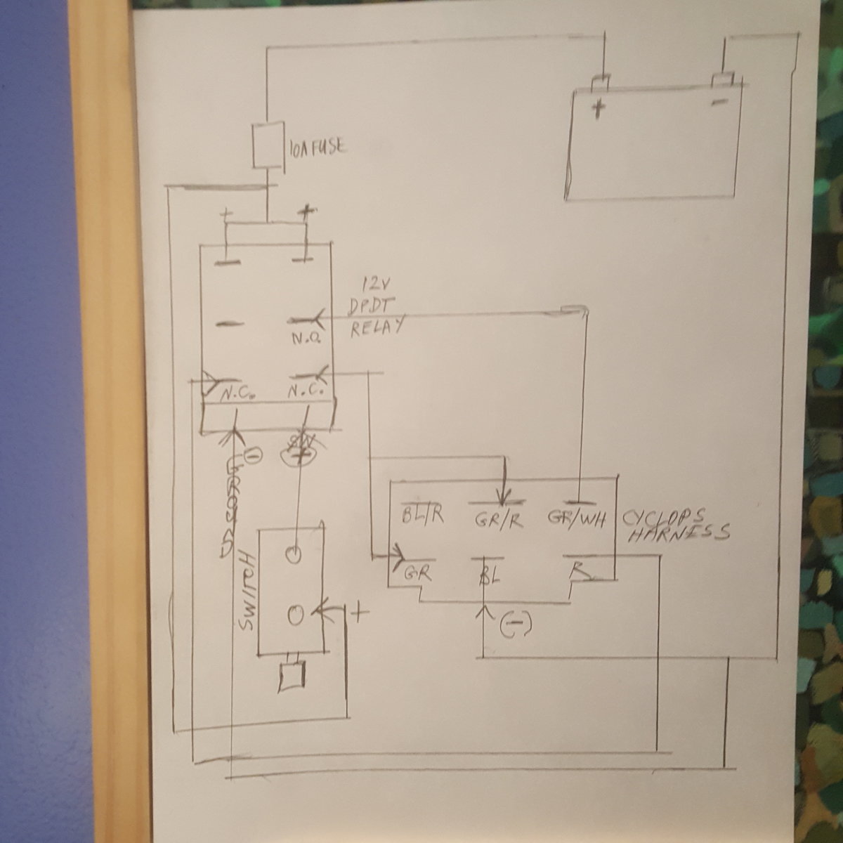

Here is my drawing of proposed wiring for Cyclops, 8 pole DPDT relay and original switch.
I made one mistake in the drawing, Black/red and Green/red wires in the harness are looped together.
Please check over and let me know if all is correct. Thanks a lot!

I think you mean 8 pin relay?.....  because a 2 pole double throw would need 8 pins, 2 for the coil, and 6 for the contacts.
I have been thinking wtf does such a simple thing need an 8 pole Double Throw relay for.  For a few days...   8 pole refers to a switch or relay with 8 seprate sets of contacts.  Double Throw refers to a common terminal, and a normally closed and a normally open contact.  Also, an 8 pole relay is not a common thing, it would be really pricy.
Share this post
Link to post
Share on other sites
Yes, two for the coil at the bottom and six contacts above it, one pair N.O., one pair N.C.,and 12v fed to top contacts. $12 for a pair of 'em with base disconnects in case it fails. And yes it is a 12v relay.

I finished the wiring job. When I powered up the relay the first time, the door opened and locked open, does that mean I have to reverse the green and green white wires? Thanks for all the help!
Share this post
Link to post
Yes.  The "close" wire,  Green/white, should go to the normally closed, or 87a terminal.
Green wire should get power from 87 terminal when relay is activated by dash switch.
