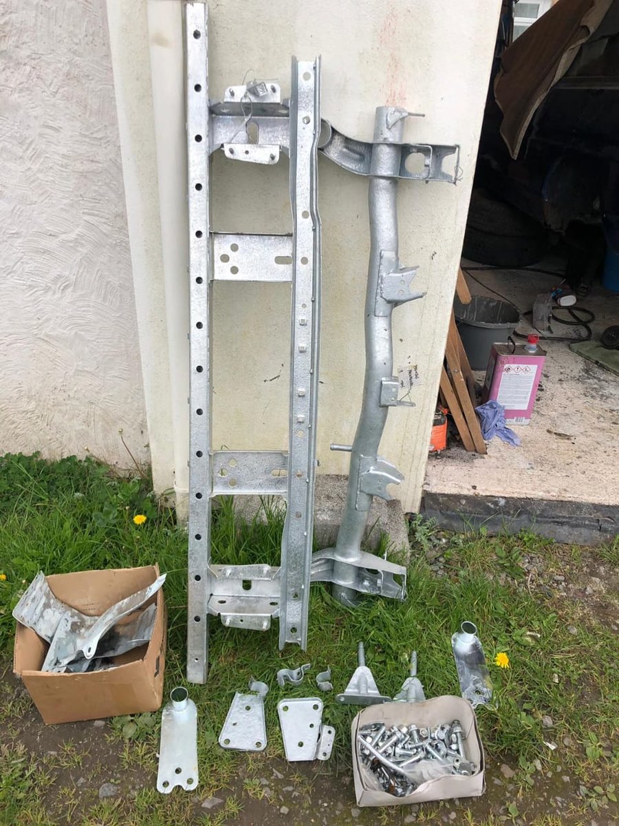

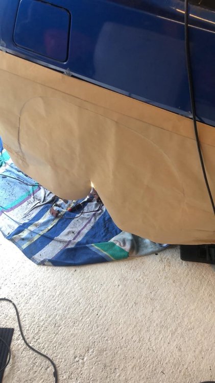

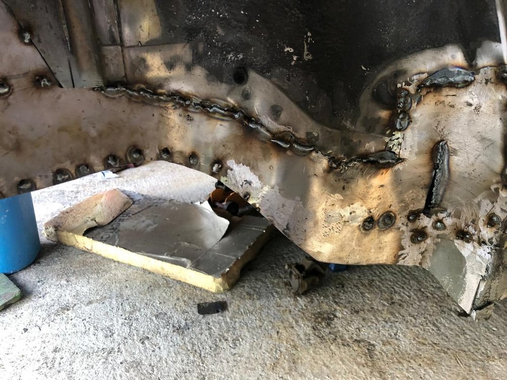

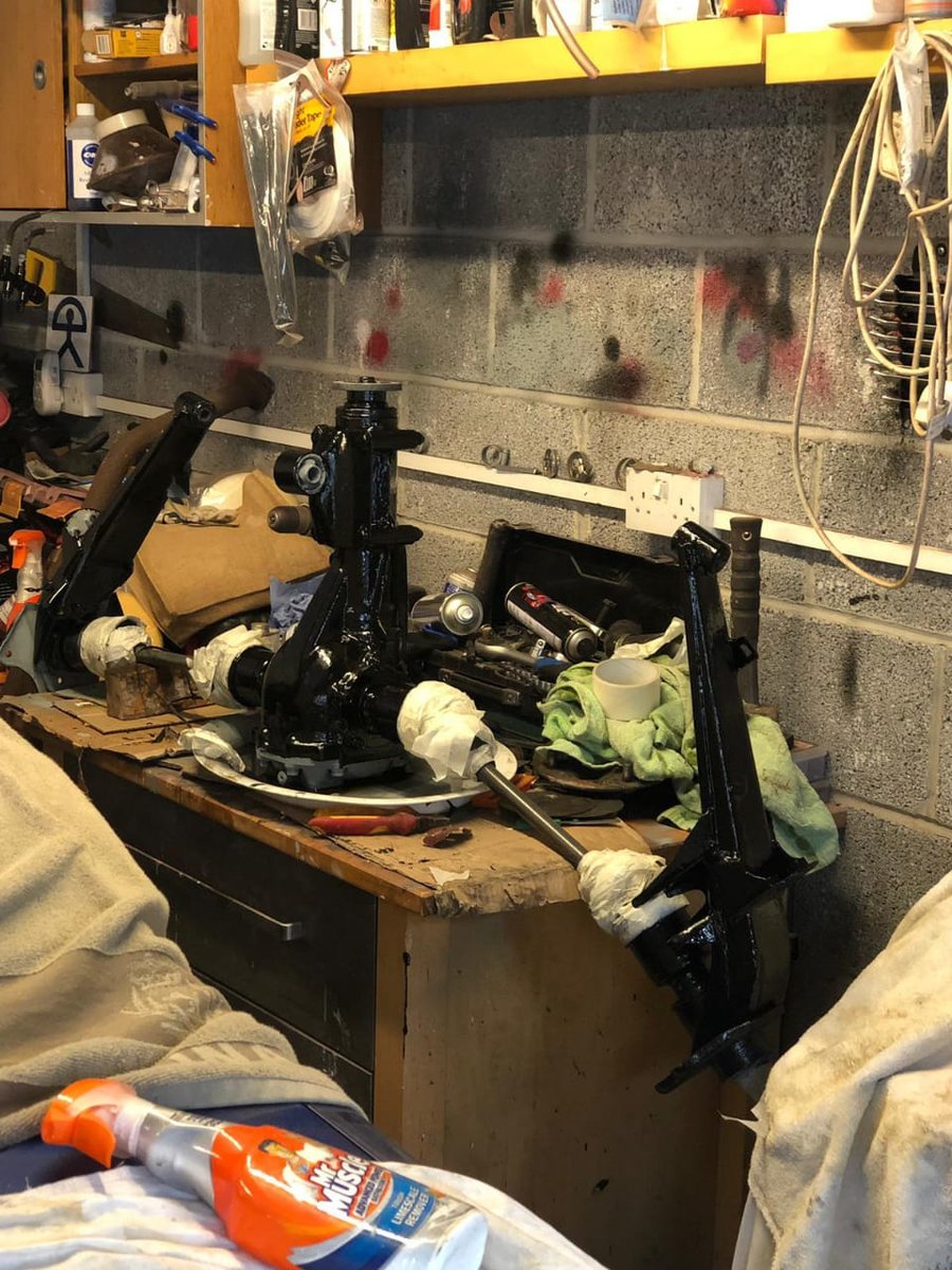

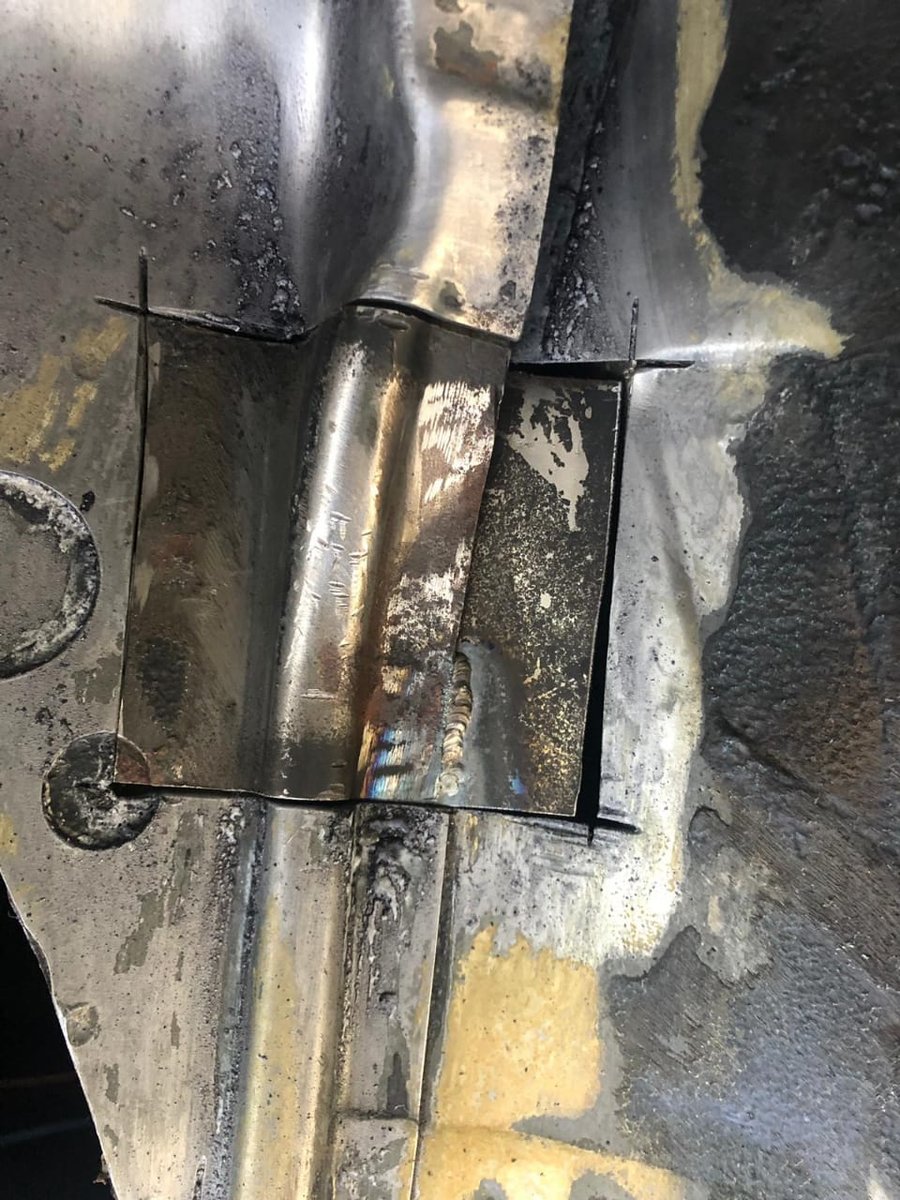

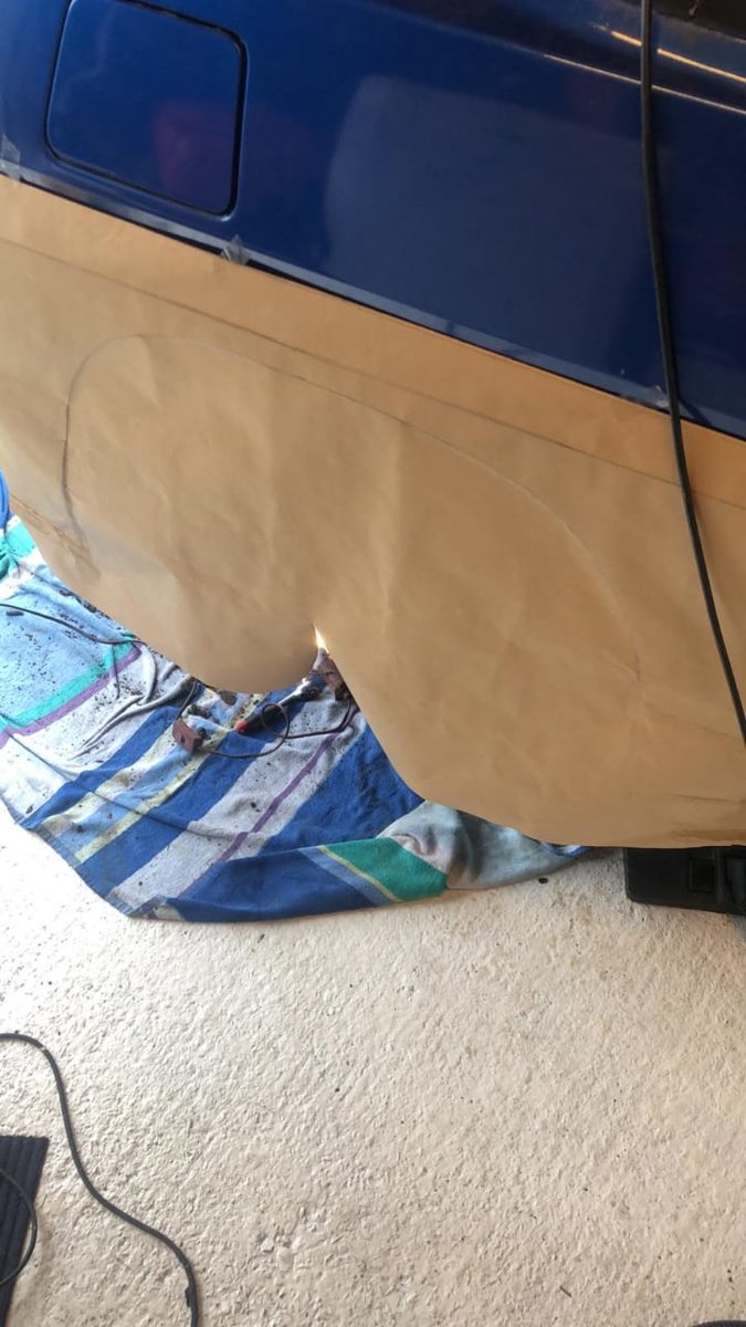

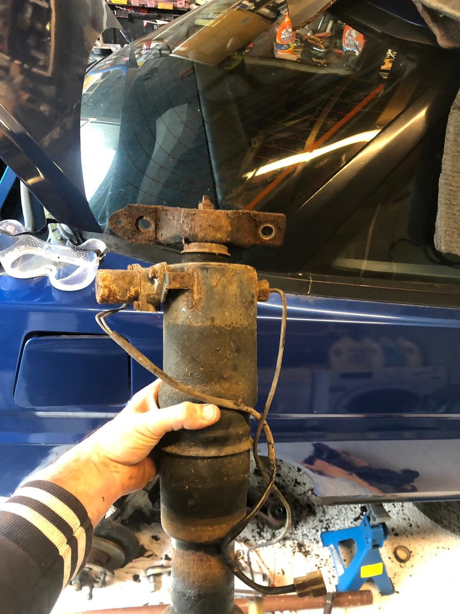

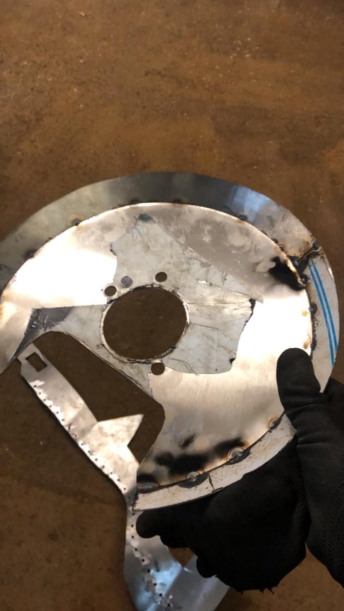

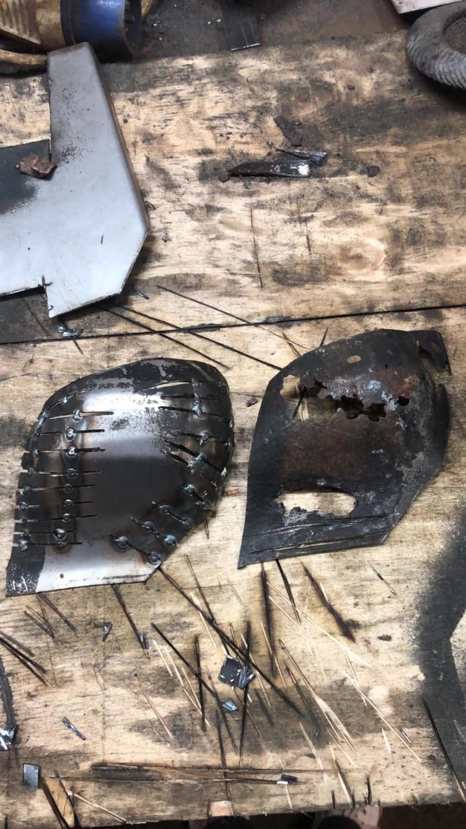

Giles Posted May 6, 2019 Author Share Posted May 6, 2019 These pics are a couple of weeks old. ive nearly finished the back structural work. i hope to have the back suspension back on by the end of the month. ideally with new air struts.. I already have most new bushes! I’m scouring the world looking for new rear struts the ones on the car are fine, but it’s only a matter of time... then i’ll Start the rear wheel arches. move onto the front then. which is in much better condition i bought 3 new old stock front struts . im delighted . all left hand side. But I’ll modify for right. Plus a spare to future proof the car. my welding is improving.. and my neighbours haven’t yet complained about the constant grinding! most nuts and bolts and things I can strip down have been electroplated or galvanised its wet here in Wales! Quote Link to comment Share on other sites More sharing options...

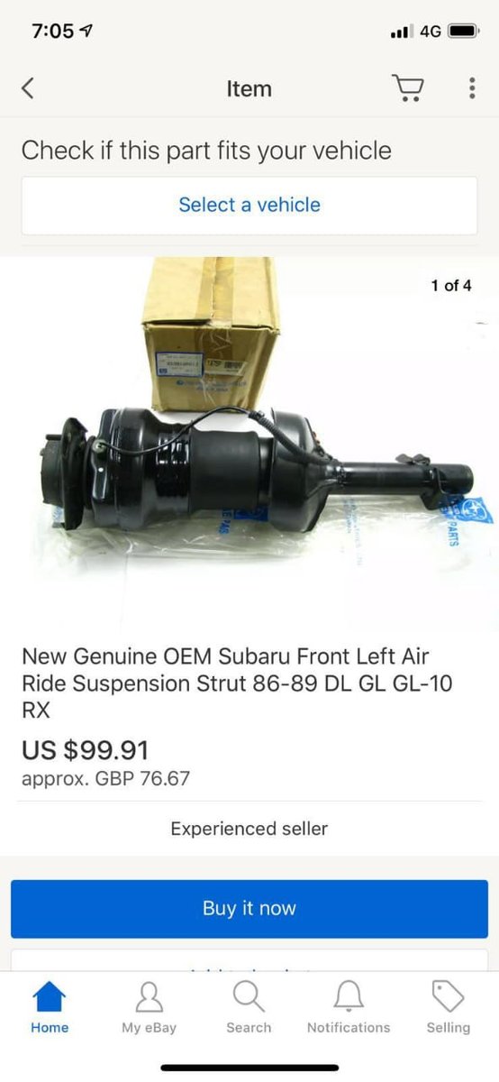

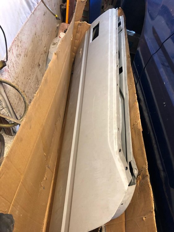

Giles Posted May 6, 2019 Author Share Posted May 6, 2019 I need mainly.. a pair of rear air struts (new) a front right hand side wing ( fender) i could repair the one I have. and that’s about it really. CAN ANYONE HELP with above? Rest I wanted I have , or is on its way. See brand new door ! Mine is okay.. but I couldn’t leave it go. Only £150 too Quote Link to comment Share on other sites More sharing options...

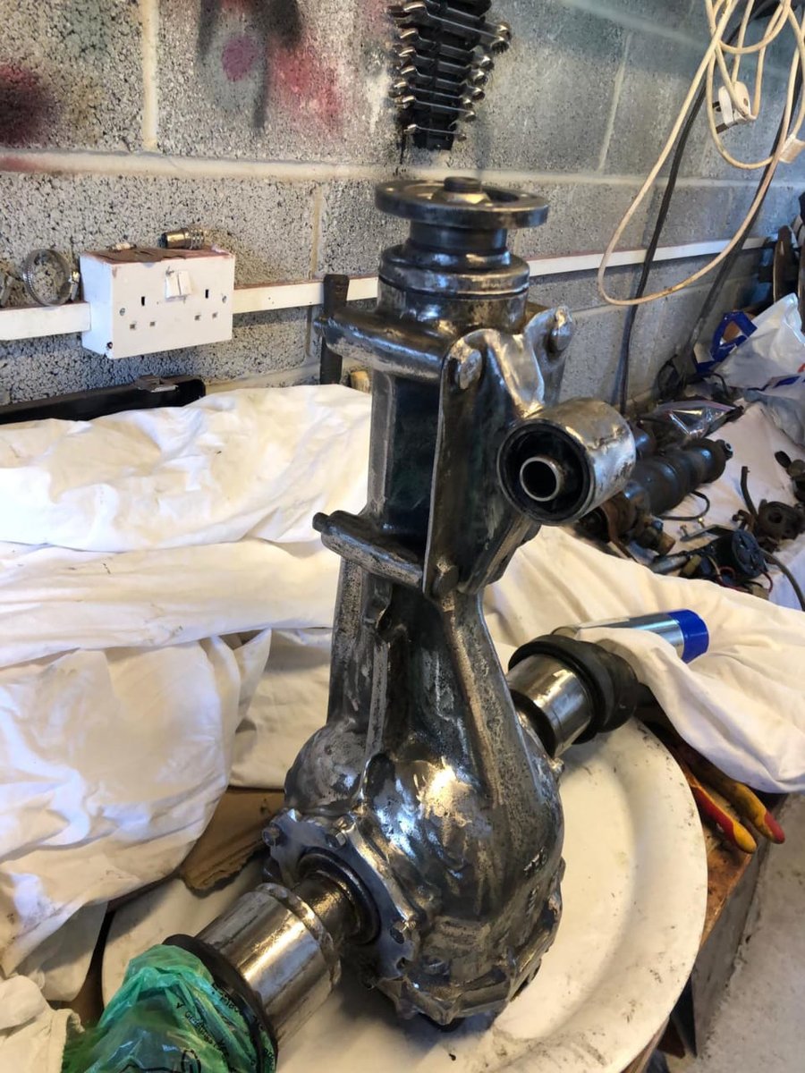

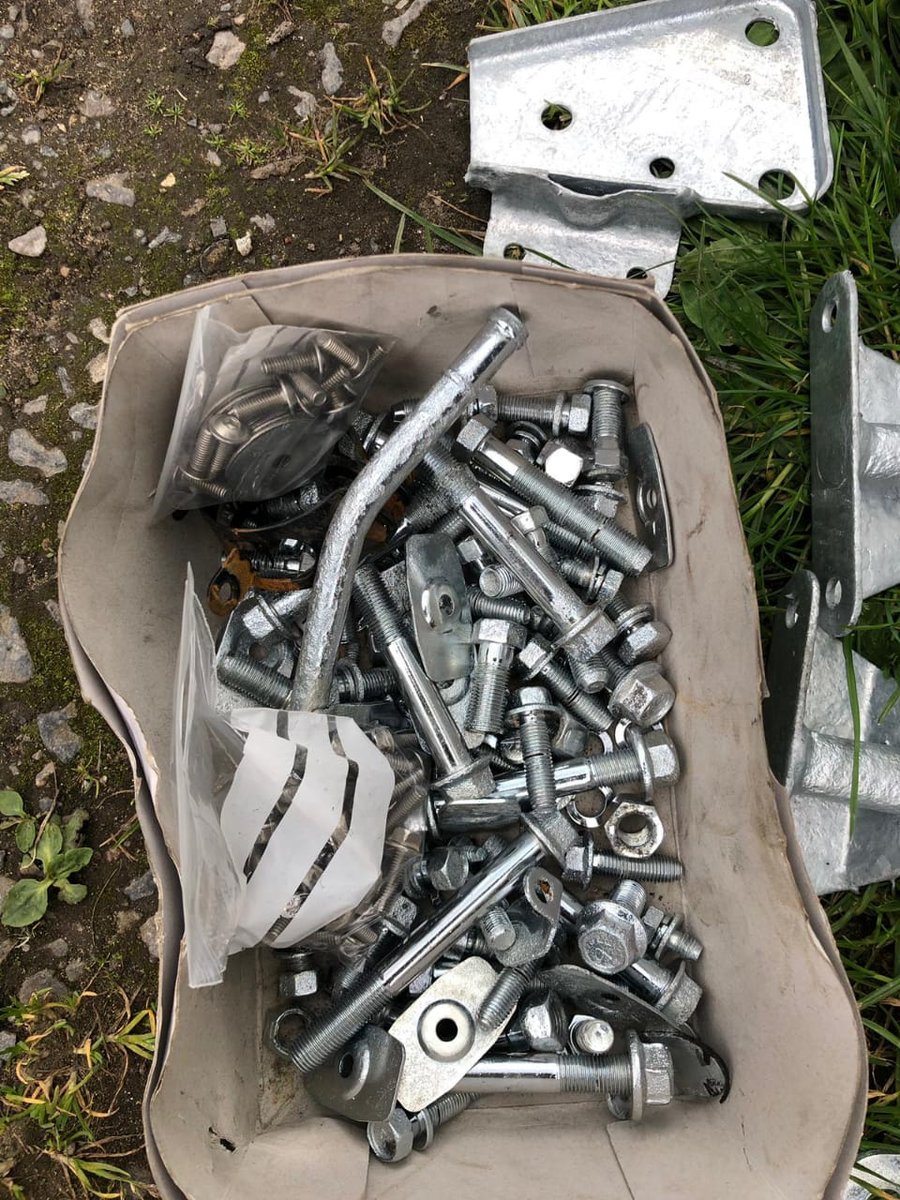

el_freddo Posted May 6, 2019 Share Posted May 6, 2019 There’s some awesome work in there Giles! Ive has trouble working out what some of the pics represent, like the square cut section, the new semi dome looking piece (I have no idea where that’s from), and what are the rail pieces with the galvanised bolts/plates/rear suspension frame? Keep up the good work! Cheers Bennie Quote Link to comment Share on other sites More sharing options...

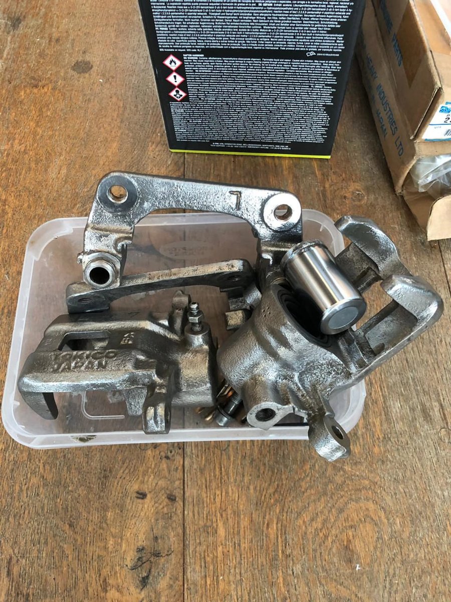

Giles Posted May 6, 2019 Author Share Posted May 6, 2019 Hi Bennie. the square cut section is one of the air strut supports inside rear wheel arch. the galvanised rail, is the rear bumper frame. ive learned over the years..... rather than struggle with cleaning separate pieces.. send them away for acid dipping and plating. Still remarkably cheap to. The round metal is new stainless steel rear brake disc ( rotor) covers. there is a pic of dismantled and cleaned rear brake callipers to. G. Quote Link to comment Share on other sites More sharing options...
78 brat Posted May 6, 2019 Share Posted May 6, 2019 Know this is a bit old. But I have 2 front and two rear that we're put into a scratch back project so have not been used. Bought them knew early 2000's. Have a whole rear end out of the car with two more bags ..a few compressors kicking around. I've got stuff. And xt I really don't have much use for Quote Link to comment Share on other sites More sharing options...
Giles Posted May 7, 2019 Author Share Posted May 7, 2019 78 Brat.... morning. you have nearly new air struts? rears..? did I read this correctly? you interested in selling them, if so? id be very grateful if you’d consider it. where are you, Maine. New England? G. Quote Link to comment Share on other sites More sharing options...
78 brat Posted May 7, 2019 Share Posted May 7, 2019 10 hours ago, Giles said: 78 Brat.... morning. you have nearly new air struts? rears..? did I read this correctly? you interested in selling them, if so? id be very grateful if you’d consider it. where are you, Maine. New England? G. Yes, unless someone stole them out of the box. I'll dig a bit more. They have to be around here, Jesus I hope they are. Other then that I have a bunch of new used fronts and looks like 4 rears Quote Link to comment Share on other sites More sharing options...
