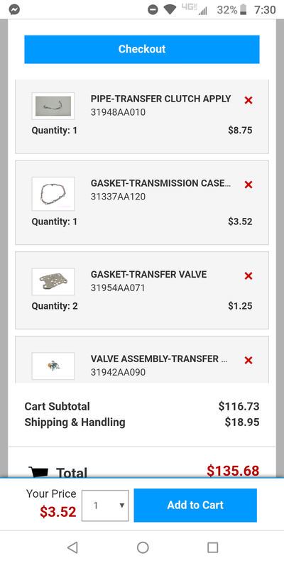

Anyways so I'm pretty sure it's the duty c solenoid is bad. My question is can i disconnect the back half of drive axle and use it as a fwd car would that fix it from wearing until i am able in month or two to work on the solenoid once it gets warmer or will this cause damage to the rear.
I'm ordering these for the job and will do it as soon as possible if the general consensus is I'll cause damage by removing half the drive shaft. It's just pretty cold out and i have no days off for the next while and i need to drive a vehicle.
