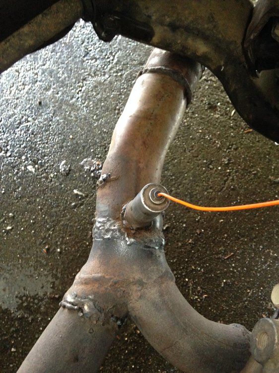

MonkeyWrencher Posted March 27, 2019 Author Share Posted March 27, 2019 Custom y-pipe from a Dodge 318, routing into an old cherry bomb Quote Link to comment Share on other sites More sharing options...

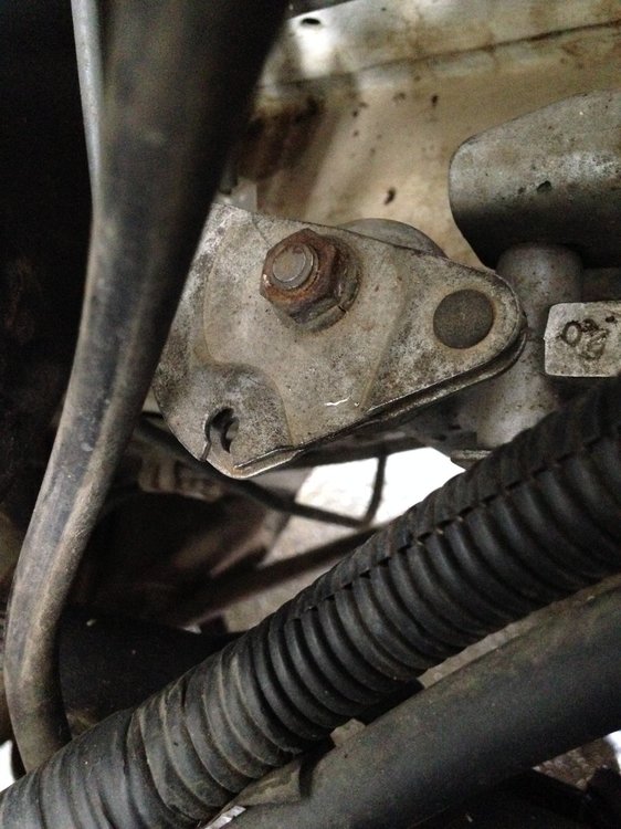

MonkeyWrencher Posted March 27, 2019 Author Share Posted March 27, 2019 As usual, the passenger side CV boot melted so I converted her to RWD! Quote Link to comment Share on other sites More sharing options...

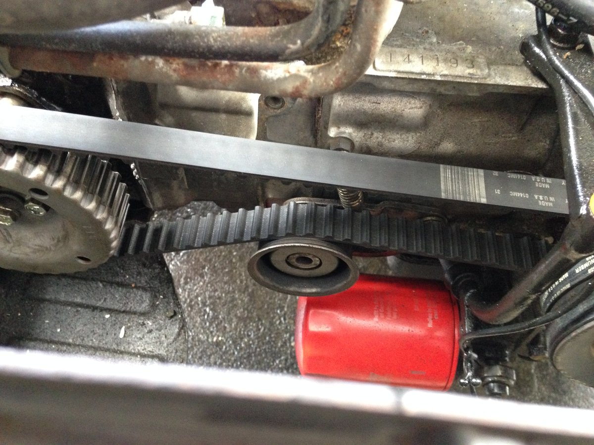

MonkeyWrencher Posted March 27, 2019 Author Share Posted March 27, 2019 Removed the timing belt cover Quote Link to comment Share on other sites More sharing options...

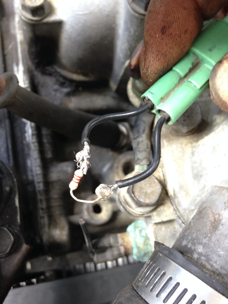

MonkeyWrencher Posted March 27, 2019 Author Share Posted March 27, 2019 Soldered a 750 ohm resister in place of the coolant temp sensor, auto parts store wanted 100 bucks for a replacement! Quote Link to comment Share on other sites More sharing options...

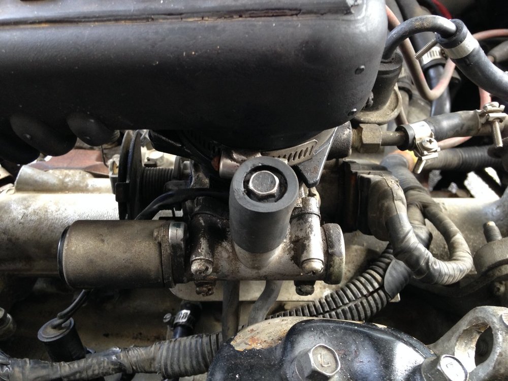

MonkeyWrencher Posted March 27, 2019 Author Share Posted March 27, 2019 Deleted the idle air control, cleaning it didn't fix it so out came the side-cutters! Throttle response is MUCH snappier hehe Quote Link to comment Share on other sites More sharing options...

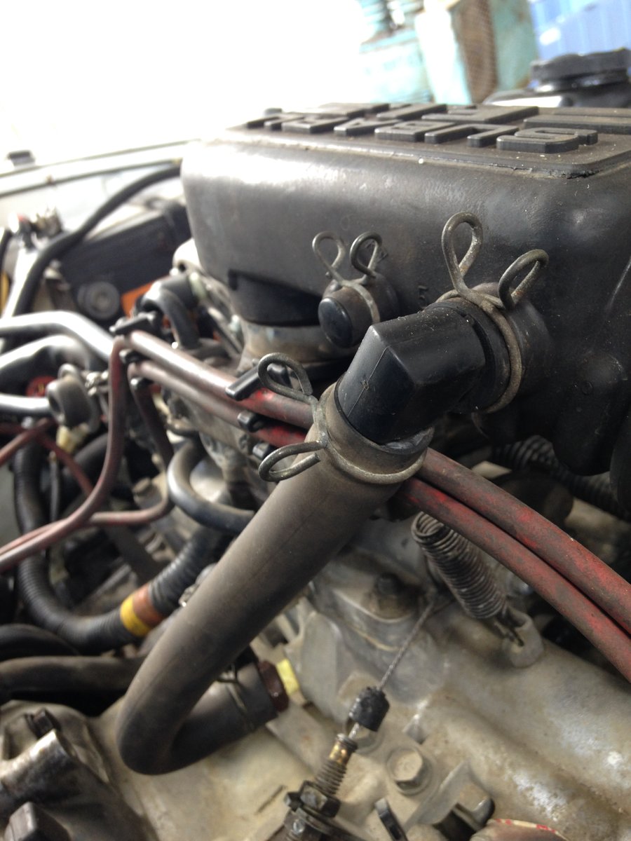

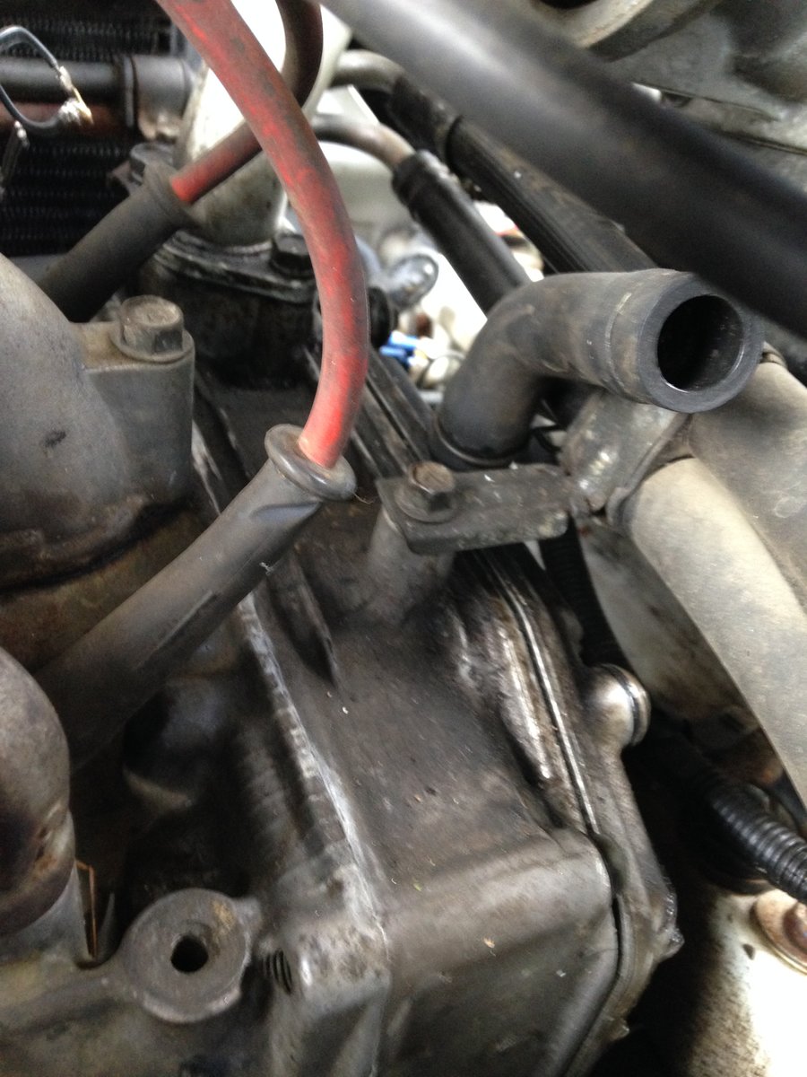

MonkeyWrencher Posted March 27, 2019 Author Share Posted March 27, 2019 She burned oil like crazy when turning right so I deleted the pcv, both valve covers vent into the atmosphere. Quote Link to comment Share on other sites More sharing options...

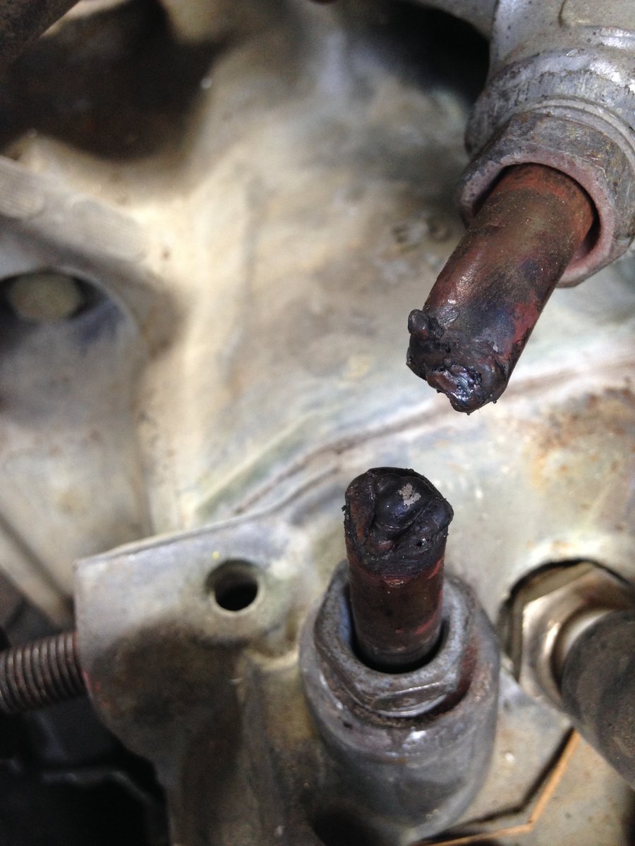

MonkeyWrencher Posted March 27, 2019 Author Share Posted March 27, 2019 Deleted the anti backfire valve, but kept the vacuum line for 4wd engagement and heater control. Quote Link to comment Share on other sites More sharing options...

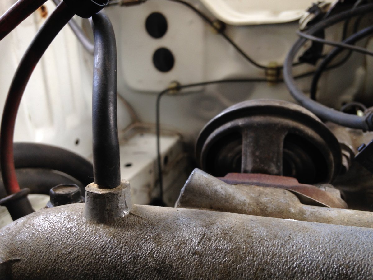

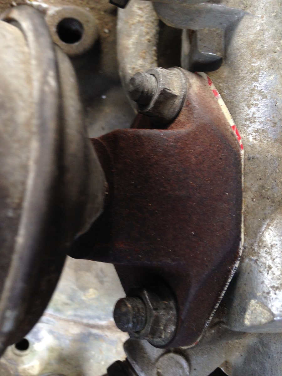

MonkeyWrencher Posted March 27, 2019 Author Share Posted March 27, 2019 Redneck beer can cover for the EGR Quote Link to comment Share on other sites More sharing options...
MonkeyWrencher Posted March 27, 2019 Author Share Posted March 27, 2019 Plus I welded the transfer port that goes from cylinder head to egr, just because! Quote Link to comment Share on other sites More sharing options...

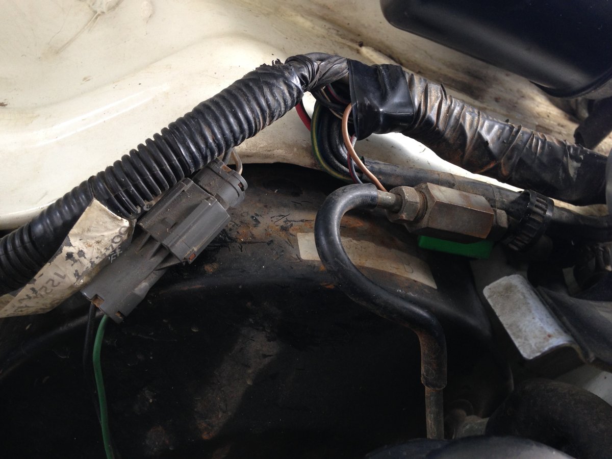

MonkeyWrencher Posted March 27, 2019 Author Share Posted March 27, 2019 Cut out all the unnecessary wiring harness that was hanging from the firewall, kept the green test connectors tho. Quote Link to comment Share on other sites More sharing options...

FerGloyale Posted March 27, 2019 Share Posted March 27, 2019 (edited) 1 hour ago, MonkeyWrencher said: Because I'm also a Nissan freak and like 'different' builds! Also the KA is a stout motor and easily available. And way too tall and heavy to fit in the loyale. MAYBE if you used an entire Nissan front suspension. Maybe. Will NOT fit in the loyale with it's stock crossmember/suspension. Doesn't matter because obvious by the Redneckeery goin on in this thread, you will never swap in anything. Great job F-in up a car that's lasted in really nice condition for years. EGR lowers cyl temperatures. If you understood it, you'd have known it wasn't necessary to weld the intake side of that pipe if you've blocked off the port with the beer can. PCV removes corrosive gasses from the engine oil Hillholders are awesome. Only annoying to those who can't figure out how to use them. Coolant Temp sensor is possibly one of the MOST important sensor to making the car run right. You left the D-check connectors, but cut out the white, U-check connector that ACTUALLY IS THE PAIR THAT OUTPUTS STORED CODES!!! And now you won't be able to use the "clear memory" either. That requires BOTH sets of connectors. The 4wd transfer cannot handle 90hp in RWD for long, let alone 200hp. Guaranty you break it within 3 months. Especially if yer trying to "drift" That car will not start in the winter. It will probably be ruined by then anyhow. Oh wait, never mind, it's already ruined. But it's yer car so "tweek" on it all you want. Edited March 27, 2019 by FerGloyale 3 1 Quote Link to comment Share on other sites More sharing options...

MonkeyWrencher Posted March 28, 2019 Author Share Posted March 28, 2019 13 hours ago, FerGloyale said: And way too tall and heavy to fit in the loyale. MAYBE if you used an entire Nissan front suspension. Maybe. Will NOT fit in the loyale with it's stock crossmember/suspension. Doesn't matter because obvious by the Redneckeery goin on in this thread, you will never swap in anything. Great job F-in up a car that's lasted in really nice condition for years. EGR lowers cyl temperatures. If you understood it, you'd have known it wasn't necessary to weld the intake side of that pipe if you've blocked off the port with the beer can. PCV removes corrosive gasses from the engine oil Hillholders are awesome. Only annoying to those who can't figure out how to use them. Coolant Temp sensor is possibly one of the MOST important sensor to making the car run right. You left the D-check connectors, but cut out the white, U-check connector that ACTUALLY IS THE PAIR THAT OUTPUTS STORED CODES!!! And now you won't be able to use the "clear memory" either. That requires BOTH sets of connectors. The 4wd transfer cannot handle 90hp in RWD for long, let alone 200hp. Guaranty you break it within 3 months. Especially if yer trying to "drift" That car will not start in the winter. It will probably be ruined by then anyhow. Oh wait, never mind, it's already ruined. But it's yer car so "tweek" on it all you want. I didn't f up anything, it's a 250$ car let be honest. If you heard or seen how she ran when I first got her you'd understand why I deleted all the bogus iac/egr/pcv that was choking it out! I put thousands of km's on ALL of my ea82's that had the delete done and never once had a single issue! That resister makes the tires chirp into 3 when shifting WOT. Why spend big bucks on simple spoob. Quote Link to comment Share on other sites More sharing options...
