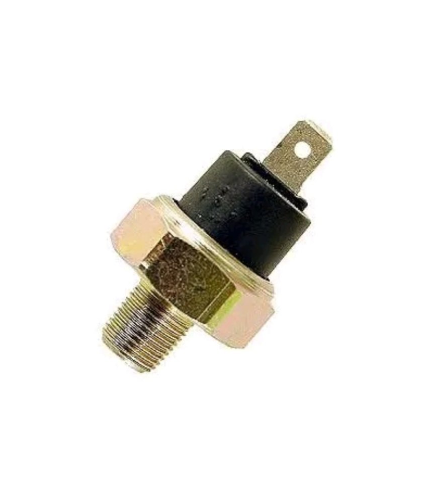

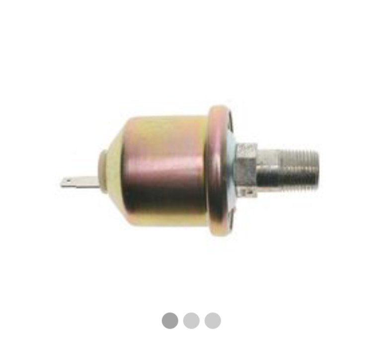

Hello.
Is the front of engine dirty with oil too? If so it couls be the front main oil seal. I have a EA81 that leaked from front and back mail seals. Also check the oil pressure sensor its located by the bottom kinda hidden by crankshaft pulley. Now ive dealt with two types of EA81's. The oil pressures censors can be different depending on model of subaru for example the model with just the low oil indicator light on dash will have a smaller oil pressures sesor vs the one with the actual pressure gauge on dash. That one has a bigger pressure sensor with a floater in it. This bigger version of sensor was broken and was dumping oil like no ones business. This is were i found my leaks come from. Here you will find the two different oil pressure sensors. If you have the oil gauge on dash then it could be possible the sensor is broken or loose.

I actually have both oil sensors.  Car came with a gauge sensor attached to the single light indicator.  Bought a small sensor type like you have a picture of and installed that.
